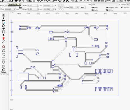

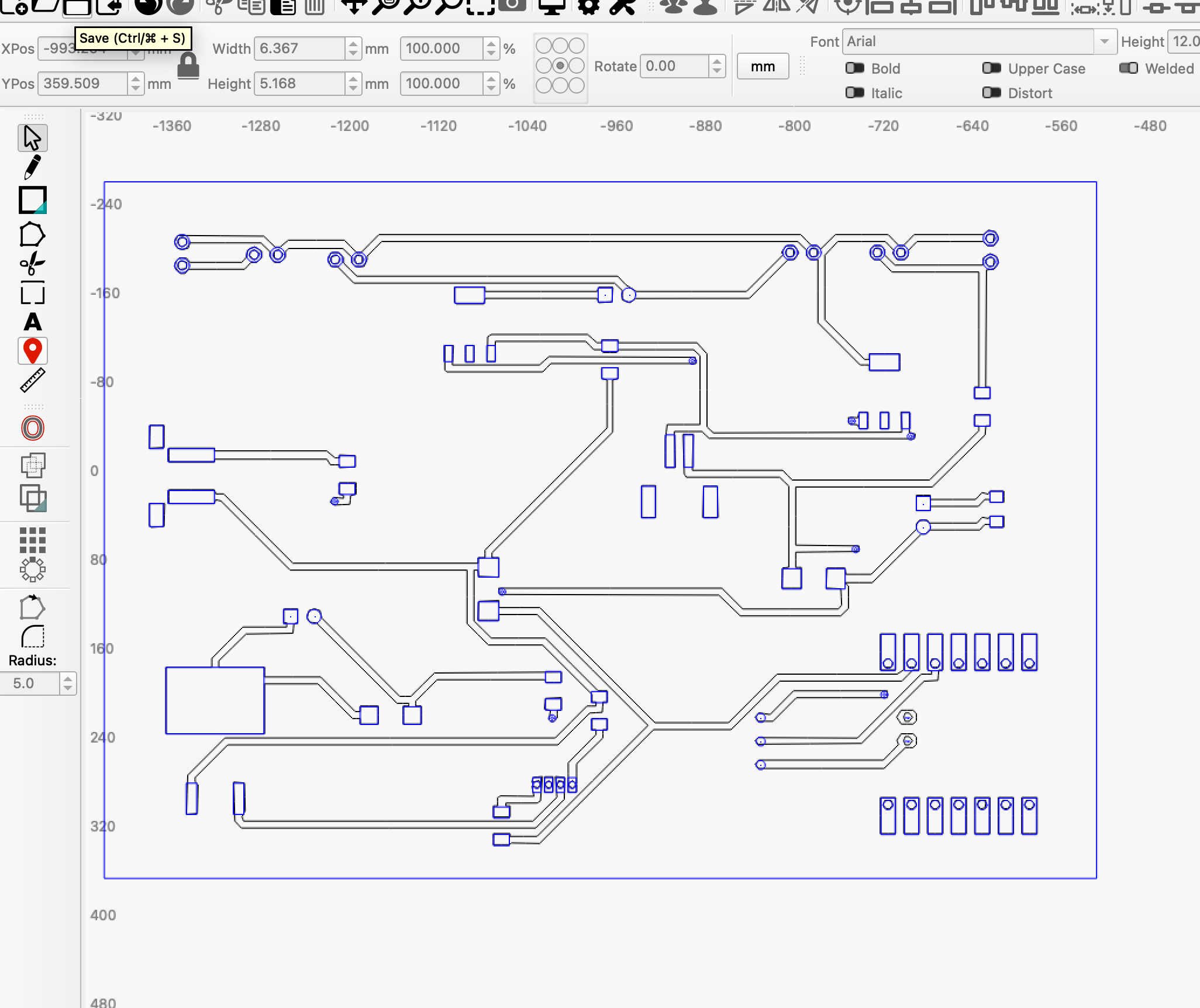

Hello,
I am new to Lightburn and trying to etch my first PCB, I have the image as a SVG and it shows perfect in other software but does not show the copper traces that are in the image it only shows the pads. I’m sure it’s something I am overlooking but I have tried different ways to import this and different file formats, but I cannot seem to find the right combination. Any help is appreciated.

There is some setting in inkscape that doesn’t fit, but I can’t find it. (There are some users here who are experts in inkscape, they will probably come up with a simple explanation :wink: )
The only thing I can manage is to trace the copy in LB, but that is not the point of your projects, more of an intermediate solution when nothing else is available. However, it requires a lot of manual work to be precise.
The best solution would be to find the settings in inkscape that make all elements/layers expotable.
If you’re designing with Kicad, this is a known problem due to the way Kicad creates the SVG file.

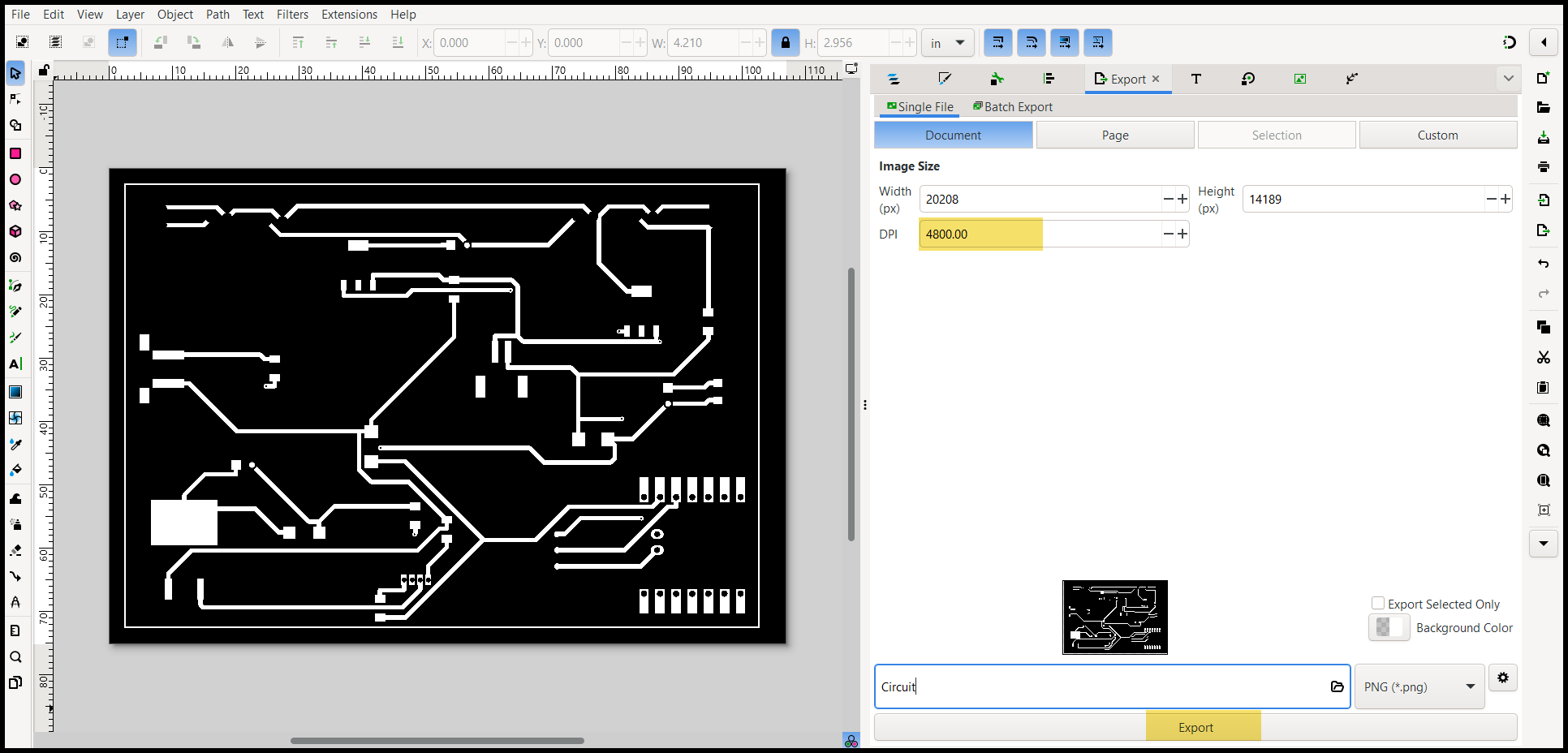

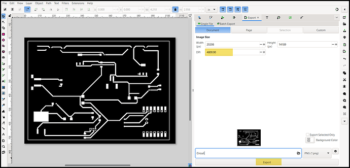

I’d try tracing the PNG export, assuming they will produce the file with at least 300 DPI resolution. If you can get a higher resolution, that will improve the accuracy of smaller features.

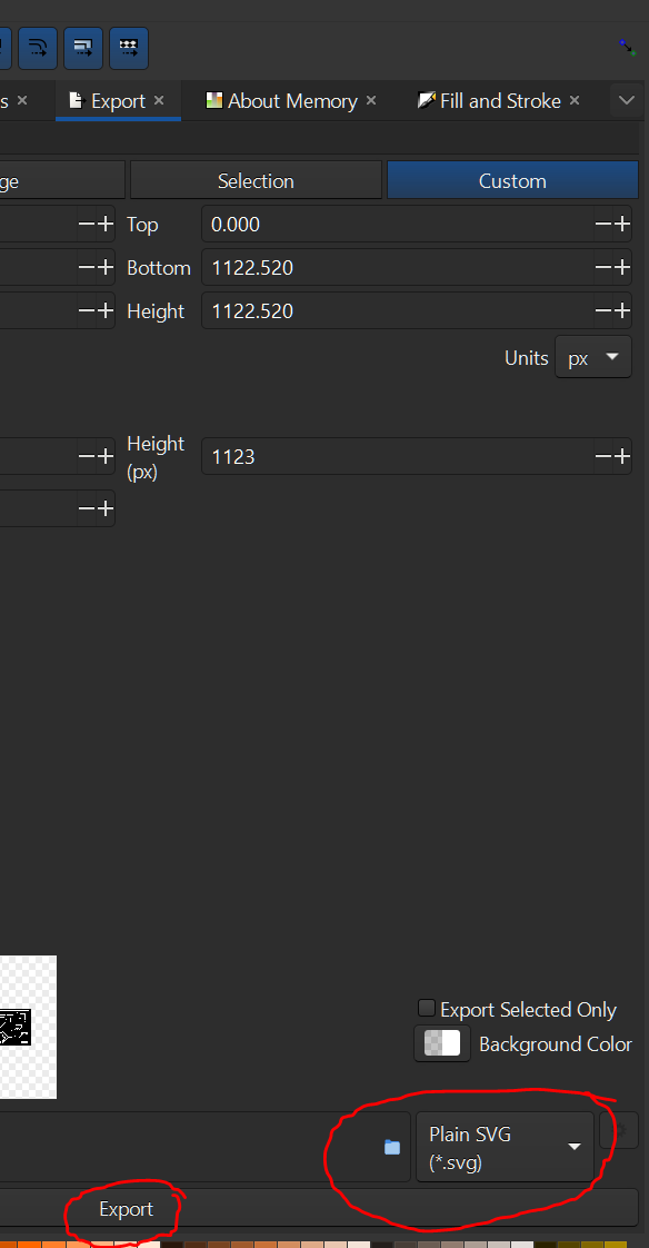

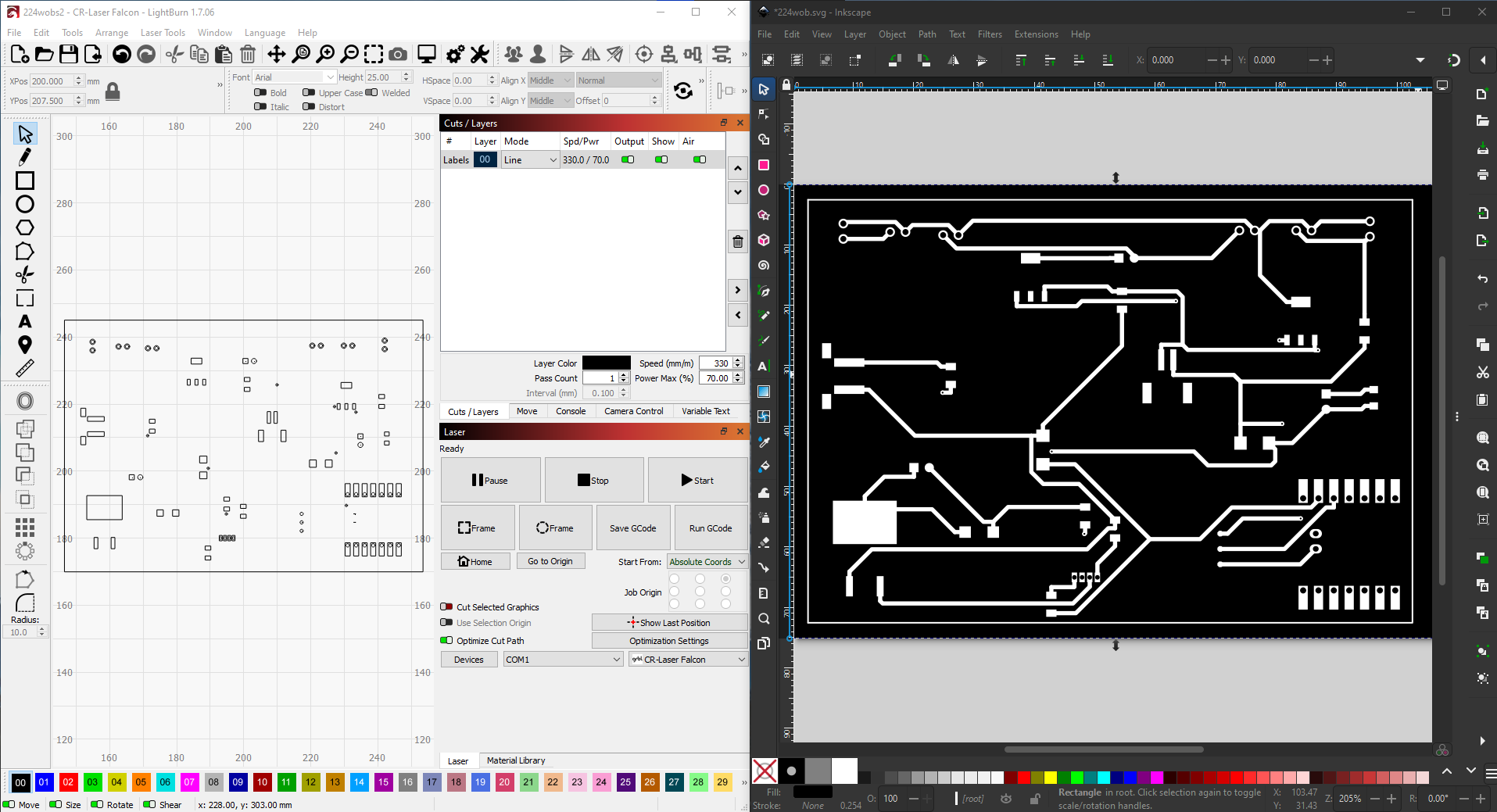

In Inkscape if you select All ( Ctrl + A ) with your svg then Stroke to Path:
After Export as Plain SVG:

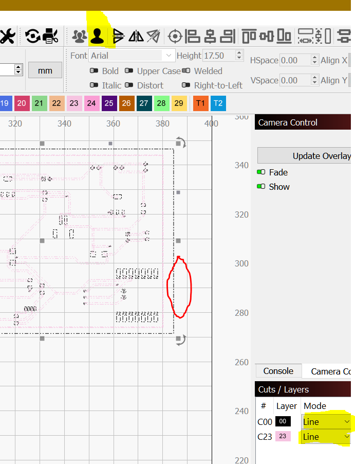

Drag the file into Lightburn:

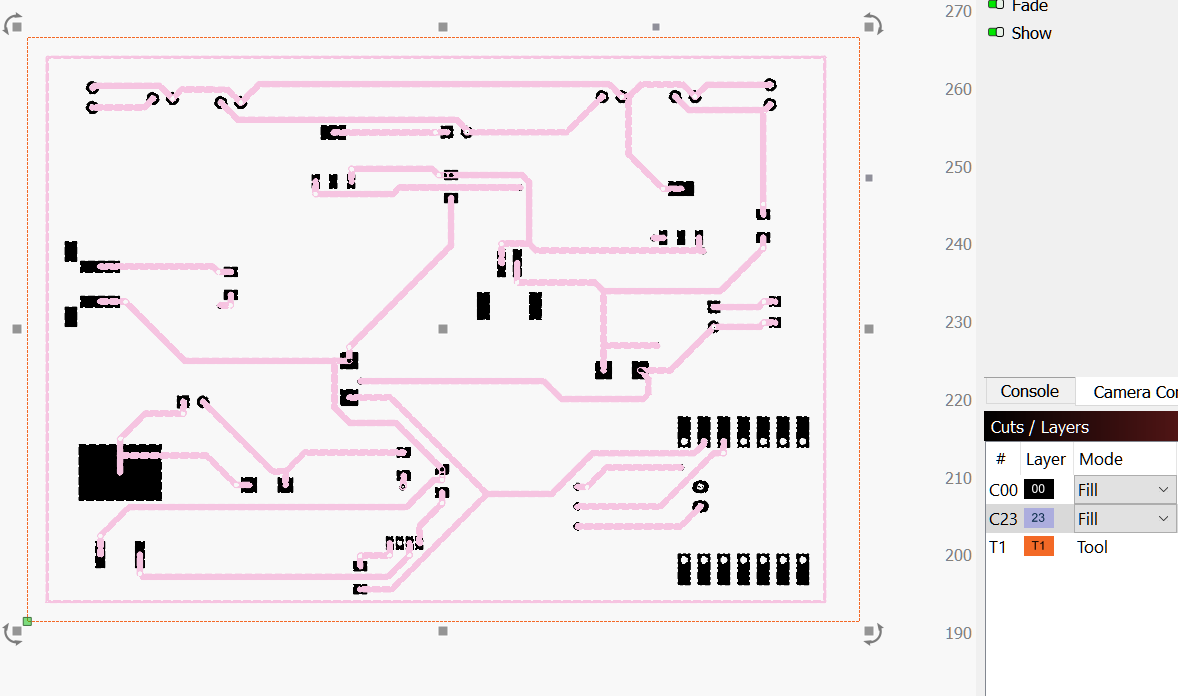

Ungroup, select only the outline and set to a T1 or T2 Cut/layer.
Set C00 and C23 to Fill mode.
Then you can edit the shapes.
Example:
You can set everything to the same Cut/Layer but T1 and you need to design the tracks to connect to the pads outside to avoid a lot of editing.
Is this what you are looking for?
Circuit.lbrn2 (78.9 KB)

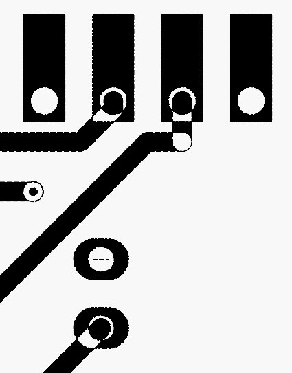

I have access to a program called Cuttle, that imports SVG, and has a flatten command that works well.

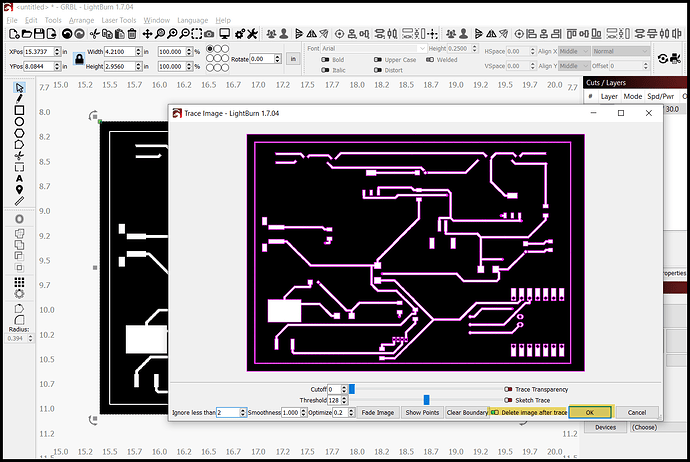

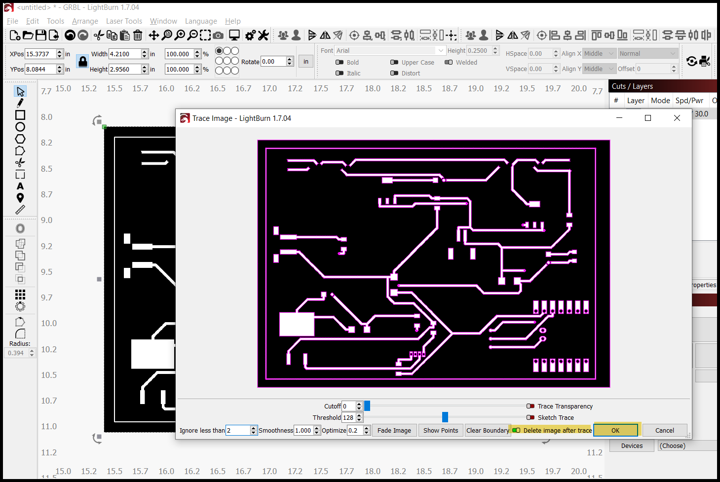

For yourself, the easiest would be to export a high res PNG file from Inkscape, import the PNG into Lightburn, and Tools>Trace Image. If you start with a high res PNG, Lightburn does a good job of tracing it.

Which is why the least-awful way to convert that geometry into something laserable is to get picture of the whole thing as a PNG, then either raster-scan as an image or trace to get the vector edges.
The backstory:
I still had to change the white perimeter in Inkscape to “stroke to path”. And, there were 2 white circles that I changed in Inkscape to “object to path”. Then Cuttle was able to flatten it correctly. I would still recommend exporting a hi-res PNG out of Inkscape, and tracing in Lightburn. For what you are doing, it will be accurate enough.
