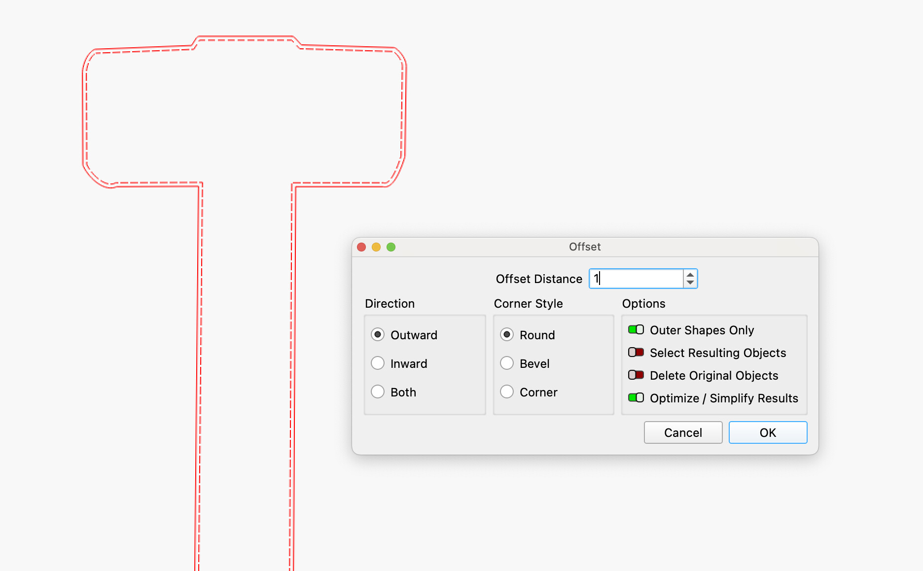

Use the OFFSET tool.
As James says, the offset function is part of the process that should give you the desired result.

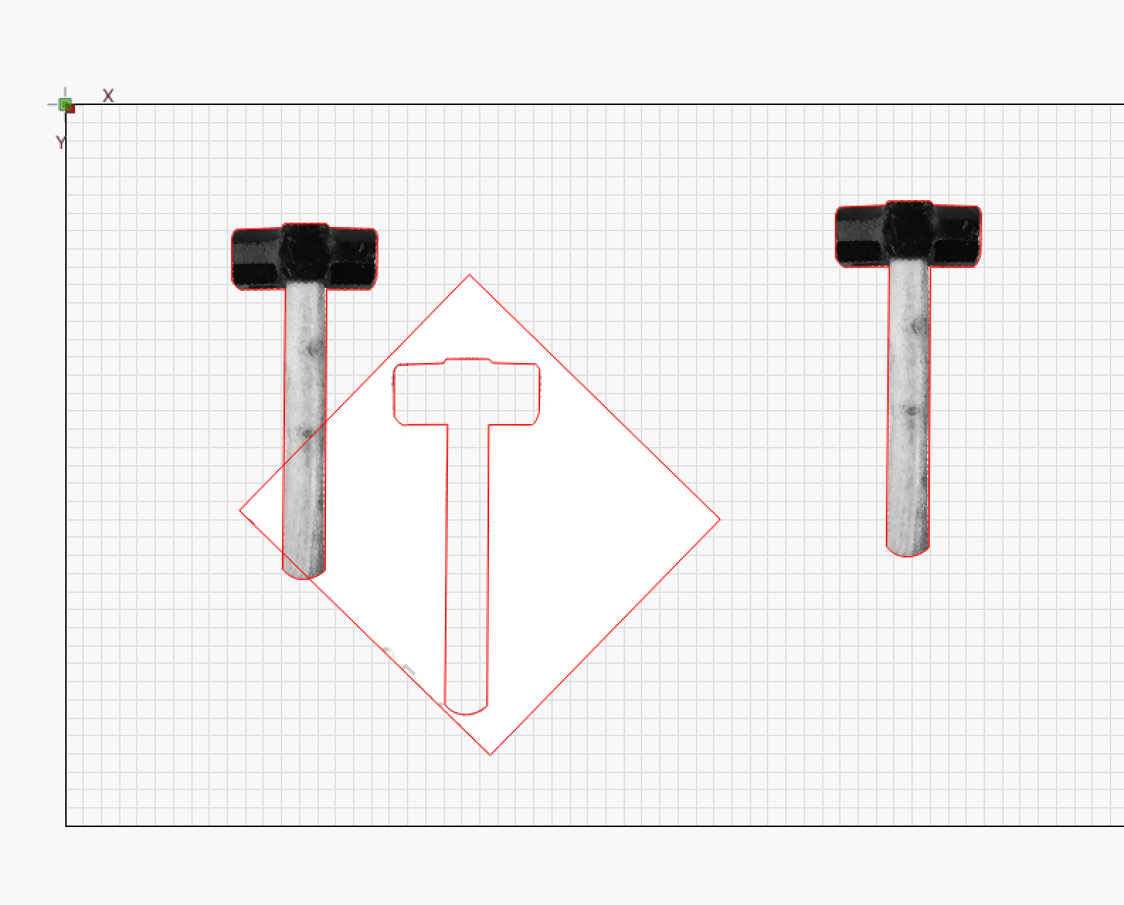

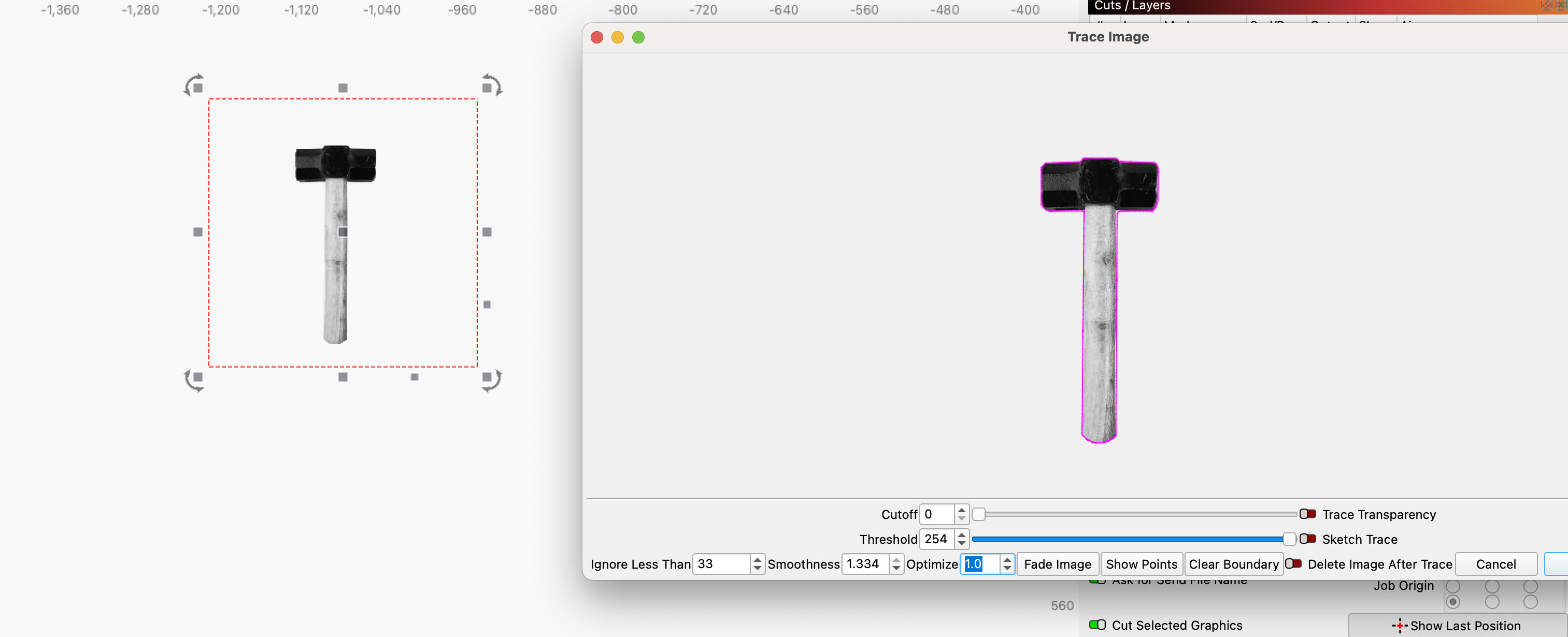

However, you must first trace your image to get the outer edge of your tool. I achieve the best result for this when I process the image in a way that makes it easier to trace. Then you must determine, with the offset function, how much tolerance you want around your tools.
Another option that I also use is to “cut” the object out with the line tool, it works fine with simple objects.
Image 1 is traced image 2 is drawn/cut out, both results can be used to add the necessary offset.
image 3 is with offset, all examples are only simplified examples.

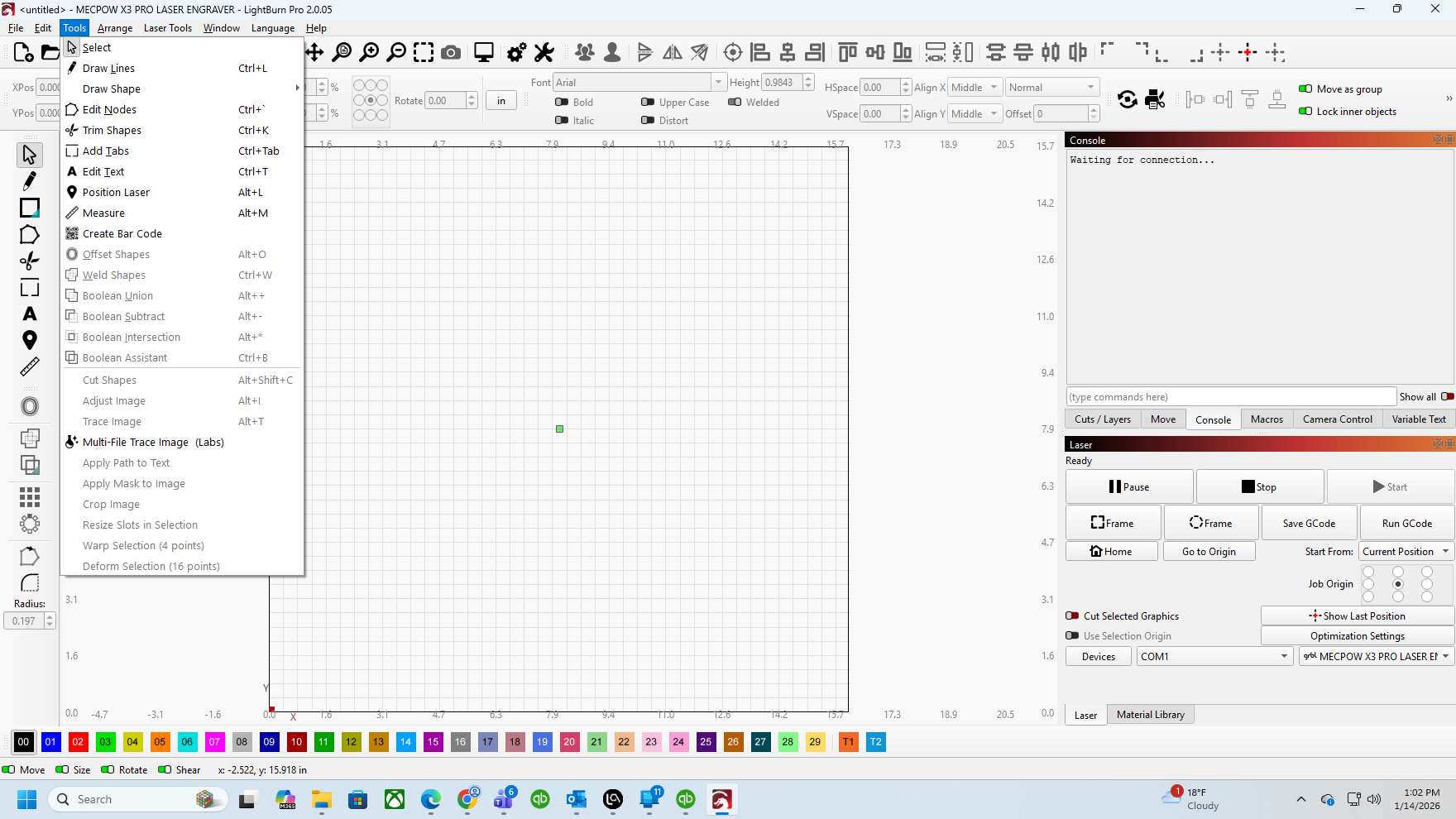

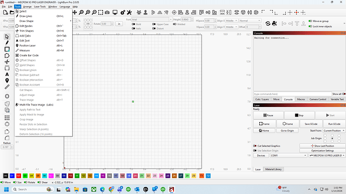

This is a screenshot of my LightBurn. As you can see the “Offset Shapes” is greyed out. There are many others functions greyed out in these tabs too: Edit, Tools, Arrange, Laser Tools.
Open the Edit, Settings window and show us that…
There are no shapes in the workspace and, thus, all the functions / tools operating on shapes have nothing to work with and are disabled. LightBurn grays the icons for disabled tools to indicate their requirements aren’t satisfied.
Put some shapes in the workspace and select them according to the tool doc:
Whereupon those functions / tools will become enabled and not-gray.
Also, without a laser connected to the PC, none of the Laser Tools have anything to work with.
