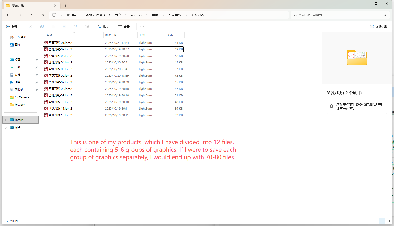

This approach would result in far too many graphic files. For instance, if I have a product comprising 12 cards, each card requiring 5-6 colour separations, that would necessitate storing 60-70 files for the 12 cards.

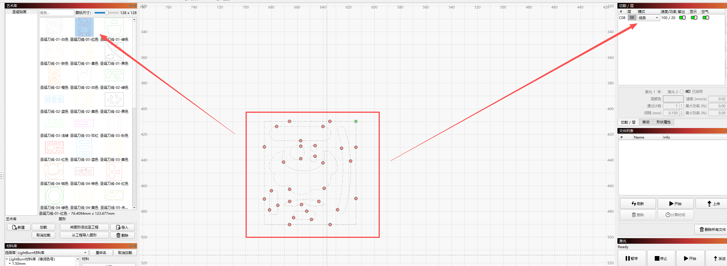

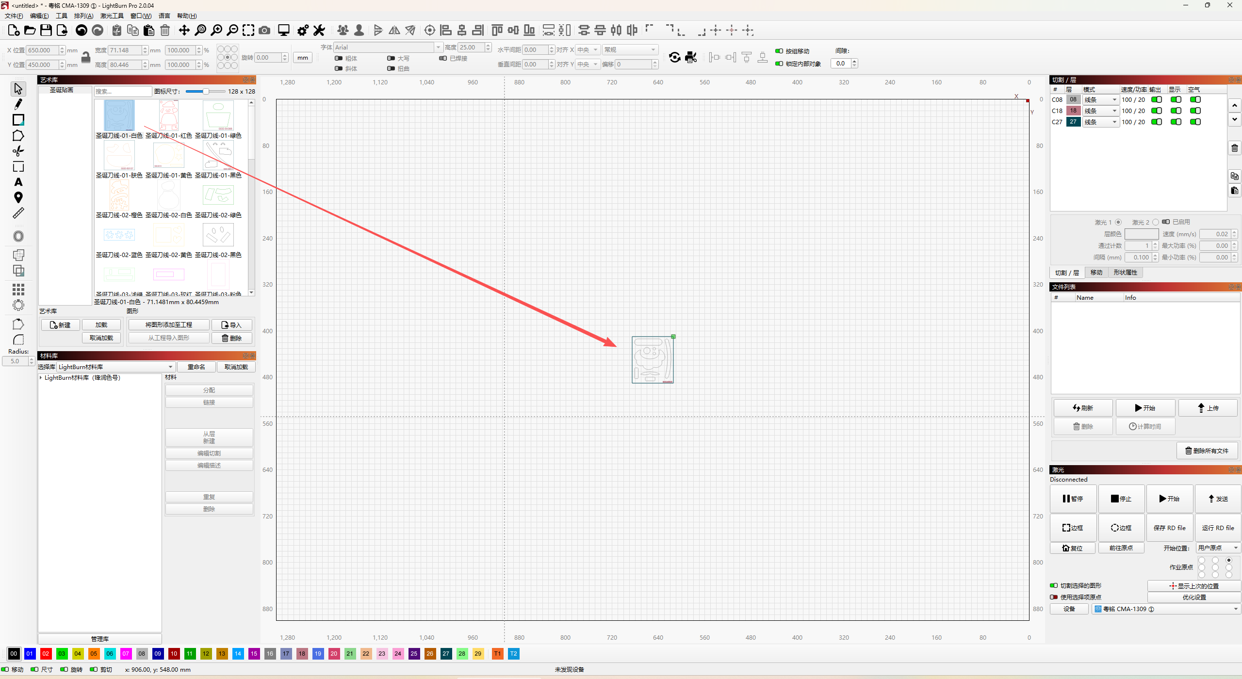

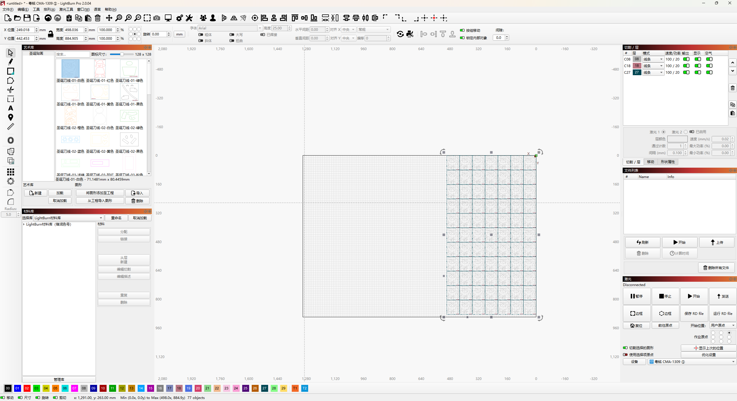

I opened a new document and imported the graphics that I had saved from the art library into the project. These graphics had already been processed before being added to the library. Next, I needed to lay out the entire set of graphics on the page quickly.
According to your suggestion, I still need to save the single graphics file as an LB file, but that would result in too many files.
A workaround is using the default layer settings and put your different graphics on those layers.
You can store different settings as default for C00, C01 etc. So you can drag your objects from the art gallery and put them onto the desired layer. Then you don’t have to touch the settings themselves, only change the layer colors.
The key is not the speed and power settings. The main thing is the setting of the bridge node, using the automatic assignment of the bridge node, its position is very inaccurate, all need to be manually, one point by one point to modify, the most critical is that the bridge node is lost after modification.
