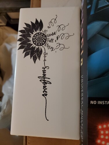

There is the Norton Tile Method for tile, uses paint that contains Titanium Oxide (TiO2) that will leave it black when lased by a diode. Then you have to remove the rest of the paint. There is a similar approach with powdered TiO2.

Porcelain tile is covered in glass. Even with paint to absorb the energy, it only engraves a slight amount. With a white background it may not be noticeable.

I have done the powdered Titanium Dioxide method and it works well on tile. Somewhere on YouTube, I found a video of how to do it, but basically you suspend Tio2 in Alcohol and use a special sprayer from Amazon. It puts a coating on that quickly dries out leaving just the Tio2 dust layer, Works well and cleanup is very easy. The only bad part is the sprayers get clogged easily. As you can see from the pics, I still need to work on speed and power settings. I was mostly trying to prove I could do it. LOL
