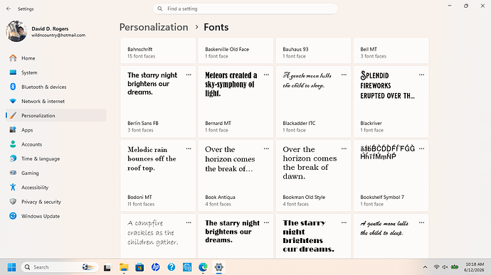

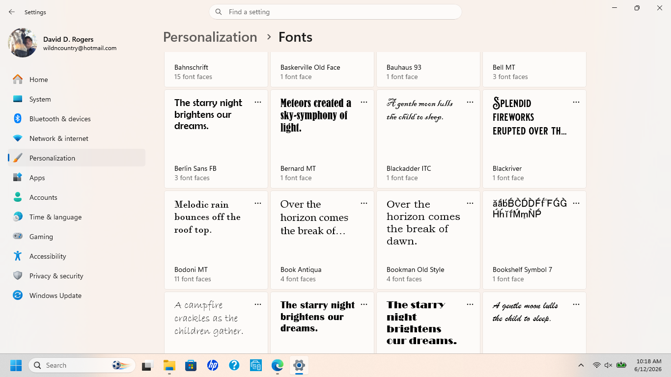

Here’s what my font list shows on my Win11 pc that the project was created on.

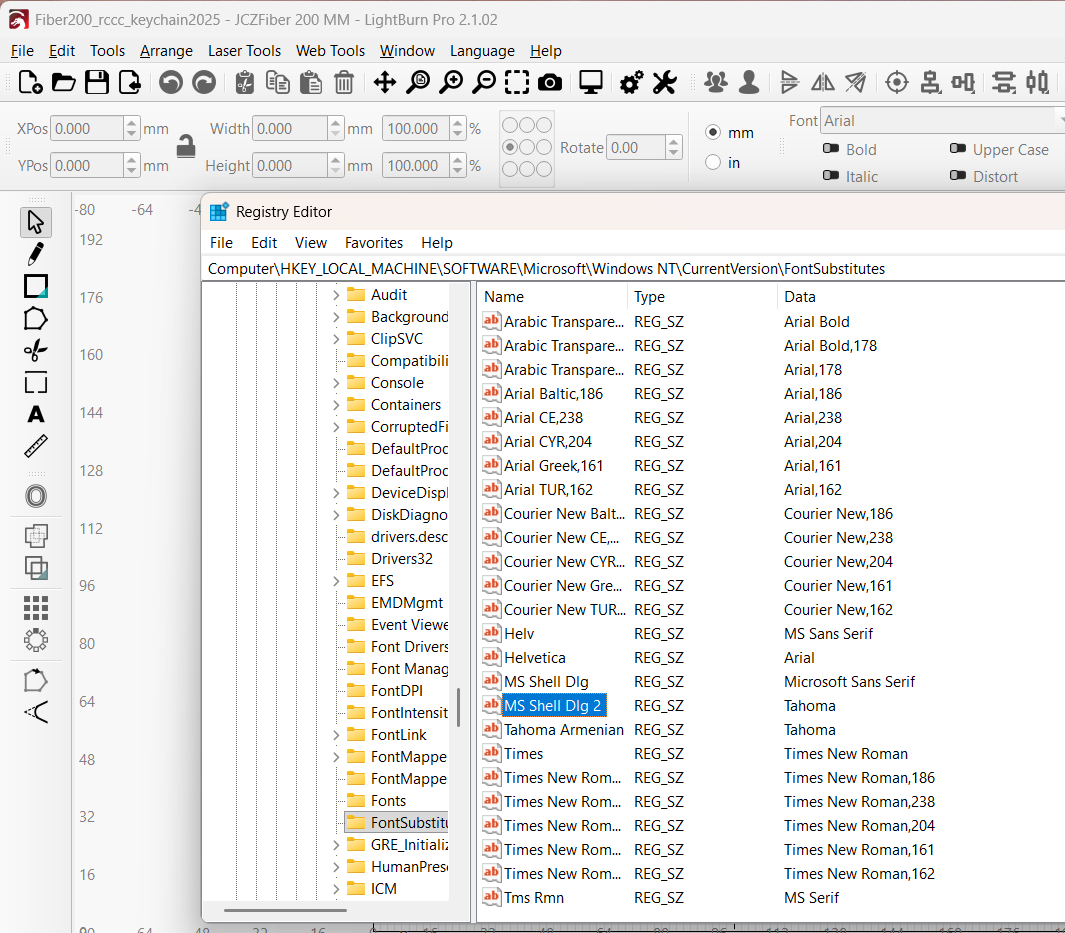

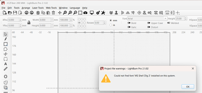

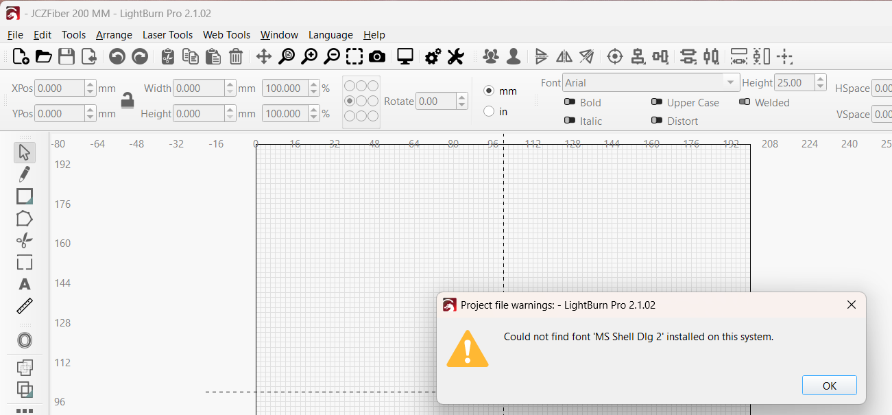

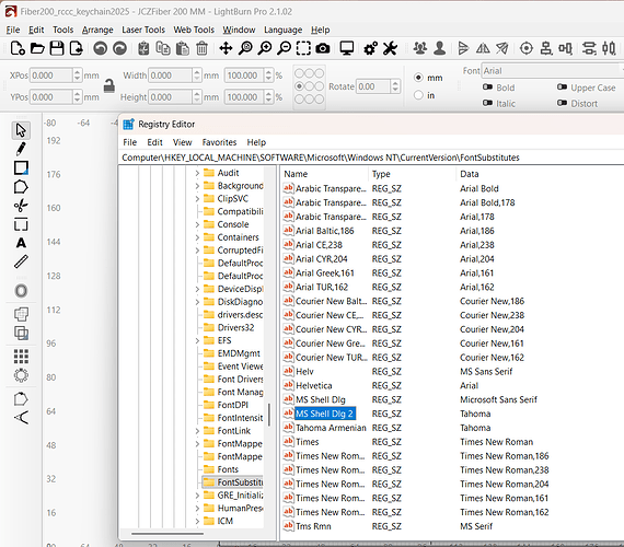

Same issue; Win 11 Pro, Lightburn 2.1.02. Older projects created on this machine. Error Could not find font ā€˜MS Shell Dlg 2’ installed on this system. This particular font is a substitute font in Windows and IS installed. I can pull it up in every program.
It is not a font part of the standard Windows installation for Win 10 or Win11. I do not have it on any my 3 machines. Is it a TrueType font?
That’s interesting. As you show in your screenshot of RegEdit, ā€œMS Shell Dlg 2ā€ is just a pointer to an actual font file on your system (in your case it’s ā€œTahomaā€), and as far as I’m aware, these ā€œlogicalā€ fonts shouldn’t normally be exposed as a selectable font in any applications. I have checked on my system and although it appears in the ā€œFontSubstitutesā€ list just like yours, it doesn’t appear in any of the fonts available in any of the applications I’ve tried (Affinity, Lightburn, MS Word 365, CorelDraw, Lazarus). I’m curious why this isn’t the case on your system.
