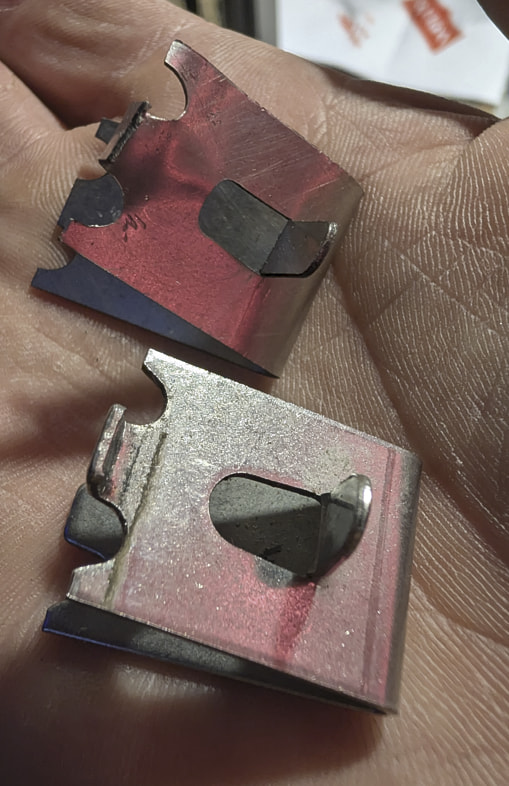

That’s a fair question. I don’t remember exactly, but it was more than 30 minutes. Greatly depends on the size of the shapes, of course.

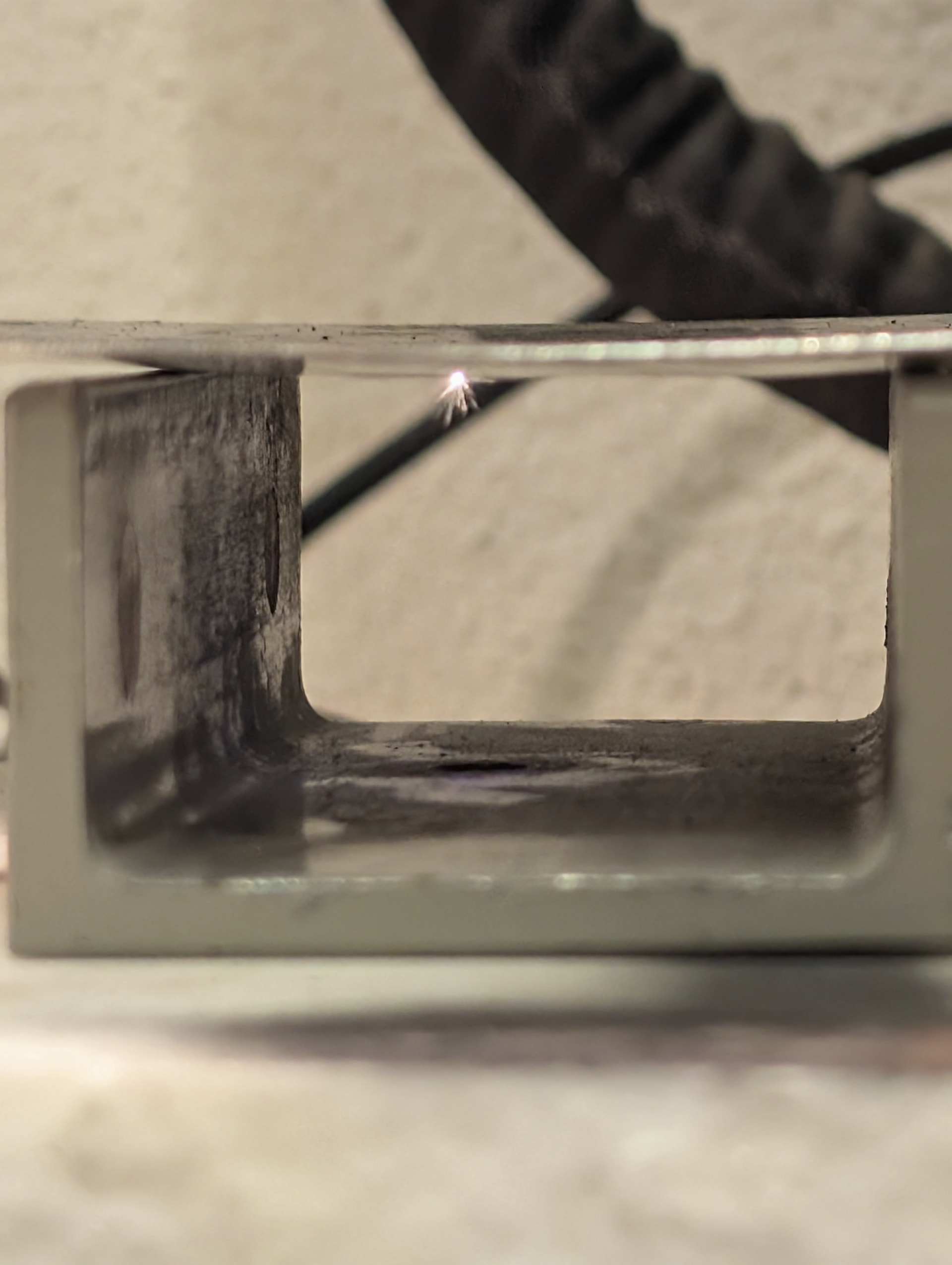

A more recent job was this shelf bracket in 0.75mm stainless that took half an hour:
I like to position the material so that I can see the sparks as soon as they appear at the bottom.
Cutting all the way through seemed difficult to me, since the last part hardly removes any material. But if sparks come out from the bottom, you can break the shape out by bending the blank around the cut.
This then requires finishing the edges and is certainly not suitable for large production runs. Nevertheless, it’s impressive that it works at all.

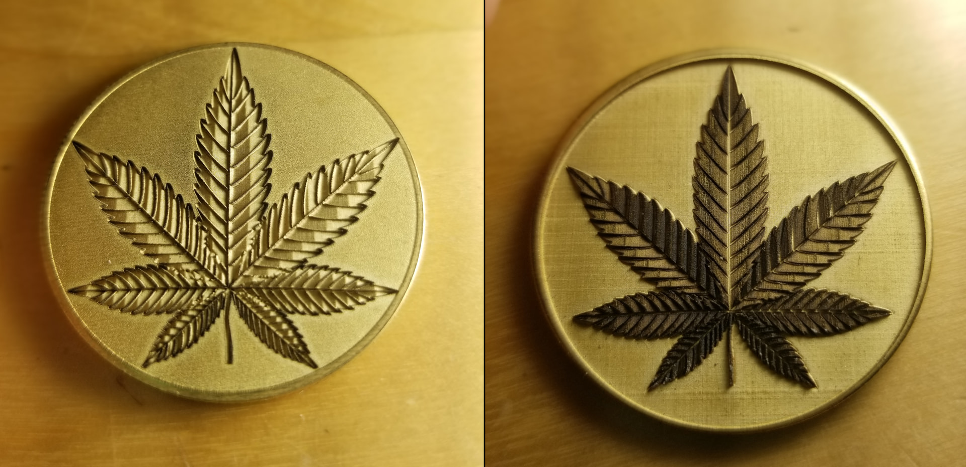

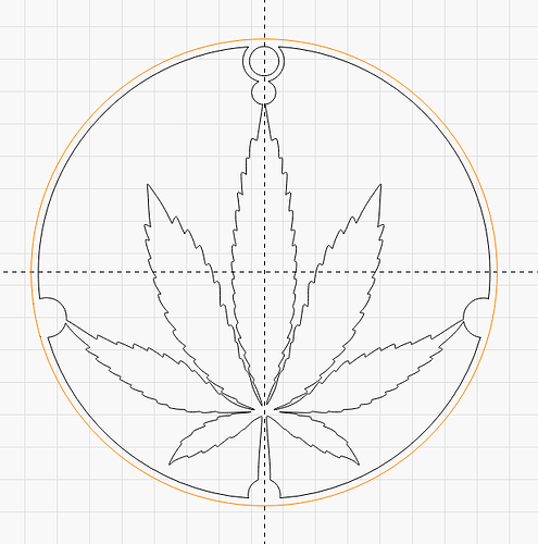

I support it off the table out of it’s dof. I found a post on Reddit about someone that lost his wife. A piece of jewelry she always wore had a marijuana leaf cut out of the center of the quarter. Looked like a challenge…
I believe it looked like this.
After looking at yours, I might try one of the images that I did the time with a grayscale and use 3dslice.
Left is engraved, so to speak, right is inverted, so leaf pedals rise above surface. The heat left it’s discoloration as both settings are the same.
Might try using the settings for the inverted one and just going through the coin…
Thanks…
