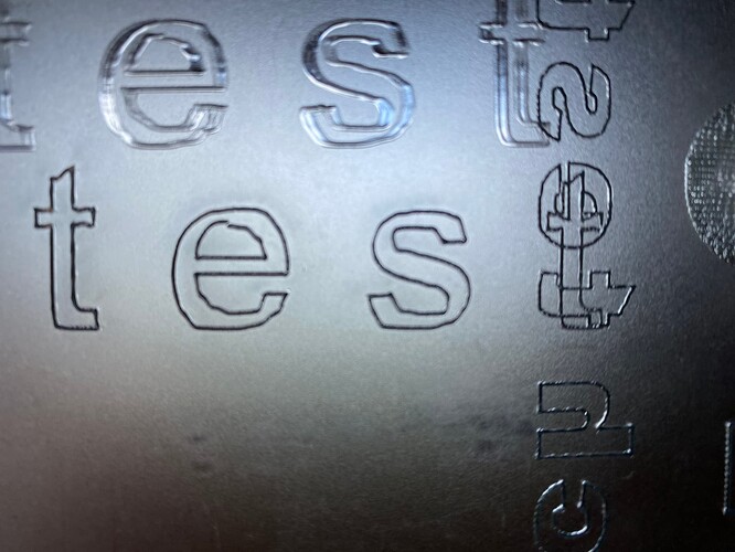

Did a focus line test, and got this…
X-axis only. Goes about 5 inches like this. Like the laser is in two different places at once, and at two different intensities.
Anyone seen this? Is this gantry, or alignment between mirror 2 and 3? Or…?
That’s frequently caused by the beam hitting the side of the nozzle because the 3rd mirror isn’t adjusted perfectly down the center of the tube.

Messing around with it, and I’ve gotten it much better…sorta.

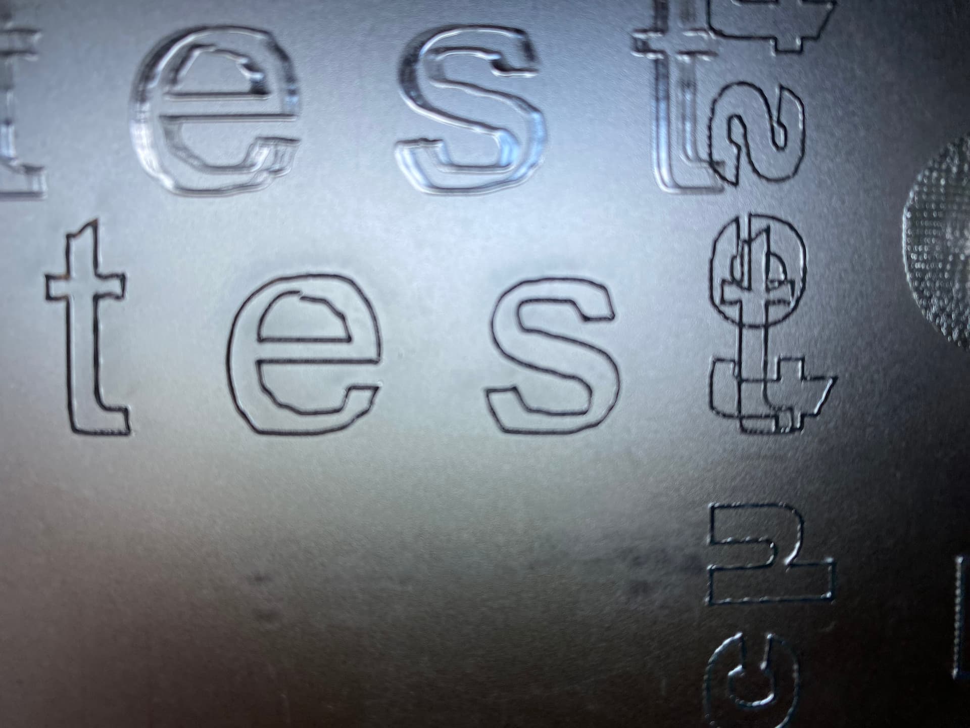

Look at this font and how messed up it is…(bottom one…)
Looks like you got the reflection solved but you still have some play somewhere.
Yeah… while I was having dinner, I reasoned that there was a difference between the tension on the X belt and Y belts.

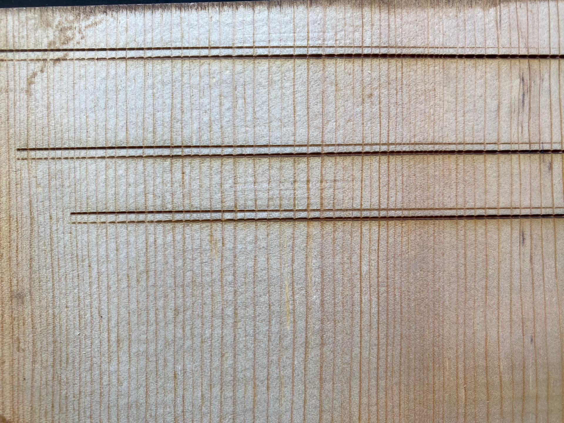

I did another line test for depth, on a piece of wood. It would seem that on longer lines, I still have the reflection issue. It just takes further down a path, to show itself, and it’s pretty evenly split, half and half, this time. The line(s) are thinner and separated in the middle, now, as opposed to a few inches from the end. It appears that as the mirror moves towards the center of the rail, the issues starts up and then fades away as it keeps moving down the rail.
The mirrors’ not cracked. I’ve been trying with the mirror adjustments, and adjusting the mount (to the X gantry rail) itself. Until I can get one of those laser units that feeds from the nozzle end, I’m probably just chasing my tail.

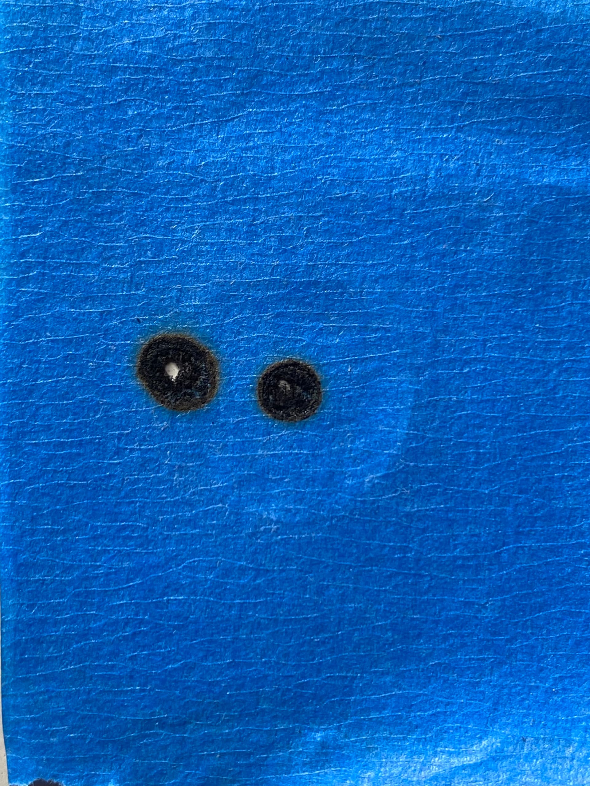

I haven’t figured out how to pulse the unit, yet, so I made a test file, and would stop the file almost immediately after it started. From what I can tell it looks like the beam from #2 is hitting #3 pretty much dead-on, but I need to find some tape that doesn’t catch fire so rapidly.
OK. So… this is the pulse test.
The center one is the result at top left and bottom left; the one on the left, is top right and bottom right. The results on each side are identical from top to bottom. It drifts that far during X axis travel.
I’ve done some cutting tests and it really seems that everything starts to go south, about halfway across the table; I can produce all sorts of nice, clean cuts on small pieces if I keep everything to the left side of the table up to the middle.
Noteworthy is that as the cutting progresses from left to right, the depth of the cut gets shallower; I tried cutting a long piece, with 7 instances of the same item in one line from left to right and only the first one on the left was complete…the next few were close but got progressively lighter by the end.
It seems to me, to be a bit extreme for a simple mirror misalignment…like something else - bigger - is out of whack but for the life of me I can’t see it.

Definitely mirror alignment. The burns need to be in the same location at all 4 corners.
wellyesI’mfullyawareofthat.
The point is, is it normal for the other end to be identical in misalignment? It seems a little too coincidental…like the mirror is aligned but something else is causing it to drift evenly.
It’s not all that unusual. It appears that there is a slight difference in the 2 burns at the far side. Just adjust them a little bit at a time until they align.
Sure! Mirror 2 is aiming the beam slightly to the rear of where it should be, so take another pass at it. You’ve done a good job so far and a little more tweakage will get it done.
FWIW, having the beam far enough off-center to hit the edge of the aperture at Mirror 3 will give you exactly the double-beam effect shown at the top, because the beam will almost certainly be splashing off the edge of something between M3 and the nozzle orifice.
