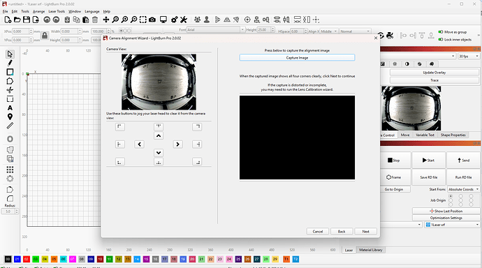

Capture image shows black screen
When I’m doing the Camera calibration and alignment I’m getting a good live image but my capture is showing up black. I have restarted lightburn, my laser and both at the same time as well as unplugging and plugging back in my usb cable into my Laser engraver. I’ve seen a lot of people are having this issue, has there been a fix for it yet? I was able to calibrate my camera but I can’t align it at all.

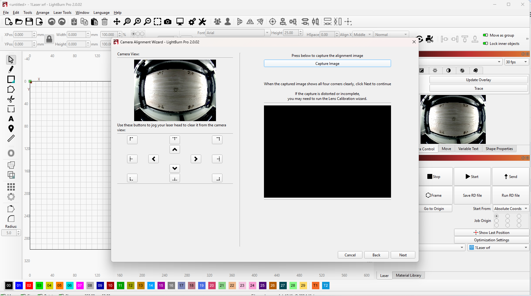

I’ve got a dark screen for my capture and calibration image.

LightBurn version 2.0 brought a ton of new camera features! Some of them are not immediately visible, like the completely rewritten Windows drivers.
The change to QT6 also opens the door for more exciting camera capabilities in future updates.
A list of new features:
We introduced a new, post-stoneage way to calibrate the camera lens using the new calibration card with AprilTags and tracking function. (The circle pattern should not be used anymore)
If you’re seeing the black overlay image, it may be due to using an old Camera Lens correction profile in version 2.0.
Please follow the instructions for camera calibration with Tracking to see if it solves it for you too: Calibrate Camera Lens (Labs) - LightBurn Documentation
This feature is still in testing (Labs feature) but is currently the most precise way to calibrate your camera. It’s only accessible with a right click on the “Camera” window:
After this, perform another Camera Alignment as usual: Calibrate Camera Alignment - LightBurn Documentation
