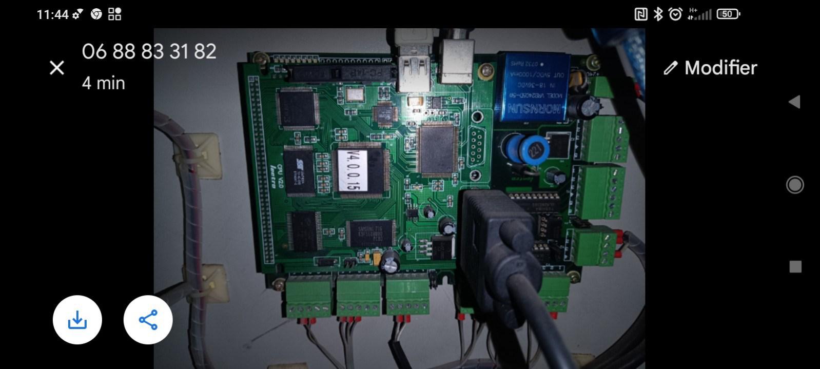

Je voudrais acheter un plus grand laser c02 d’occasion mais je ne sais pas si il est compatible avec lightburn ? Je veux bien votre aide pour m’aider à trouver la solution.
La carte est une MORNSUN MODEL VRB2405D-5W IN 18-36VDC OUT 5VDC/1000mA 0732 RcH5

Trick question? That is a DC-DC converter board. Has nothing to do with Lightburn.

No apology needed! That board is a power supply component and likely not used in a laser.
The exception would be if you are building a do-it-yourself machine. In that case, you have a huge task ahead of you if you are not good with electronics, but not impossible.
If you explain why you selected that board, we might better understand what you are trying to accomplish.

Sinon voici la photo
Picture is a big help. That blue thing is the DC-DC module, not the brand of the board. The brand is that white writing on the left side.
I see a USB connector on the board. I cannot tell if the board is GRBL, Ruida, or some proprietary operating system.
To get better help from those that own CO2 lasers, you need to provide the machine brand and model. If it powers up, you need to describe what you see in a display panel if it has one.

On a trouvé le numéro du contrôleur, peut-être que ça va vous parlez…
C’est le contrôleur Mpc6515, comment savoir si il est compatible avec lightburn ? Si oui Mac ou Windows ou peu importe ?

MAC or Windows makes no difference, except late model MAC’s have an issue with USB-C connections to the laser.
I did a forun search, which you could have done, for the MPC6515 board. It is a Leetra board and is not compatible with Lightburn at this time.

Dernière question, ce contrôleur MPC peut on le remplacer par un Ruida par exemple ? Si oui, y a t’il des réglages à prévoir ou simplement changer le contrôleur ?
Merci
Short answer, NO.
Long answer, Plugs and physical size can be different. Function of the connections can be different.
Best answer, yes it can be done. Others have done this for the same reasons. Search the Forum.
