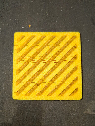

I’m having an issue with my Bosslaser LS3655 where some of the lines on my cut are being shifted over. Anyone had this problem before?

If the PC is connected to the Ruida with a USB cable, you’re seeing the result of USB communications problems that chop out pieces of commands.
The first level fix is to get a USB cable with ferrite cores on each end, ideally from a supplier specializing in tech stuff.
The real solution is to use Ethernet, rather than USB, because it eliminates all the USB problems.
Some previous discussions give more details:

Not sure yet but we can try to narrow it down;
Does dramatically varying the output power or speed have any effect on the problem?
Try a test job with a single vertical column about as thick as one of those diagonal lines, but with a line interval of 0.3 so the individual burn lines are easier to see.
Try with and without bi-directional fill enabled, to see if that has any effect.
Does it only happen with engraving/fill or does it also happen with cutting or “Line mode” jobs?
I’m guessing because it is so intermittent that it’s electrical noise somewhere affecting the controller output signals corrupting the sync between firing and motion only for some scan lines - see if reducing speed and power a lot makes the issue disappear.

This worked! Thank you so much!
