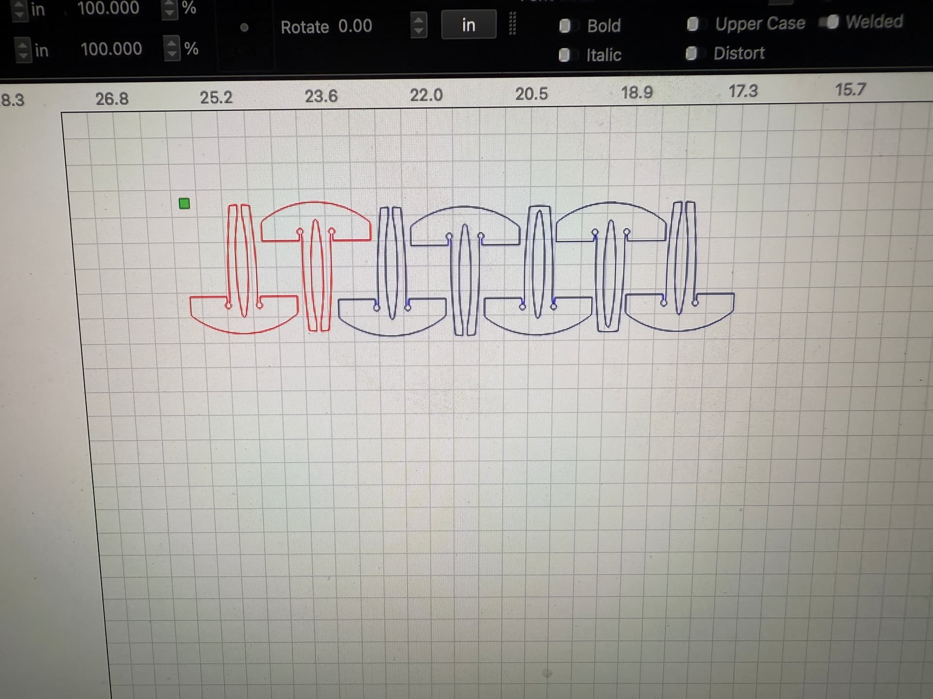

Laser jumps and does not cut the image on the cut line
I am operating macOS Sequoia 15.5 on Apple M1 system. After installing v2.0.00 and trying to cut
the laser will jump and cut a line that does not exist on the workspace? I tried multiple times to cut different images and the same occurs each time. I did the update and the same issue.
I have reverted back to 1.7.08 and no issues. Any suggestions would be appreciated,

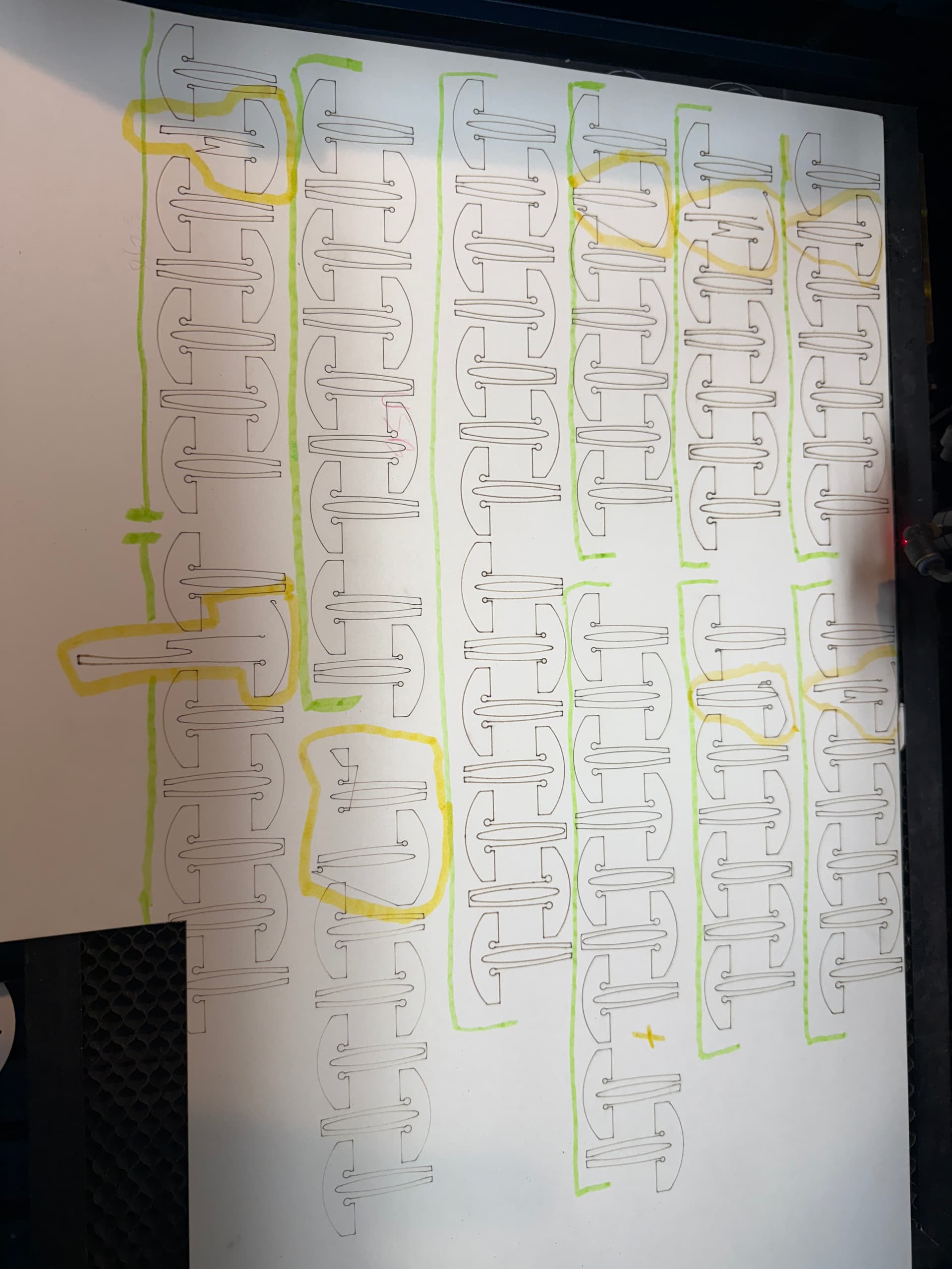

Thank you for the response, but unfortuantely it is definetly something between the software and the machine.
I can run the previous version of LB 1.7.08 with no issues at all, cut or engrave. The second I switch to the update 2.0.01 the same issue occurs I used multiple files and the exact same ones so that I would have a direct comparison.

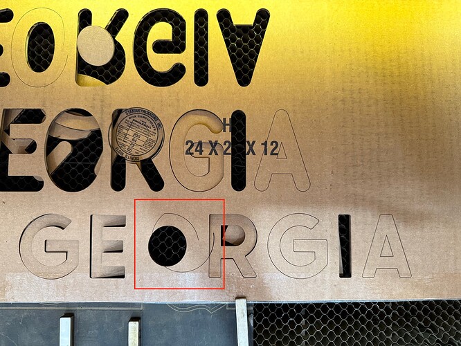

Did you discover why? I’m having the same issue after upgrading.
Just like you, old version runs fine which I’ve used since 2022. System was too old for Version 2.0.02
So, I Bought a newer mac and now I have a 2019 Imac with OS sequoia and Ruida 644xs.

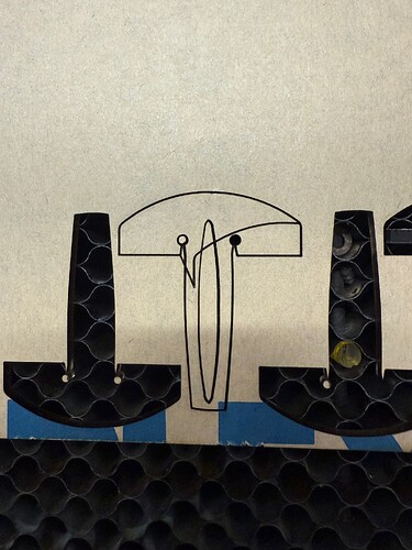

Its obvious which cuts don’t belong.
I Edited the File but it still goes Rogue but in a different way.
I think I have solved my issue. I switched to an ethernet cable (previously using USB) and I don’t seem to have any more issues. It has been only a day, but it seems to be working fine now with the newest update of LB.

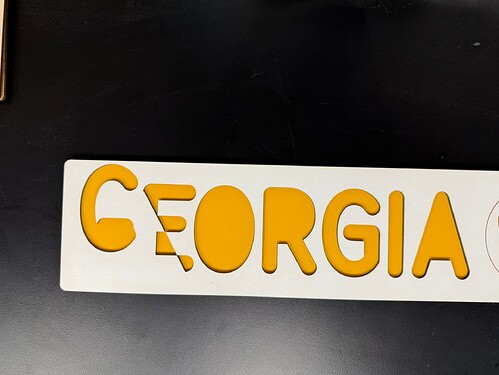

I have been trying to get my laser to connect to my mac via ethernet but so far unsuccessful.
Hopefully a friend who is tech Savey dropping by later tonight to see what I’m doing wrong.
If i get the laser and the Mac communicating via internet I’m hopeful that is the problem.

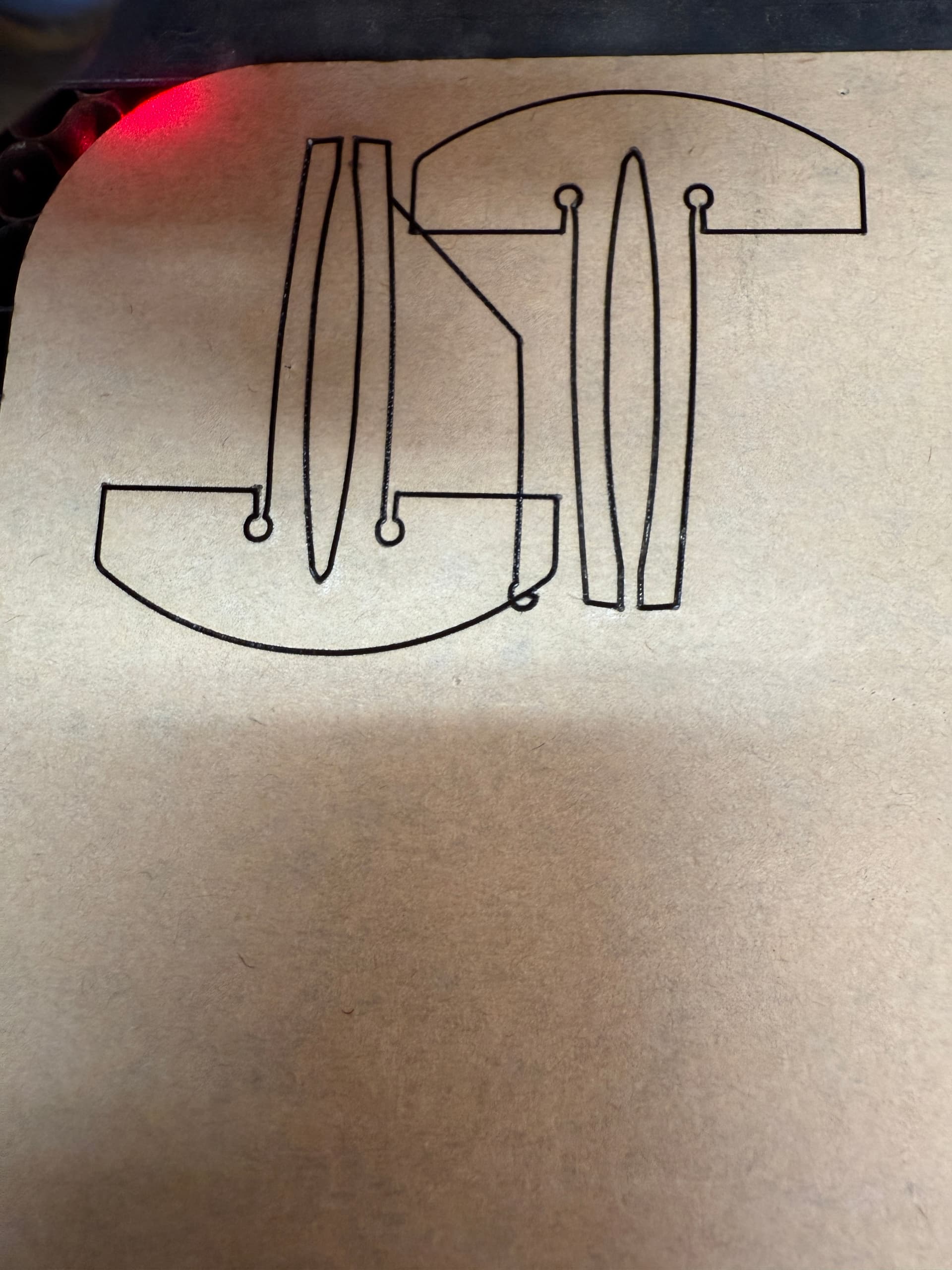

Here is another Pic showing the variety of shapes I get by just pushing the start button.
