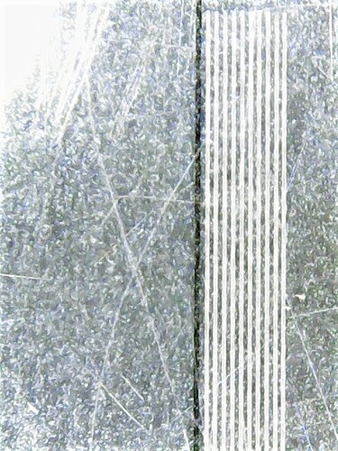

@jkwilborn Vertical Scan
Black line is 50 microns
@jkwilborn
Horizontal scan
Black line is 30 microns
Pot laser horizontal Black line 30 microns
