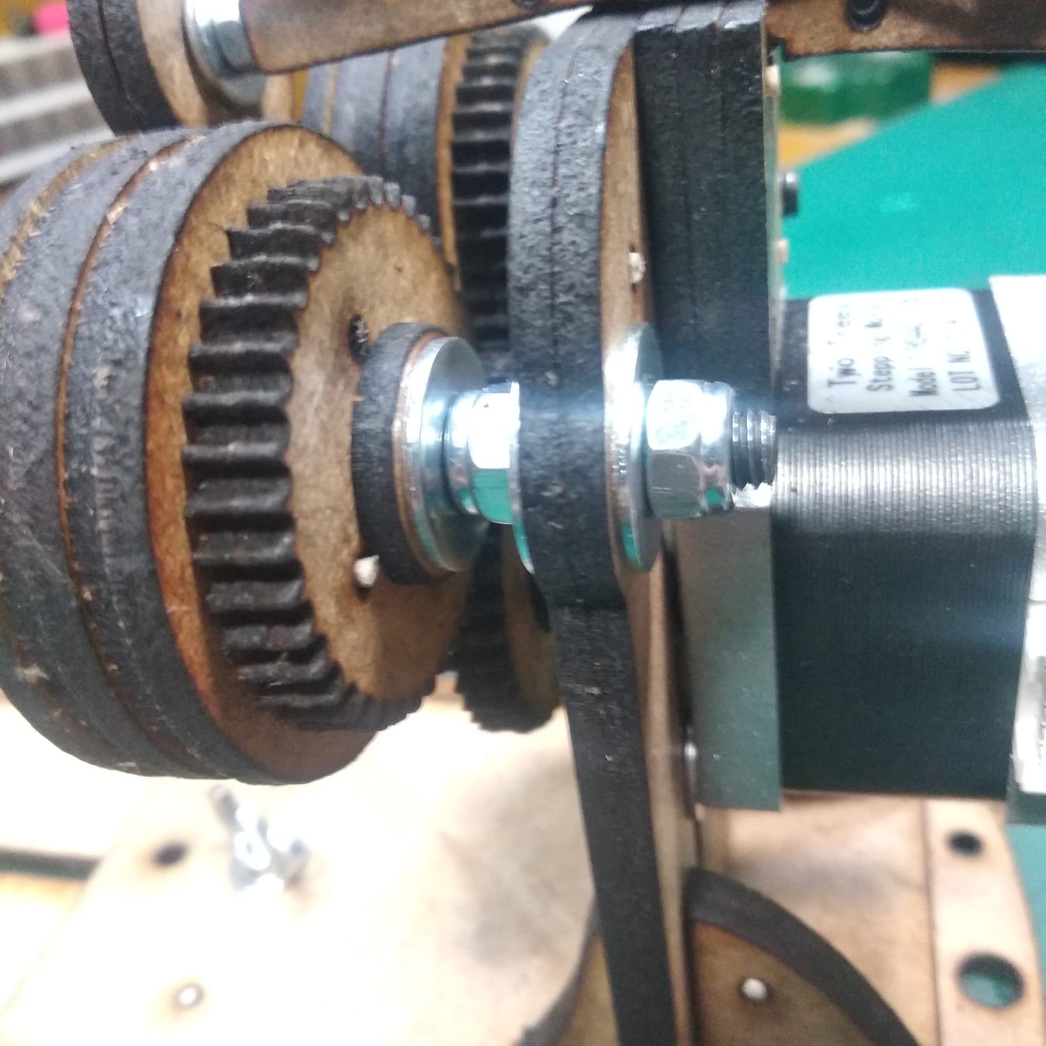

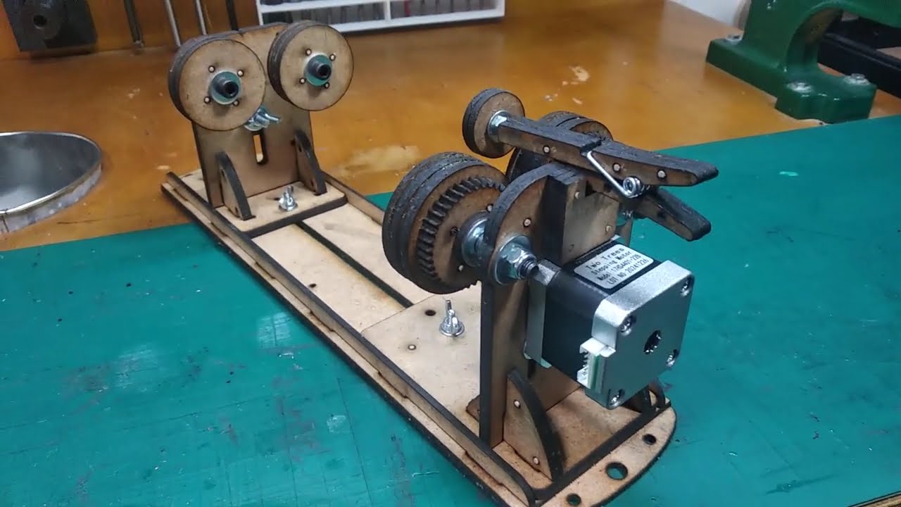

I’ve finished the project.
I’m leaving pictures of the roller rotator I made, thanks to Mr. CS’s altruism and the know-how he demonstrates. Thank you very much, Mr. CS.

Hello Albert,
Your rotator looks great. Other than the stepper motor, did you have any problem getting all the items needed to make it? My goal was to design it so everything needed to make it was easy to get but was still able to work effectively. Was there anything in the build manual you think should be changed or added?
I will be putting the plans for the completed LongWorth 3 Jaw rotator up soon (hopefully this weekend). I redesigned it so all the parts should be easy to get with the most expensive part being the stepper motor.

Hello, Mr. CS.
I haven’t had much difficulty finding all the components. The only thing I haven’t been able to find (because it’s Easter in my country) is the O-rings. I decided to print them with TPU on my 3D printer, but that will be in a few days when I have the 3D printer free.
I also replaced the M6 ​​nuts on the roller axles with self-locking nuts, so I can still remove them if necessary (if I fix them with glue, it’s harder to remove them).
I added metal washers and wing nuts to the M4 x 20 screws that hold the front and back to the base. Perhaps a thicker base, like some legs, would be better. The screw heads are a bit tight and stick out a little, although keep in mind that I added metal washers.

I used an M4 clamp screw instead of an M3 or M3.5.

The nut and screw fit aren’t M5 as indicated, but M6, at least that’s the nut size I used. I also couldn’t close the nut casing; the nut is thicker than the space for it. I had to leave it open at the bottom, but since the nut fit perfectly, there’s no need to close the casing.
There were some extra spacers and sprockets in the Metric Rotary Front For Manual.lbrn2 and Metric Rotary Rear For Manual.lbrn2 files.
Apart from these comments, I think everything else was correct.
