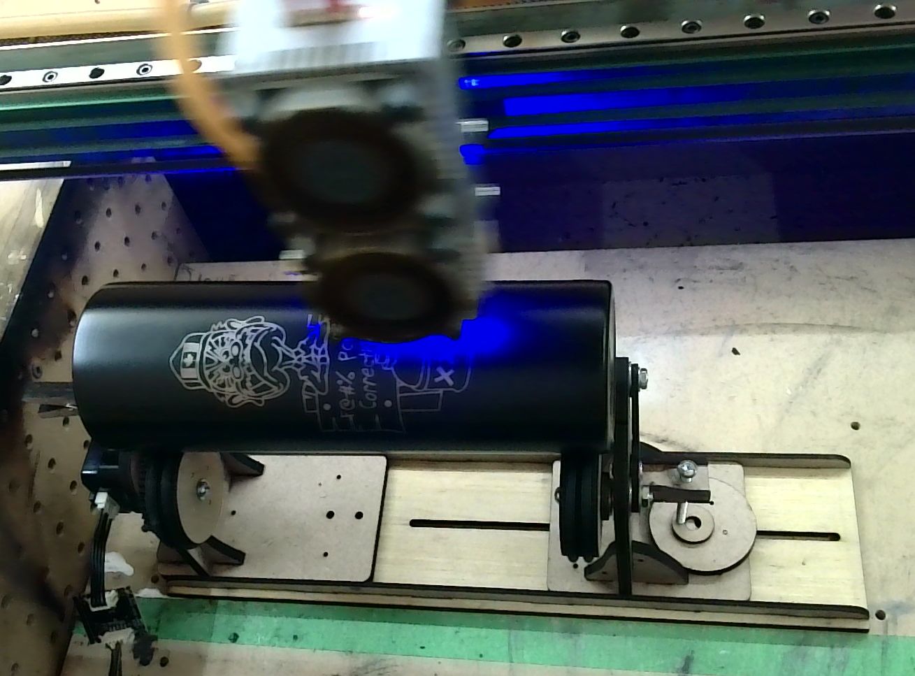

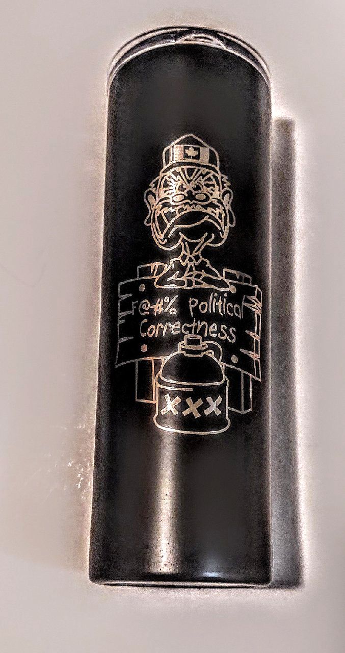

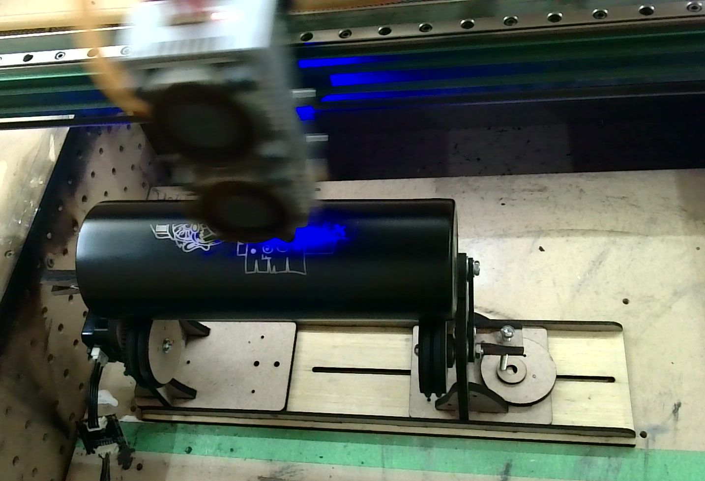

Here is another rotary that is easy and cheap to make. Everything is easy to find and inexpensive. The most expensive item will be the stepper motor. I’ve attached pictures of the roller, screen spline and of it in the process of making a mug. Also attached are the LightBurn files.

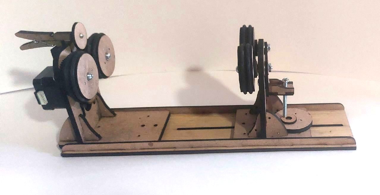

I wanted to make it so anyone could build it, even with a less powerful diode laser. With that in mind, everything is made out of two layers of 3mm MDF. The small 2mm holes are alignment holes so the layers will align perfectly. Stick a round toothpick into them and glue the layers together. After the glue dries, break the toothpicks off.

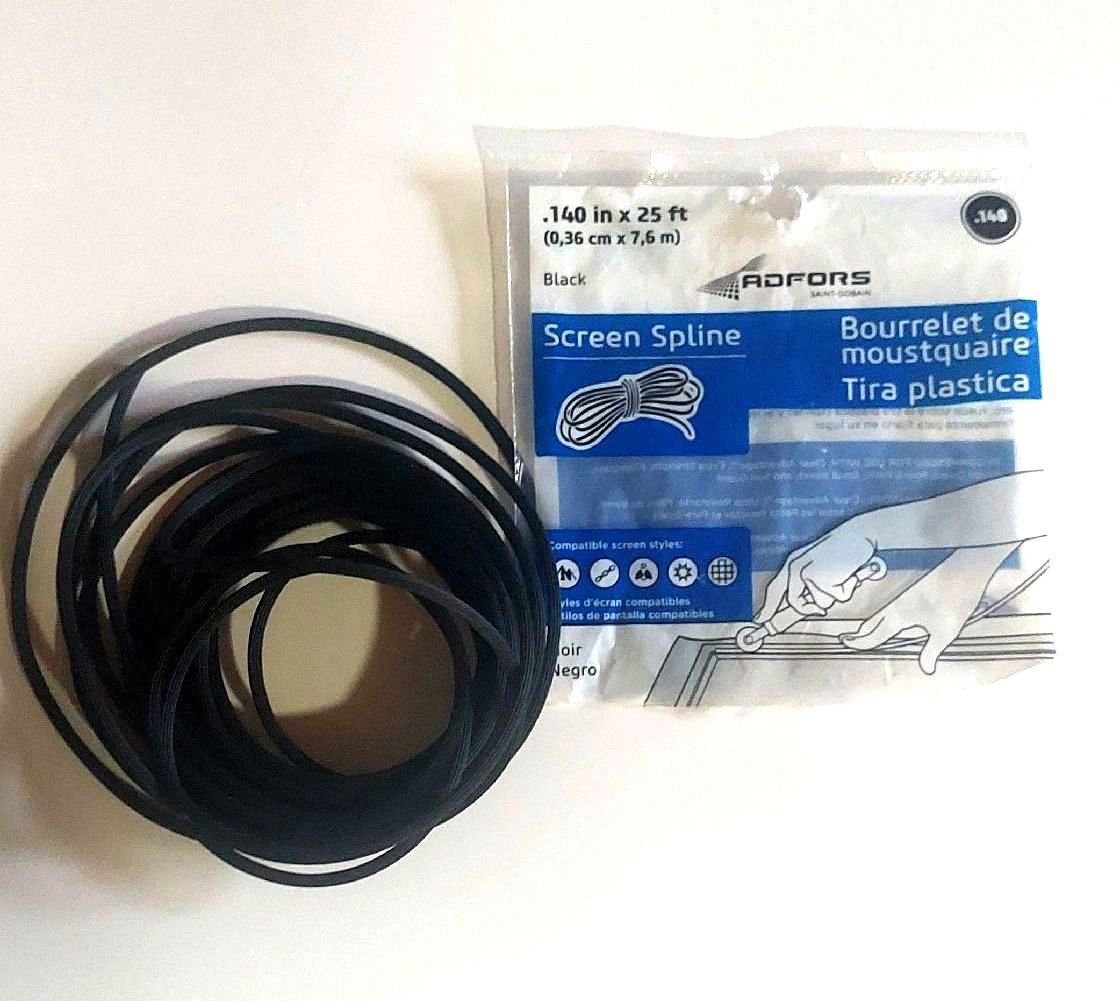

I made the roller feed assembly out of gears instead of pulleys because it was an easy and accurate way to drive them. The rollers themselves are 3 layers of round MDF with 2 smaller diameter layers separating them. The rubber for the rollers is made from window screen spline cut to size. Melting the ends together makes a strong joint.
The bushings for the rollers are round spand-offs I got from Amazon a few years ago (Zmbroll 235Pcs ABS Black Round Spacer OD 7mm ID 4.1mm for M4 Screws 15Sizes Non-Threaded Column Standoff Support Spacer Round Straight Tube Plastic Washer Standoff : Amazon.ca: Tools & Home Improvement). 8-32 rivet nuts, 8-32 x 1.5" bolts, washers and nuts are easily found at any hardware store - Princess Auto will have them cheap for all Canadians out there. The bolts, nuts and rivet nuts are the same as 4mm sizing.
I had everything on hand so my total cost was zero dollars.
The entire project was easily cut using a 20W Neje that I reduced the power to reflect that of a 10W diode.

I’ve made some changes to the Lightburn file so I’m including the new files. It occurred to me that needing to buy the spacers defeated the entire purpose of making this easy and cheap for everyone to build. That is why I have removed the spacers and the 8-32 bolts, nuts and rivet nuts. They have been replaced with easily sourced and cheap 1/4" (6mm) bolts, nuts and washers. Unfortunately, I still have the screen spline although if someone can find proper size O-Rings, they would work as well. However, the ones I see that are the correct size are expensive and I want to keep cost down for everyone.
I have made a “Build Manual” in PDF format for the motor assembly drive unit. As PDF cannot be uploaded, you’ll need to delete the “.txt” extension. Hopefully it will explain things.
I ran out of time to make the back assembly unit but I hope to get to that this weekend and I’ll add it.
Please let me know if the manual provides proper explanations or it I should change something. Reading it makes the process sound complicated but once you’ve made one, you’ll be able to make more faster and easier. Once the parts are cut out, it took me less than 20 minutes to make (not counting picture taking).
