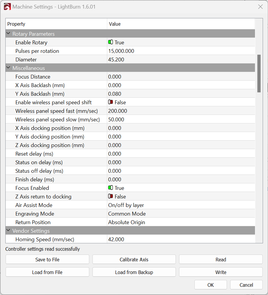

I’ve been through several similar posts that didn’t have a conclusion, or advice that I haven’t already tried, so I’m creating a new one to see if I can get some help figuring this out.
First some details:
  • Gweike Cloud Pro II 55w + Xtools RA2 Rotary in Chuck Configuration
  • Ruida RDLC-V15.50.18
  • LightBurn v1.6.01
  • Stepper Motor (on the RA2): Golden Motor 42HD2036-14
I did read the rotary instructions for LightBurn and for the Xtool RA2. Xtool says to use “128 mm Steps Per Rotation” but that doesn’t show up with a Ruida controller and I knew I was doing something a little hybrid here anyways.
I did see the DSP notes for LightBurn, and have I been painstakingly writing settings, powering off, restarting, and testing. I have also disabled Y axis homing because that was getting annoying.
Eventually, by measuring the outter gear size (45mm) and marking a point, I could see it performing one full rotation. However, it was a “little off” (like maybe 1mm off of a full rotation), but then when I tried to test other “steps per rotation” (and power cycling after writing), I noticed that nothing mattered. I can set it to 200, 360, 400, 500, 1000, 10000, and it would still do the one rotation.
The only thing that changes the rotation is the Object Diameter, but that defeats the purpose if LightBurn needs to know that to determine the speed, scale the output, etc.
I have seen other posts with this symptom, but all of them I could find either ended unresolved, or ended up being something like they were not power cycling after writing settings, etc.
What am I missing here? Is there something unique about the fact that the RA2 is a combo roller and chuck? It uses the same motor but in one configuration it’s a roller, but in the configuration I am using it, the rollers come off, and I installed the gear/pulley with chuck attachment. See their YouTube install video for a demonstration of that.
Here are some screenshots at 15,000 but it does one full rotation at 45.2mm no matter what the steps are, and rotates past 1 full rotation with anything larger than that.

After reading through some other posts on the FB group and elsewhere, and pinging the dude who told me he had this working in LightBurn, here is the “hack” some people are using… but this really seems like something LightBurn should be helping with.
What people have been doing with this and the OMTech Polar (they’re almost identical machines) is calibrating the Y axis for each circumference they have to burn. So they back up the planar cutting settings, then for the rotary config, usually disable X and Y homing, calibrate the Y axis (test prints, etc) and then save those settings as a unique profile for that specific object.
In case this ends up being a “solution” that works for some, here’s what others need to know (and I’m pretty sure this is unique to the Gweike and the OMtech Polar - because it’s not supposed to be this difficult).
  1. The steps per rotation don’t do anything at all. I set mine to 12800 ultimately, based on a suggestion for the Xtool RA2 in another forum, but I’m certain that doesn’t matter because no matter what I set it to, nothing changes, even after power cycling as suggested.
  2. I had to determine the “base rotation” to set the Object Diameter using the size of the main gear that I was measuring for a full rotation (using masking tape). That was 45mm in diameter for the XTool RA2, but ultimately, I had to tweak it to 45.2mm for one full rotation.
  3. With that done, what you’re about to do is all relative based on that setting, so don’t go messing with that.
  4. Backup your normal Machine Settings before touching anything. There’s no going back once you start messing with the Machine Settings if you don’t have a baseline to recover from.
  5. Setup your laser for a test print on masking tape, (400 lpi, 500% speed, 20% power). Calculate your material thickness or manually set your Z axis. Set the Start from to: Current Position. Use the Move commands to position the laser, etc.
  6. Calibrate the Y axis by printing a 30mm rectangle along the circumference, that should get you close. Then do a full circumference rectangle print, and see how much over or under you were and recalibrate again. Feel free to repeat until your Y axis calibration is perfect.
  7. (Optional but useful) Go into the Vendor Settings and change the Enable Homing to “False” for the X and/or Y axis. Especially with the Y axis or else it’s going to try to spin around LightBurn’s default value of 10000 until it gets back to Zero (0). That’s super annoying and there’s no way to have LightBurn only move the X axis as far as I know.
  8. Save these settings for future printing of this object. It’s tuned to the exact circumference, so you’ll need one of these files for every object.
I just did all this, and calibrated the full circumference, and have it dialed in now, but this is time consuming, super annoying, and again really feels like something in LightBurn is either not working correctly with this machine or maybe a new feature waiting to be implemented.
I’ll try some more interesting test prints tomorrow, but this strategy should work for now. In the meantime, it basically means that the Rotary settings in LightBurn are pretty useless to me with this setup.

In case others who find this thread are curious, XTool tech support actually replied with the details I requested about the RA2 Rotary Tool in the Chuck configuration.
Regarding the question, one step of the stepper motor is 1.8 degrees, and one circle is 200 steps. We use 1/16 stepping, so it will take 3200 steps to equal one circle.
