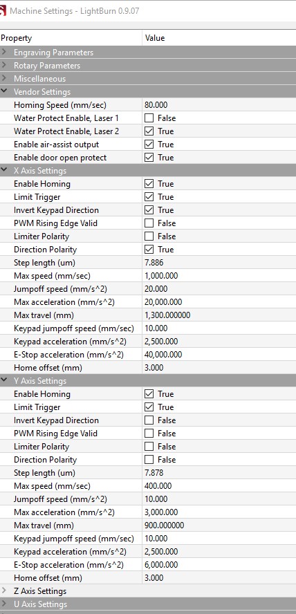

so, mechanically everything seems to be sound. he did a reset default params at the controller level and tried rdworks with acceptable results. any other suggestions?
I do subdivide differently than RDWorks does - adjusting the curve output tolerance could help, but ultimately what makes more sense is choosing a speed that the machine is physically capable of so it’s not constantly trying to accelerate / decelerate on straight bits and shaking itself to death.
Are you running the same machine with the same settings as him? Check the curve tolerance value on yours and make sure his is set the same. Other than that, it’s machine settings only that control how the job runs.
this is from the OP’s machine. they only real differences from my settings (aside from bed size) are some of the e-stop accelerations but not sure that is even a factor here
And what is his curve output tolerance compared to yours? (In global settings)
finding that info. there is this as well:
curve output tolerance 0.005
0.005 !? That’s in mm. You’re fire-hosing the controller with node data.
