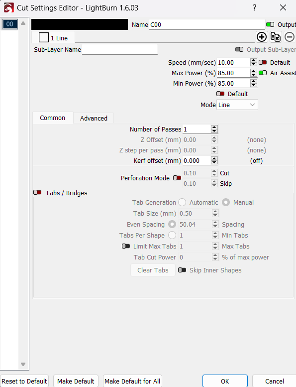

Hello, I replaced my lens and mirrors on my 60 watt co2 laser, run the focus test, aligned mirrors and everything. Run the material test on the 1/4" basswood and it cuts thru using speed of 10in/s and power of 55% and 5 passes. Then bring up my design of three boxes and a single line that cuts the wood in half. However, it only cuts about 75% thru the wood. Does not makeany sinse.

Upload the lbrn2 file with your design so everybody can look into the settings.

Might slow this down.
This is my go to with my 60w co2 1/4 birch ply
Target single pass cut values for your speeds/feeds. You are moving way too fast to effectively cut 6mm stock… You have to give the tool time to do it’s job or work.
Multiple passes increase the likelihood of many issues. A cutter does it’s best work with a single pass.
