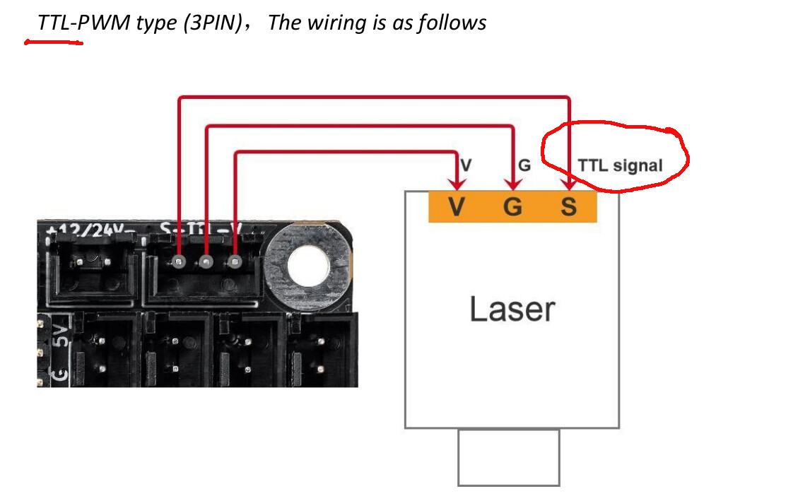

  1. DLC32 not providing TTL PWM

What revision of DLC32 board do you have? Maybe it’s possible that different revisions don’t get you TTL voltages.

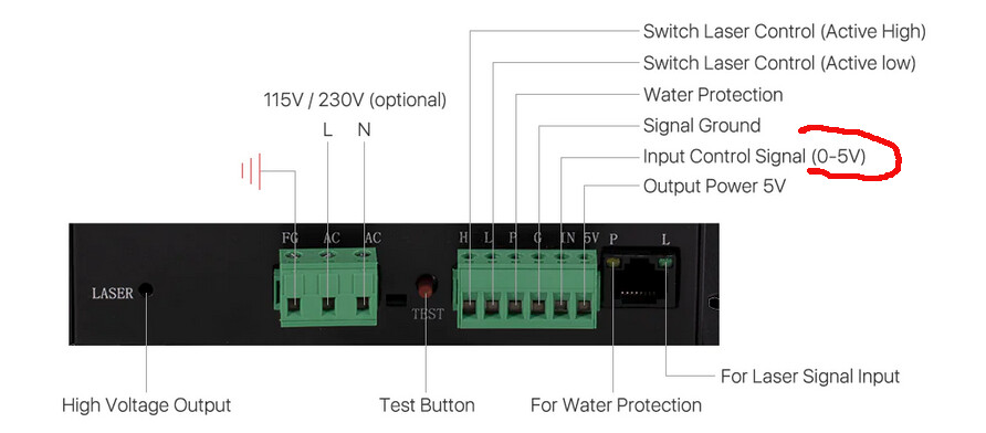

This is from the controllers installation wiring or manual.
These tell you what kind of signal is generated. Notice it’s a TTL signal.
You won’t because this also works with a dc control voltage. The IN takes whatever comes in, pwm or dc, it changes it to a dc control voltage to drive the current limit circits…
This is an 80W lps from Cloud Ray, it’s control inputs.
Keep in mind history. A variable pwm signal is not a cheap thing to produce if all you have is ttl type devices. They previously (some now) controlled spindles with a 0 to 10V, but 5V ttl made that change.
Today the only way to do it low cost is generate pwm via the micro… so it will accept both, at 0 to 5V

If you caught the specification of the input to the lps, it states 0 to 5V which is generally considered ttl.
If he’s reading 3.3V, the best he can get is 3.3V/5V which is 66%.

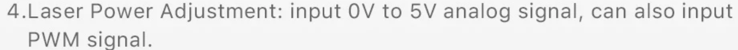

How do you reconcile this statement from LPS documentation?
I took that to mean for analog control.
In post 21 I attached a screenshot that shows that the potentiometer in the LPS can be used to accommodate smaller voltage ranges.

The screenshot was taken from the manual for DY-13 which is the model that he has. Also, it looks like to me that there’s only one adjustment and it’s used for both listed functions. I suspect what they’re saying is that clockwise adjustment increases current relative to input voltage (effectively allowing for lower voltage ranges) while anti-clockwise taps current such that 0-5V is constrained to a lower current range.
I’m not arguing against this in case that’s how you’re interpreting it.
Working fine is one thing. I’m only trying to reconcile the documentation. It clearly states that expected frequency is at least 20 kHz. This is one reason I don’t necessarily trust the documentation when it comes to actual specific behavior.
Indeed I was specifically calling out this point.
I interpret this to mean fairly typical PWM control… absolute voltage doesn’t matter as long as it’s above the threshold “on” voltage and only duty cycle being important for control.
Note that this wording was for a different LPS than the DY-13, however (MYJG-40).
So is there any way to get 5V TTL from the controller or I have to change motherboard!?
What board revision do you have? It’s possible that your board is meant to have 3.3V output.

Makes me wonder why they would have a pot to adjust it down to 2V? I think it’s just a range compression with full left being off (zero resistance) or allowing a 0 to 5V range. Wonder where/why this is there. The originals were only 5V as far as I know.
Do they say in there why you would do this?
