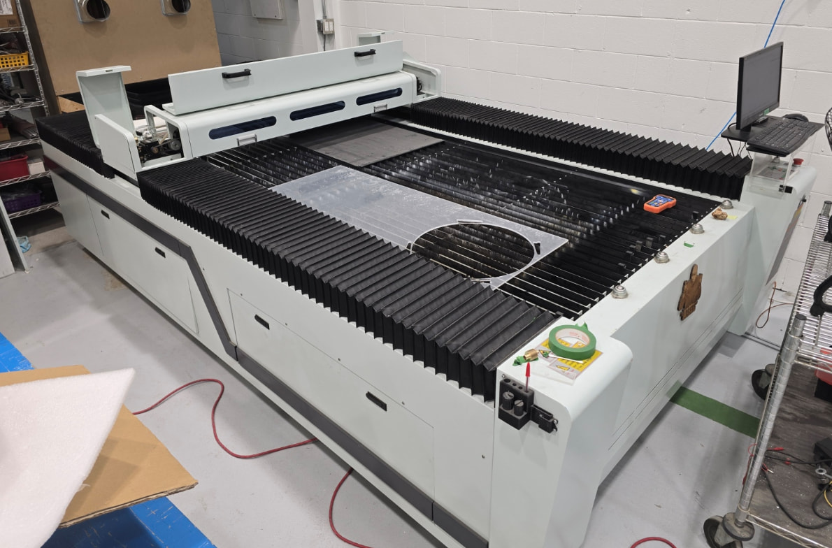

I am contacting you regarding an unusual issue on my CO2 laser machine bought in 2020 and I would appreciate your technical opinion before I continue replacing parts unnecessarily.
Note that I changed my original RECI W8 because I tought the tube was the problem, by a MCWLaser M150 tube and W150 Power supply. I also got another new M150 tube since the seller was suspecting a faulty tube initially.
The problem is mainly an electrical/acoustic instability during laser firing. Sometimes the laser starts and runs normally: the tube is quiet, the power supply is quiet, and output power is good. But 9 times out of 10, or after a few seconds of firing, both the tube and the laser power supply begin producing a noticeable high-pitched / buzzing / crackling sound at the same time. When this happens, laser performance drops. Once the noisy state appears, it does not go away by itself while firing continues. I must stop the laser and restart it, and occasionally it will return to a stable silent state. In some cases, the laser starts silent and stable, then after about 5 seconds the noise appears. If it starts noisy, it stays noisy for the whole firing cycle.

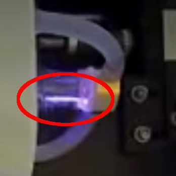

I’m at the same point as you, I also took a look everywhere I can see, light shut down and I was not able to see any arc :roll_eyes:
Right side end of the tube in the video. Plain as day!
Wow, it’s making such an odd sound too. It looks like it’s arcing past the ground terminal and actually hitting the end cap. That is super weird.
I wonder if you have a faulty return cable from the negative side of the tube.
Does it still make that sound if you take your current meter out of the loop?
Right here:
The gas discharge intermittently arcs beyond the tube’s cathode connection to the cooling water cap.
Several problems:
  • The tube cathode connection is intermittent, because it should never be more than a few volts above frame ground
  • The cap should be electrically isolated, but the water seems conductive enough to support the arc
  • The cap should be on the other side of the tube’s hermetic glass seal, but the arc seems to be punching through
The first suspect is the cathode wire, which must be continuous all the way to the high voltage power supply. Most likely, a high voltage arc has burned through the insulation when the connection failed, so you may need to replace the entire run with a solid connection to the HV supply’s cathode wire.
I’d also suspect the HV wiring to the anode, because of all the manipulation going on in there: there may be a second arc between that wire and the frame.
The arc may happen between a wire and the frame, where it is a millimeter long and hidden by surrounding metalwork.
You must extract those wires, carefully examine them for damage, and replace whatever you find with known-good wiring. The arc will carbonize a low-resistance track through the insulation, making the next failure more likely at that point.

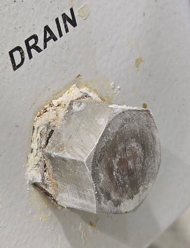

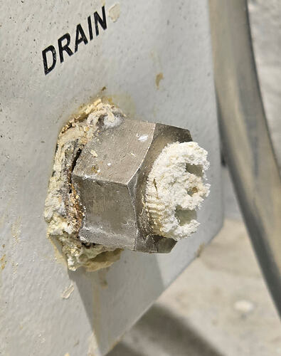

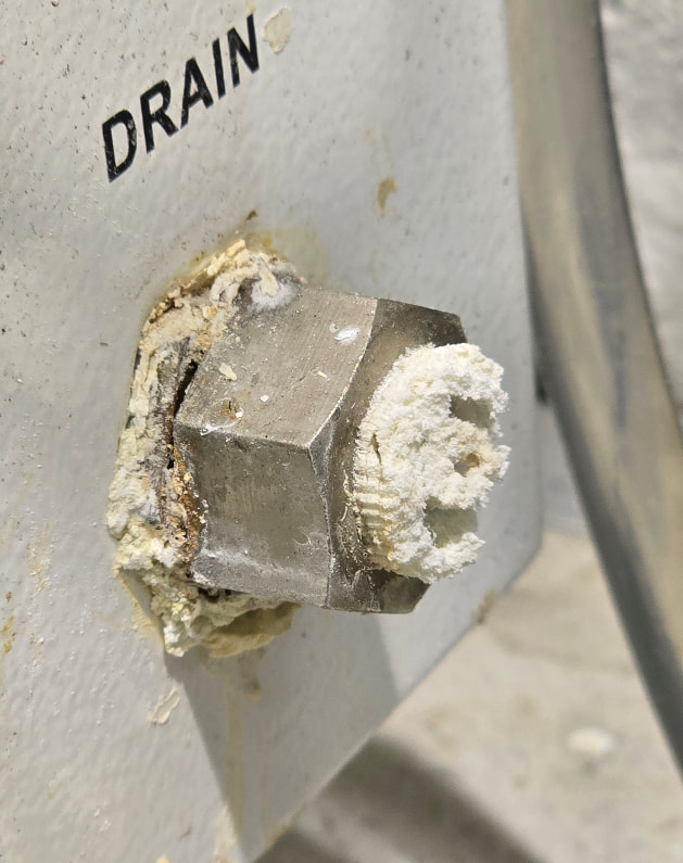

My Chiller is a CW-6000BH filled with demineralized water. I just noticed my drain plug looking like that, minor leak or electrical problem? The ground from the power wire is tested and good.
It might have come out of the jug nice and clean, but after one pass through the chiller it’s thoroughly mineralized. :grin:
Given the undisturbed corrosion on the plug, the water has been in there forever.
However, if that corrosion is new news within a few months, then the arc to the laser tube cooling cap has been driving current through the water and promoting galvanic corrosion inside the chiller. If so, the inside of the heat exchanger has about the same amount of corrosion.
The cooling water loop should be isolated from the laser tube current by a glass wall, so minor differences in conductivity aren’t the problem. The arc suggests a fault in the tube, because it’s punching through two layers of what should be solid glass.
