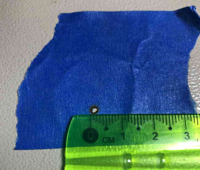

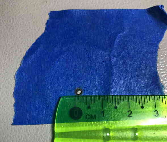

Test for the beam at mirror one, 15% power shows a very round spot. Center just bout burned through the blue tape.
The spot is only about 2mm diameter. Was expecting closer to 6.
Can you take a photo of it so we can see it?
That is what I got. 100W tube, mirror #1. 15% power.
All the information is across the beam itself. If you have a burnt hole you can’t see the information.
Go into the Ruida and set the pulse to 1mS or less and pulse it. It might take a few pulses to mark the tape.
We want to see if the tube is in resonance or how the power is distributed across the beam itself.
