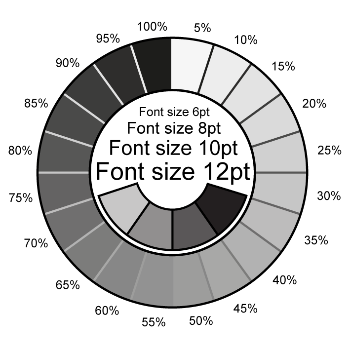

If you’ve run any other SM module before, you’ll find it just as intuitive. I normally use the 20w and the 2w is a really nice module to use and you can play with the Line interval effectively.
This power/speed test is very useful:-
While you’ll have to experiment of course, I find a good baseline for metals is to start around 1500-2000mm/min speed, 100% power, and about 0.05mm intervals.
For plastics, like black PLA/PETG, it’s MUCH faster. I use 6000mm/min with only about 40-45% power.
