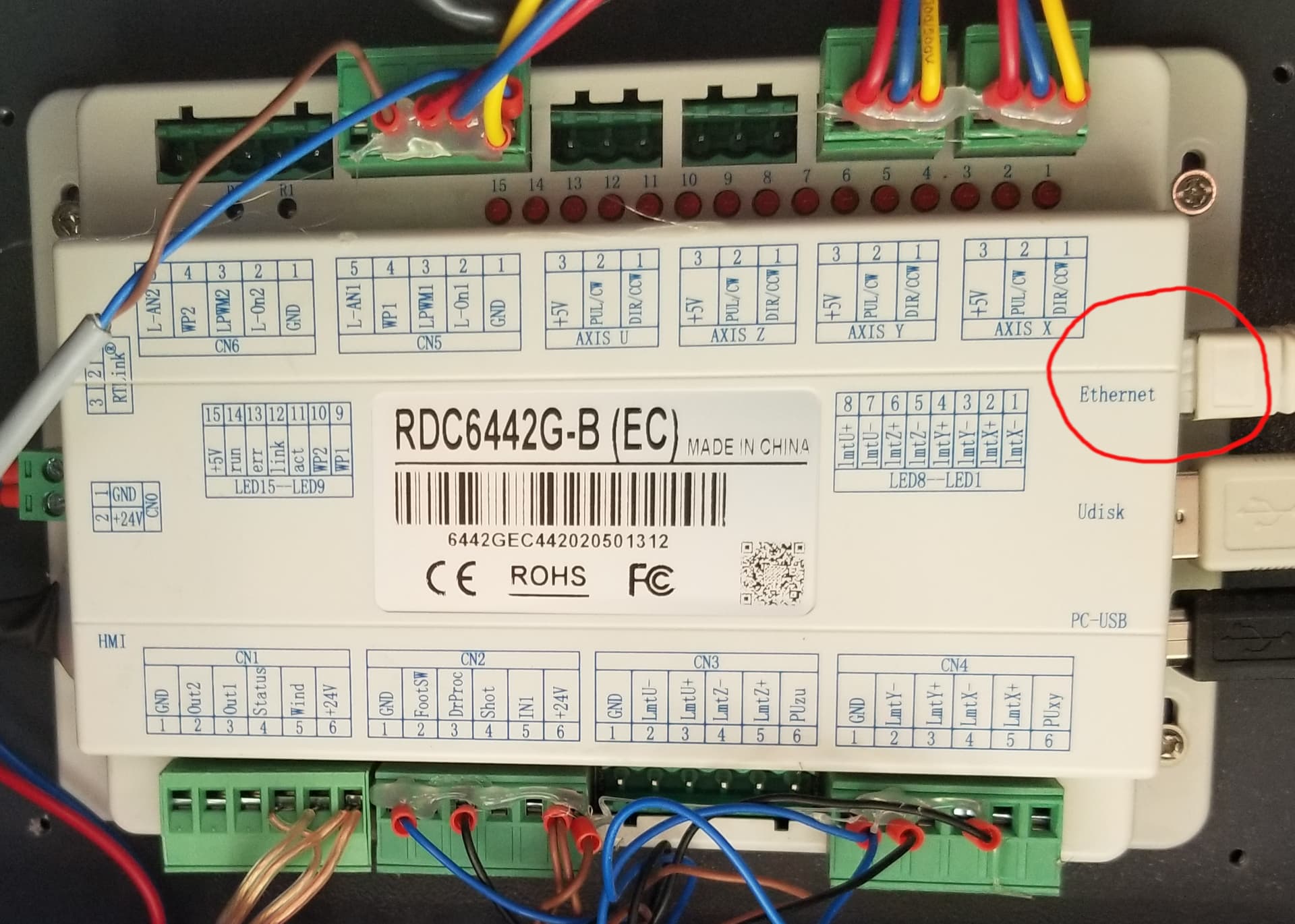

I’m trying to connect my laptop with Lightburn to a Boss LS1630.
How is this done?
jkwilborn
(Jack Wilborn)
September 17, 2025, 6:27pm
2
It says it will run Lightburn, so it’s likely a Ruida controller.
These can usually be wired via usb or Ethernet. I suggest Ethernet if you can, much more dependable.
You’ll have to get the trail version, but in the end, you’ll need the pro version for a dsp type (like a Ruida) controller.

As @jkwilborn observes, you’ll bypass a world of USB hurt by using Ethernet:
If you’re plugging both the laser and the PC into an existing LAN, then take care to assign the laser’s static IP address outside the router’s DHCP address range to prevent another device from clobbering the laser’s packets.
Some previous discussions explain why USB is a terrible idea and covers IP address issues:

Thanks for the replies. I don’t see an ethernet port on the laser, so I’ll have to try USB
jkwilborn
(Jack Wilborn)
September 17, 2025, 9:30pm
5
There must be some way to talk to it, or it’s pretty useless.
Look inside the electronics cabinet and see what kind of controller it has.
