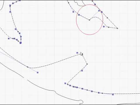

Hi, here is a new try with the file - I say new because I dont want to fiddle with the one I spent so much time getting to work. But , this is doing the same thing.
  1. I imported customers picture and traced… (Great whizzo gadget there… I need more practice to get better with it tho. )
  2. started to node edit in similar place to original file that prompted my post. See red circle… two nodes that were once a continuous line that I now cannot join.
  3. Shift select to get both lines selected and then activate the node edit button. The nodes respond but will not join. ‘Grouping’ doesnt (obviously) make the 2 lines compatible - as the nodes do not become visible when Node edit button is selected. - I assume that when the 2 lines are selected as well as the Node button and the nodes are visible and active - they should respond to commands… such as ‘Edit - close path’. It (edit - Closr path) is not greyed out - so why does it not work. ?? I understand this issue in Corel… one has to ‘combine’ the two lines (not ‘group’) so that they will be compatible and can be node edited, but I see no such item or available command to make the two lines compatible again.! They were once the same line anyways.

I had no issues with this. I went to Edit nodes, grabbed the end of one line and dragged it over to the other one. They joined immediately, as did the other gap.
ummm… great. This does not work on my system… Nodes never join in this way. It must be ‘edit’ - Close path… which works on occasion. Is there some background setting or snap option I have to set?
Thanks for the reply
Do you have your object snaps disabled in the settings?
Hi, Yes… it is off. I have turned it on and .Hey presto. It joins nodes. Will experiment. I generally have ‘snap to’ options off in all my software as I find they tend to snap to stuff i dont want. (i.e. Let me control the thing - and I’ll tell it what to do thanks. ") Hope this continues to work. And perhaps others with the same issues can get any easy fix like this. Thanks again
Press Ctrl to bypass snapping if it gets in your way. Most of the time it’s really useful, and some things like this are governed by it. I could make it ignore the snap options in node editing, because they’re pretty important there, but in general, since it’s trivial to bypass them with the Ctrl key, it didn’t seem necessary.
