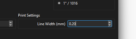

In LightBurn 2.1 RC you can set the print Line Width in the Edit > Settings > Import/Export tab
Find that here: LightBurn 2.1.00 Release Candidate – LightBurn Software
Sorry, I should have remembered that this is now possible.

I tried your suggestion, but it is only allowing me to key in a value to 2 decimal places. I cannot get it to work correctly with just 2 decimal places. I think for a Universal Laser Systems UCP software, the value would be 0.0254
If I set the value to 0.01, and print to a PDF file, I can then send the PDF file to the Universal Laser Systems UCP software, and it works :slight_smile:
Can that field be updated to 3 decimal places?
I’ll make the internal feature request for that, no problem.

This is very exciting. I tried to grab the latest RC, but it wasn’t available (RC3), but I grabbed and installed v2.1.00-RC-1 and I see the option and set the value to 0.02 (the ILS documentation says the line has to be 0.0254mm or thinner, so I figured 0.02 should work) however, it looks like the actual line width in the print file generated is wider than that. My best guess is that it’s coming out closer to 0.16mm in width.
It might just be an issue with RC1, but this is a really exciting option if it works!
Steps to reproduce:
  • Open LB RC1 and select Edit > Settings > Import/Export > Print Settings: Line Width(mm) value=0.02 or 0.01 and click Ok
  • Draw a square with the Create Rectangle tool
  • Select File > Print (Keep Colors)
  • Print to UCP control panel and test cut, OR alternately, print to PDF and analyze the line width in another program.

I think it’s great to get it extended to 3 decimal places, 100%. I guess my thought though is, if the UCP documentation for the Universal laser system says that the line width has to be 0.0254mm or thinner to be considered a vector cut, and I set it to 0.02 or 0.01 in RC1 version of LB and it doesn’t look like it’s being interpreted as vector because the line width isn’t thin enough, doesn’t that mean there’s an issue or am I thinking about the wrong thing here.
You bring up a good point. I guess I should have said 4 places instead of 3 places.
If @Colin needs help testing this with the UCP software, I can do it.
