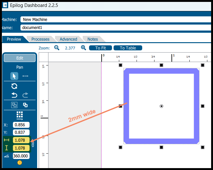

I also tested the Print (Keep Colors) with the Epilog Dashboard software using a Line Width of 2mm, and it also created the 2mm wide line width.

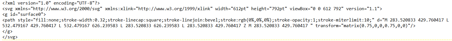

RC1:
<?xml version="1.0" encoding="UTF-8"?>
<svg xmlns="http://www.w3.org/2000/svg" xmlns:xlink="http://www.w3.org/1999/xlink" width="612pt" height="792pt" viewBox="0 0 612 792" version="1.1">
<g id="surface0">
<path style="fill:none;stroke-width:0.32;stroke-linecap:square;stroke-linejoin:bevel;stroke:rgb(0%,0%,0%);stroke-opacity:1;stroke-miterlimit:10;" d="M 283.520833 429.760417 L 532.479167 429.760417 L 532.479167 626.239583 L 283.520833 626.239583 L 283.520833 429.760417 Z M 283.520833 429.760417 " transform="matrix(0.75,0,0,0.75,0,0)"/>
</g>
</svg>

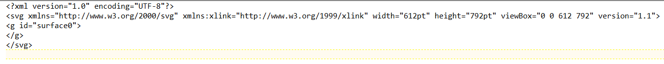

RC2
<g id="surface0">
</g>
</svg>

Sorry, not really sure how to paste in code in this forum and have it show up properly. Let’s try screenshots.
RC1
RC2
@Brinohm I am using RC2, and it is exporting larger line widths correctly. I tested it in both the UCP and the Epilog Dashboard. I also engraved the test I did on my VLS6.60 and it rastered at 2mm, which was correct.
I am reluctant to use a PDF driver to verify line width. I did a bunch of tests exporting to Microsoft Print to PDF at different line widths in LB ( smaller ones below 0.05, and they all came out to be .75pt.
But, it was correct in the PDF file when I set the line width to 2mm in LB.

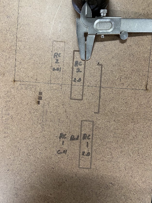

@Colin and @RalphU I can confirm that wider widths seem to raster correctly in RC2 and RC1 (see picture). I used a 2mm width and it looks to be about 2mm. However, when we think about the precision associated with the thin lines vs these thicker lines. Running a test of say 2.02mm and 2.00mm would be extremely hard to distinguish given the kerf.
The 0.01mm lines in both RC1 and RC2 are rastering, which means the print job is ending up with a line width that is wider than 0.0254mm. I was able to create a print driver which dumps the raw ILS 12.15 print job to a file and a print driver which pulls the raw output from the Lightburn Print function to a postscript file. The output from RC1 has a line width being specified for thin lines,

To help clarify how to read the output from RC1 for thin lines, The line width is set by this part:
0.16 sw
In most PS prologs, sw is a shorthand for setlinewidth, so it’s 0.16 in the current user-space units at the moment of stroking.
Because there is a scale transform right before ([0.75 0 0 -0.75 0 792.000122]++), that width gets scaled too. So the effective device-space linewidth is:
  • 0.16 × 0.75 = 0.12 (in default PostScript points, that’s 0.12 pt)
  • 0.12 pt = 0.12 / 72 in ≈ 0.00167 in (≈ 0.042 mm)
So it’s effectively getting a line width of 0.0420mm > 0.0254mm and ends up rastering.

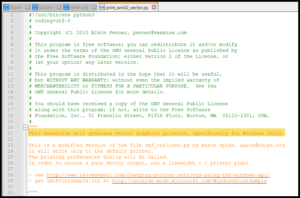

@Brinohm and @Colin
Inkscape will also send everything to the Universal Laser Systems UCP as raster if you just use their print dialog. But, If you use an extension under export called Win32 Vector Print, it sends the data correctly to the UCP.
Here is the python script that Inkscape uses for printing to the Universal Laser Systems UCP
Location of Python script on a Windows computer is:
C:\Program Files\Inkscape\share\inkscape\extensions
I am using the latest version of Inkscape 1.4.2
From what I have found, in order for it to work correctly, LB would have to use the Windows GDI -Win32 app below. I am assuming that LB is not using this app for printing.

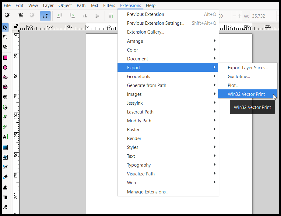

That’s interesting. In my experience with Inkscape and sending to the UCP, as long as the “Stroke Style” width is set to “hairline” it is interpreted as a vector cut by the UCP. I’ve not needed to use an extension to get Inkscape to work personally.
That doesn’t work for me on the latest Inkscape version. When I set the stroke width to hairline, and File>Print, it comes out raster in the UCP.
When I create a 2mm RGB red line in Inkscape, it comes out 2mm wide black raster in UCP.
When I create a rectangle that is RGB red and 0.0254mm and use the Win32 Vector Print extension, it comes out as vector red in the UCP.
