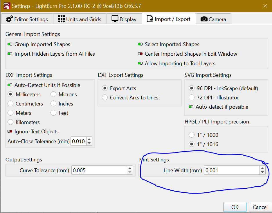

  1. Set Print Line Width to 0.001mm

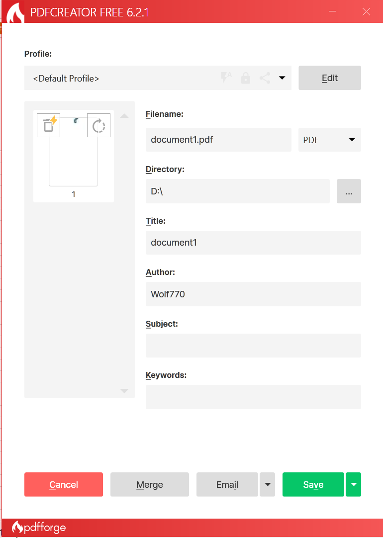

  2. Install PDF Creator free PDFCreator – Fast, Reliable PDF Conversion Tool
    I´m testing with Default Profile.
  3. Lightburn Print (Keep Colors) and select “PDF Creator” printer
4.You can edit, automate print jobs, auto-open print folder and a few other options.

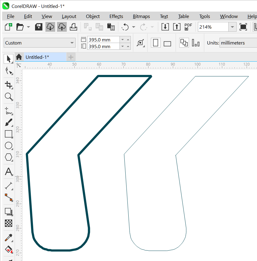

  1. A preview on CorelDraw 2024:
    Left - Microsoft PDF
    Right - PDF Creator

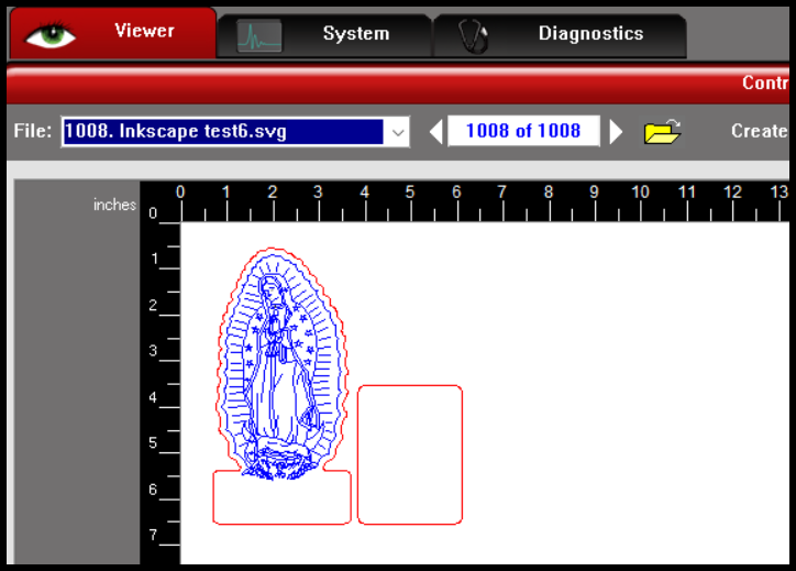

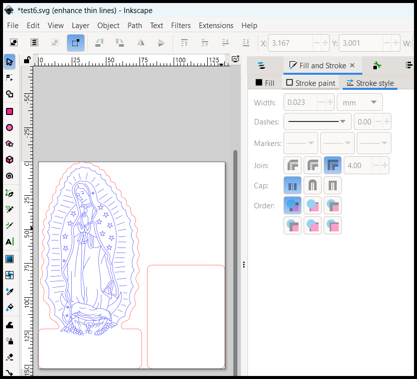

If LB is unable to resolve the print keep colors output like I described above, an easier solution would be for LB to allow the user to set a LineWidth for SVG exports, which is “stroke-width” in SVG files. Currently, LB outputs a stroke-width of 0.008333mm (in the Pre-Release LB).
If LB had a value in the Prefs.INI for SVG stroke-width, and the user could set it to 0.001mm, then you open the SVG file in Inkscape, and select Extensions>Export>Win32 Vector Print. It automatically sends it to the ULS UDP software.
Below is a test SVG file that I exported from LB, and opened in Notepad++, and changed all values of 0.00833mm to 0.001mm
H
I then selected Extensions>Export>Win32 Vector Print
Here is how it looks in the ULS UCP software. Select the material I want and then select OK
Ready to send to the laser
