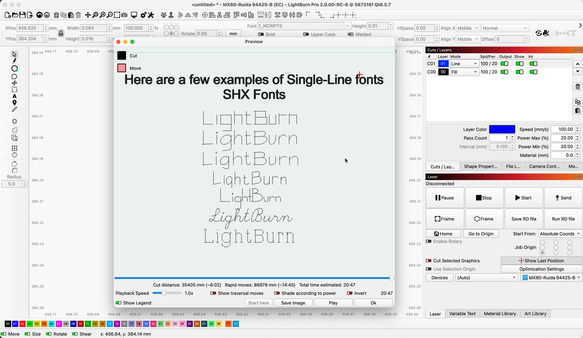

Here I show a few SHX fonts I have installed on my setup.
