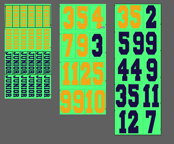

I have some updates. First, I have attached screen shots of the art I am referring to(see graphic 2). The art board’s are 23.7 wide by assorted tall. Ranging from 48.7 to 66.8
I think this is an art board size issue, but I do not know what.
Here is what I came up with from testing further. This is the short version and a workaround solution.
In the images you see the Numbers and the thin black lines are the cut paths around them(see graphic 1). The 2 squares are the reg marks used for this testing.
When copying (and Pasting) into LB from this main art file(see graphic 2), the 10x “glitch” takes place.

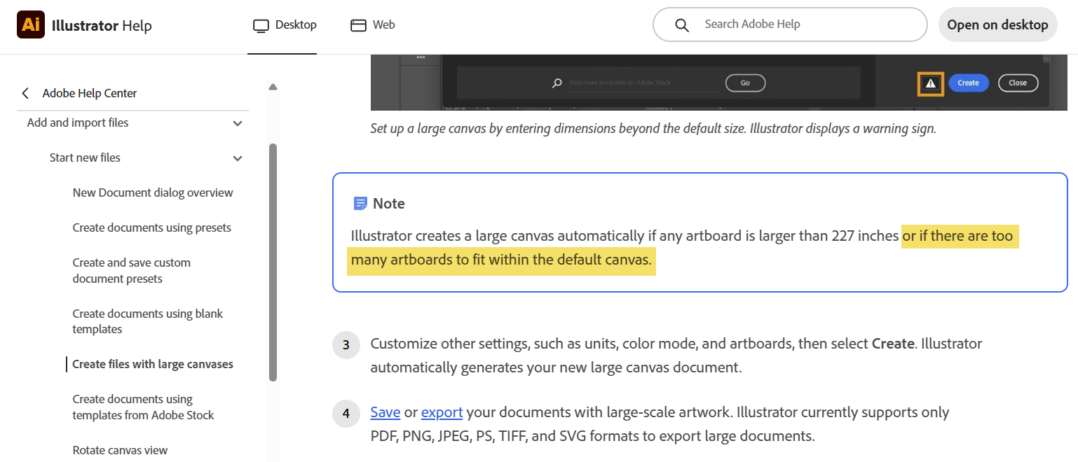

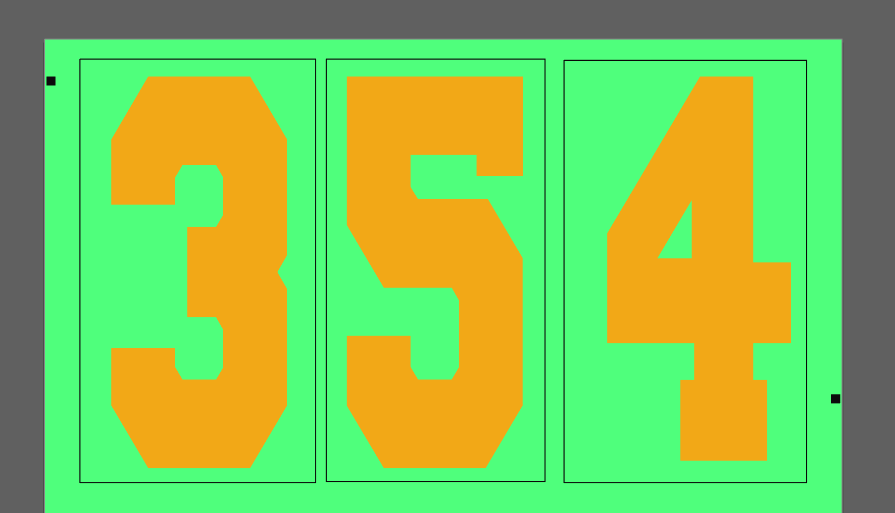

Create a new illustrator file, with 1 art board of small size (13x15 in). Paste the same cut paths from the original file into that new illustrator file (instead of LB), then highlight and copy from that new file. (this is all the exact same thing from the original just pasted into a file with a single smaller art board). Once it is copied from the new file, pasting into LB maintains the correct dimensions.
You can copy and past the entirety of the cutting paths from the original Ai. file to the new Ai. file and the copy/paste to LB maintains correctly(see graphic 3)

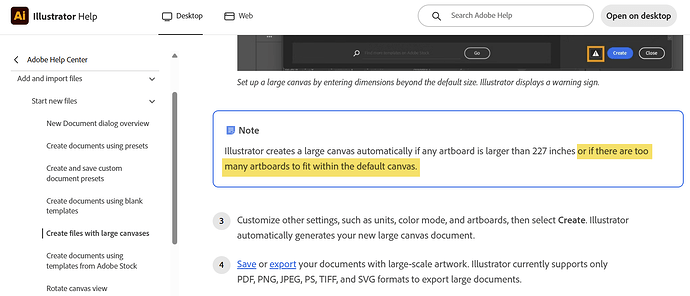

Please let me know if I explained any of this badly. I have no idea what could cause this (maybe the size forces Ai. to add a x10 to the SVG copy file??)
@NicholasL - I think the large art board thing is cumulative and not individual. Meaning me having many smaller art boards still hits the overall size issue and causes this problem.
@Ron- all my cut lines were on the same layer as well, but the file itself had multiple. Due to the testing and resolution above, I think this an Ai. Sided issue with large art board file handling causing the error.
