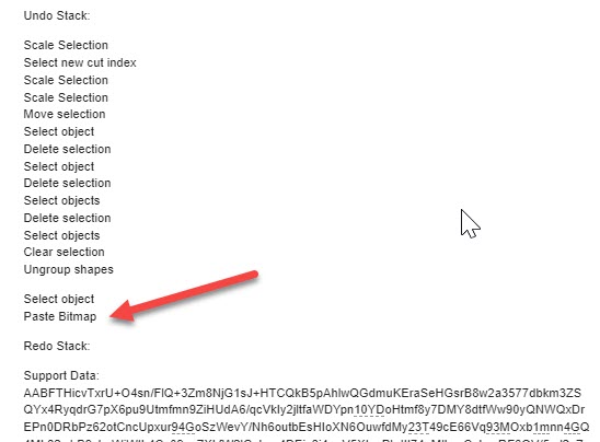

Crash Log Stack Trace for LightBurn v1.4.00:
QActionPrivate::setShortcutEnabled
QAction::setEnabled
EditWindow::~EditWindow
EditWindow::vector deleting destructor' QObjectPrivate::deleteChildren QWidget::~QWidget QWidget::vector deleting destructor’
QWidget::~QWidget
_C_specific_handler
_TypeMatch
is_exception_typeof
_CxxFrameHandler3
_GSHandlerCheck_EH
_chkstk
Undo Stack:
Scale Selection
Select new cut index
Scale Selection
Scale Selection
Move selection
Select object
Delete selection
Select object
Delete selection
Select objects
Delete selection
Select objects
Clear selection
Ungroup shapes
Select object
Paste Bitmap
Redo Stack:
Support Data:

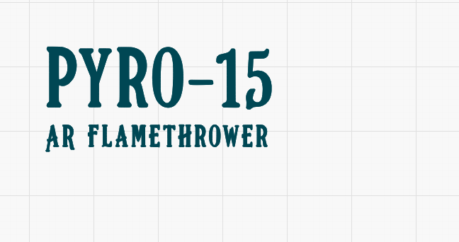

no its a small text logo here is a snippit of the file
Capture

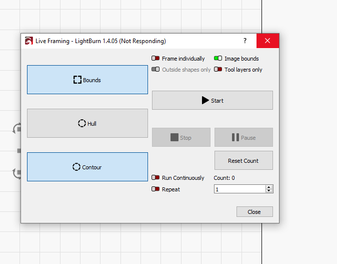

sorry about the long wait, this computer is in the factory. I will attach the light burn file as well to see if you can recreate the problem.
open file
click on one image
click frame
crash happens when I am picking between Bounds and contour
This is the easiest crash to reproduce and happens with in a few click between them or happens on the first click; seems random but will always happen.

yes. This happens on all versions so far.
I click once on the fame then it froze. all my other programs work flawlessly.

The file you provided has two groups of closed shapes that look like text. The shapes are built perfectly - Seriously… this is one of the cleanest files I’ve seen in my time here. Well done.
I noticed that there isn’t an image in the file.
Your Live Framing in post 7 is set to frame to Image Bounds.
The crash log you provided in the first post shows me a comment about a bitmap - which is an image.
2024-01-11 123359 Paste Bitmap
Bitmaps can get big enough to push system memory to its limit. It could be maxing out memory but I’d have to look.
