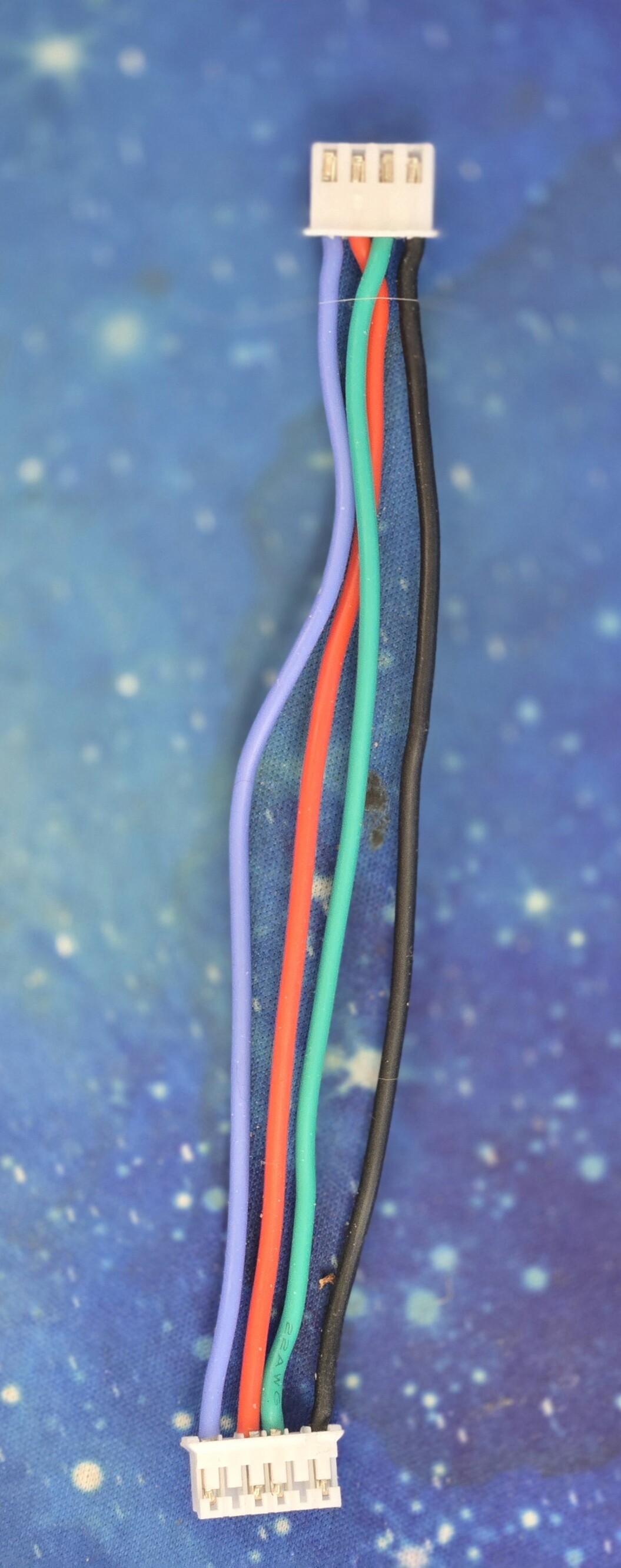

After much struggling I discovered that I needed an adapter cable and crossing the 2 middle wires on the 4-pin cable. The Creality stepper motor was a 6 wire motor using a 4-wire cable.

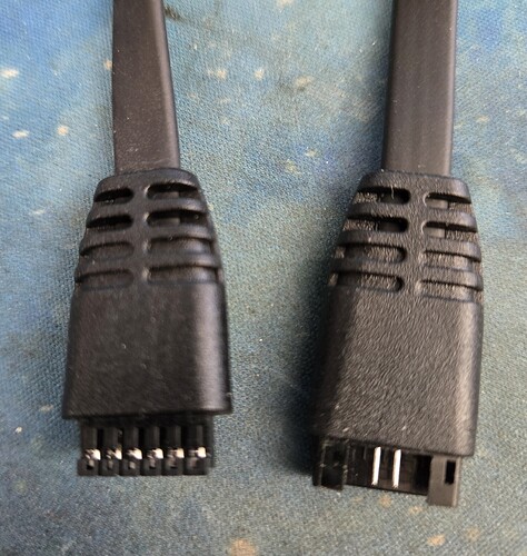

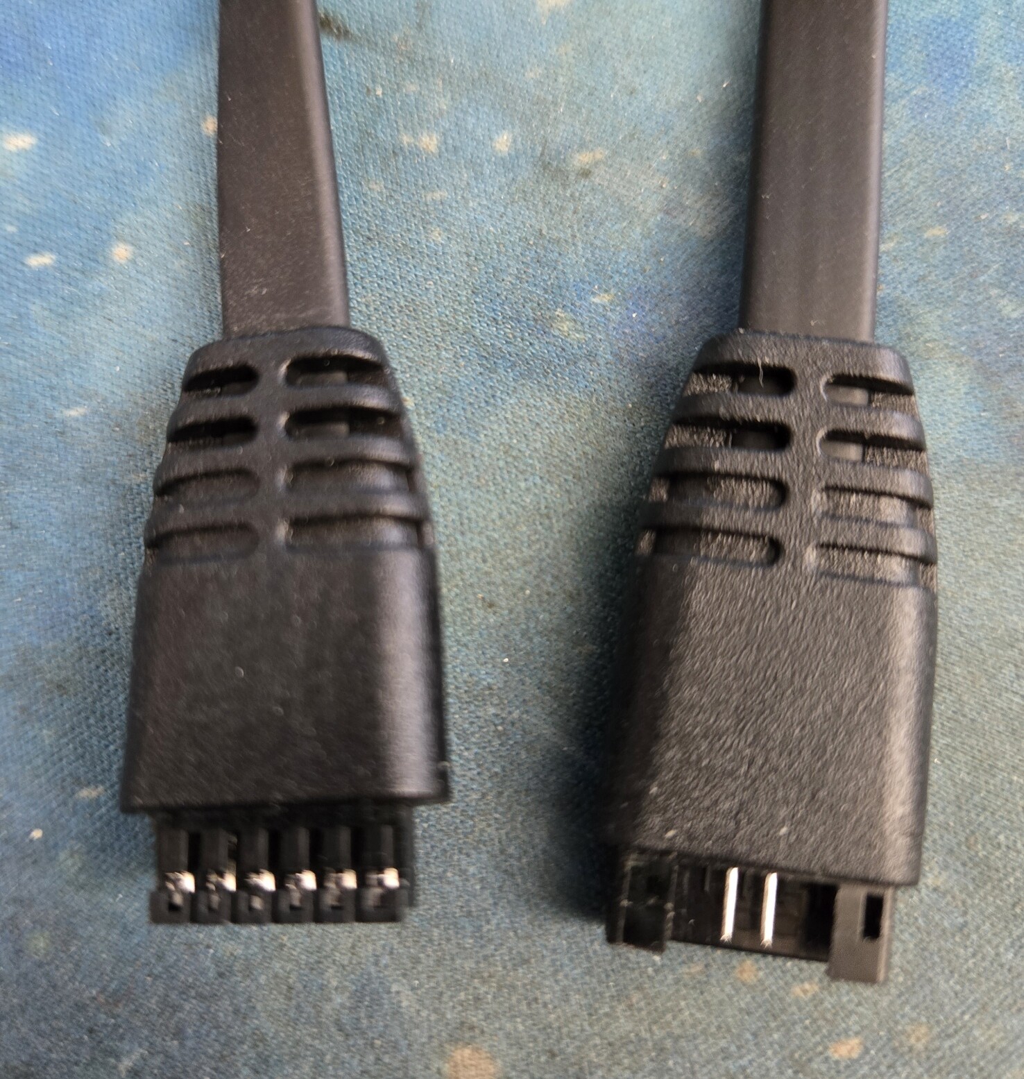

I am in the process of trying to use the Creality Rotary with an OMTech K40+ CO2 laser. I have been able to get the Y axis with the rotary attached byt the X axis interacts with the y axis. I have tried all sorts of iterations of the wiring, including reversing the two center conductors. I have been trying to pinouts from both Creality and OMTech and it’s like pulling teeth. Any suggestions?
