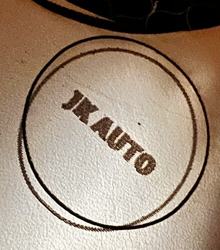

I’m using a Fox Alien 4040XE with the Fox Alien 40watt laser and lightburn to run it. I’m trying to engrave some hat patches and then cut them out. It seems to fill everything correctly but then when it goes to cut the line it’s skewed up and slightly to the right. My x and y axis are square. My belts have good tension. I slowed my speed down to 1200 at 30% power (I’m engraving very thin leather). I checked what I’m assuming are my PMW settings for the x and y axis and both are set the same. I’ll try to add pics of my current settings and the project.
It appears to me that the fill layer is shifting left as it moves up. The vertical lines of the cut layer (I assume) appear to be in line with one another, although they don’t seem to produce what I would consider a usable patch. Is there a third, complete, circle in the design? Also, the arcs appear to be slightly distorted, pointing toward something mechanical. Most likely a pulley on the x axis of this is run in the pictured orientation.
I apologize I should’ve rotated my photo. I started in the bottom left corner. The fill went first, then the half circle outlines, then it was going to have a final circle cut but I shut it off on this run since it was already messed up but on other runs the Final Cut is off too.

The back-and-forth motion during engraving is very well controlled, in contrast to the abrupt direction changes in vector layers. Assuming you’ve removed the last bit of slack from the machinery, what’s left is excessive acceleration.
That makes sense, because the machine is slinging a relatively high power laser head, which means a heavy laser head. Although it has two Y axis motors, the additional weight may be more than it can handle.
The Machine Settings show 300 mm/s² acceleration for both the X and Y axes. Reduce the Y axis acceleration by a factor of four:

Okay so I changed my $121 to 75 and nothing changed. Then I changed my $120 to 75 and it did change but it’s still not correct. I’ll add photos.

Both of those “circles” are so far out of round that there is something badly wrong with the mechanics; this is not an acceleration or “losing steps” problem. You should return both acceleration values to 300 mm/s².
It is helpful to orient the pictures in the same way as the LightBurn design, because the direction of the errors is critical to figuring out what’s wrong. Take the pictures from directly overhead, so that the image isn’t distorted by the perspective angle.
Until you get this sorted out, use cheap material like cardboard and reduce the power until the “cut” layer is just marking the surface, not cutting all the way through.
Using the simple JK Auto design with just the outline, lettering, and engraved circle, run a single pattern (not the whole sheet) and take a picture to show the results.
