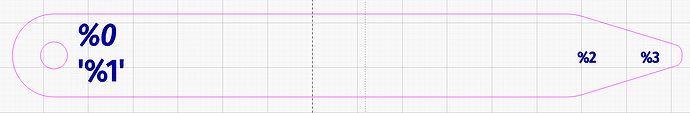

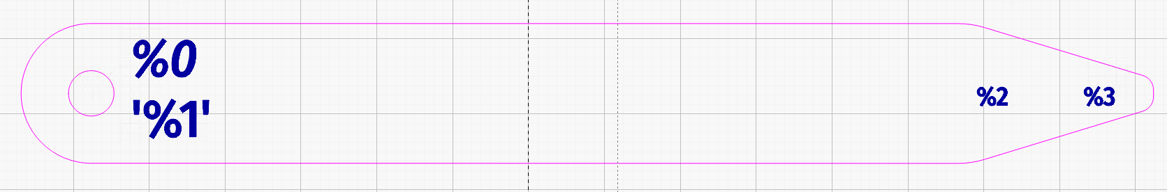

Draw a shape you like:
That started out as:
  • A big circle over on the left
  • A rectangle from the middle of the big circle to the taper on the right
  • A little circle over on the right
Select them all, create a Rubber band outline around them, Radius the corners a bit, then add the little circle at the middle of the big one.
Put Variable Text fields where they’re needed and arrange the text file to look like a CSV file (if it’s not already).
Use the Grid Array tool to make a bunch of copies with the fields incrementing as needed:
Set the Fill (for text) and Line (for cutting) layer parameters to match the material, then Fire The Laser:

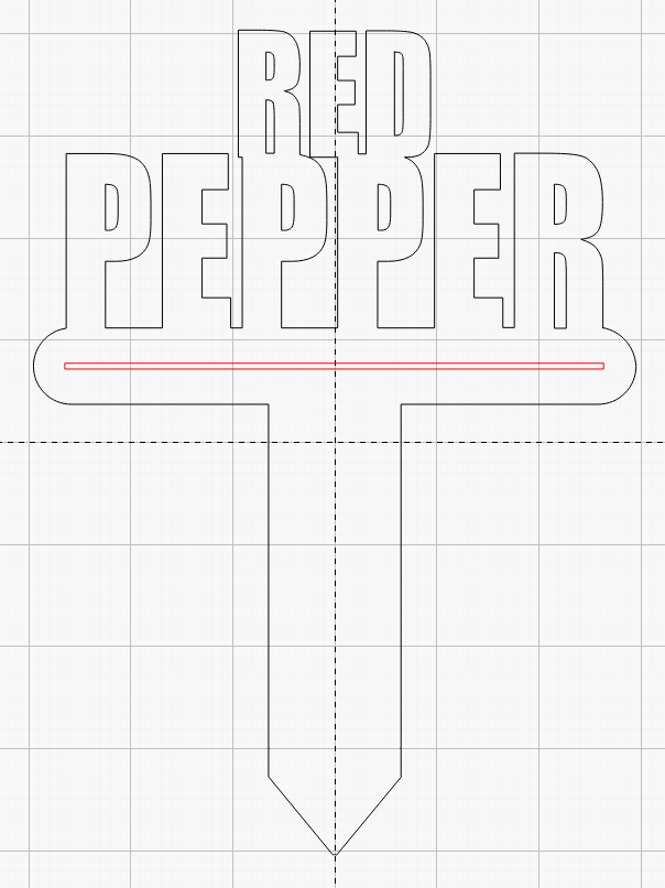

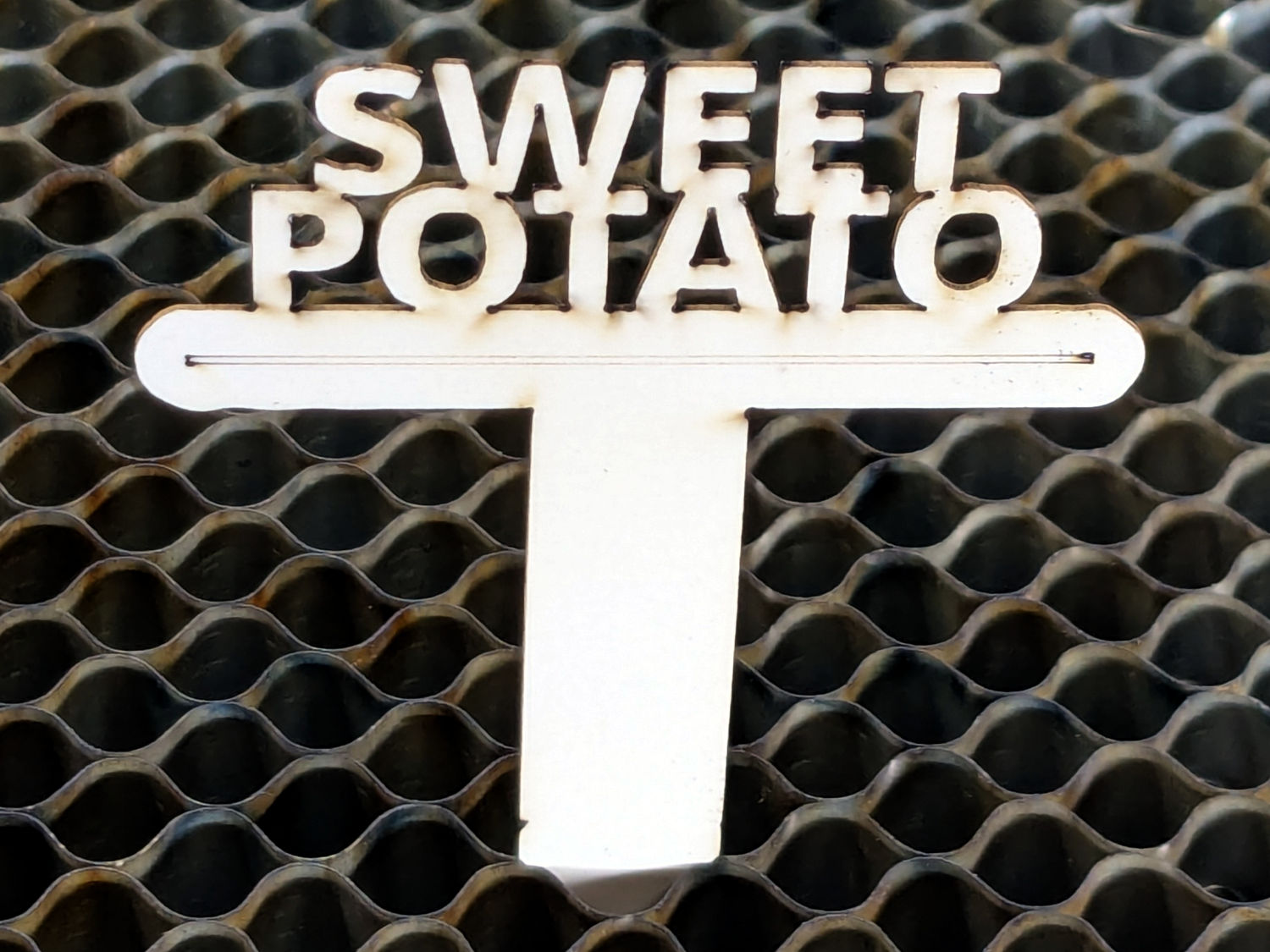

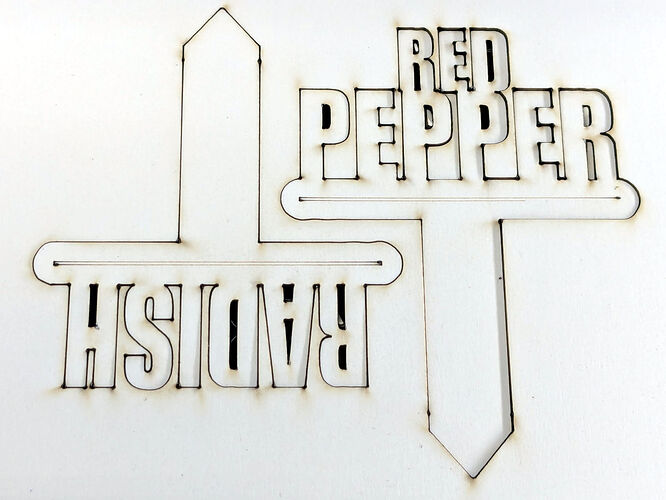

They’ve done all the hard work for you, so it’s a lot easier than I thought: that gray outline is the cut, leaving the letters standing in silhouette something like this:

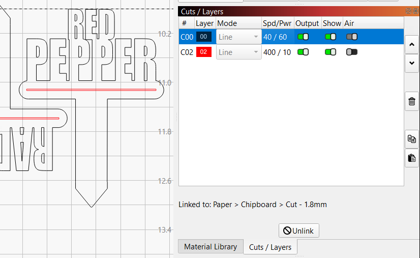

Import the SVG into LightBurn, which automagically assigns the gray & red shapes to separate layers:
I have Material Library entries for chipboard, so a couple of clicks assigns the cut & mark settings to those layers. If I had a little less blood in my caffeine stream, I’d have put the cut layer last …

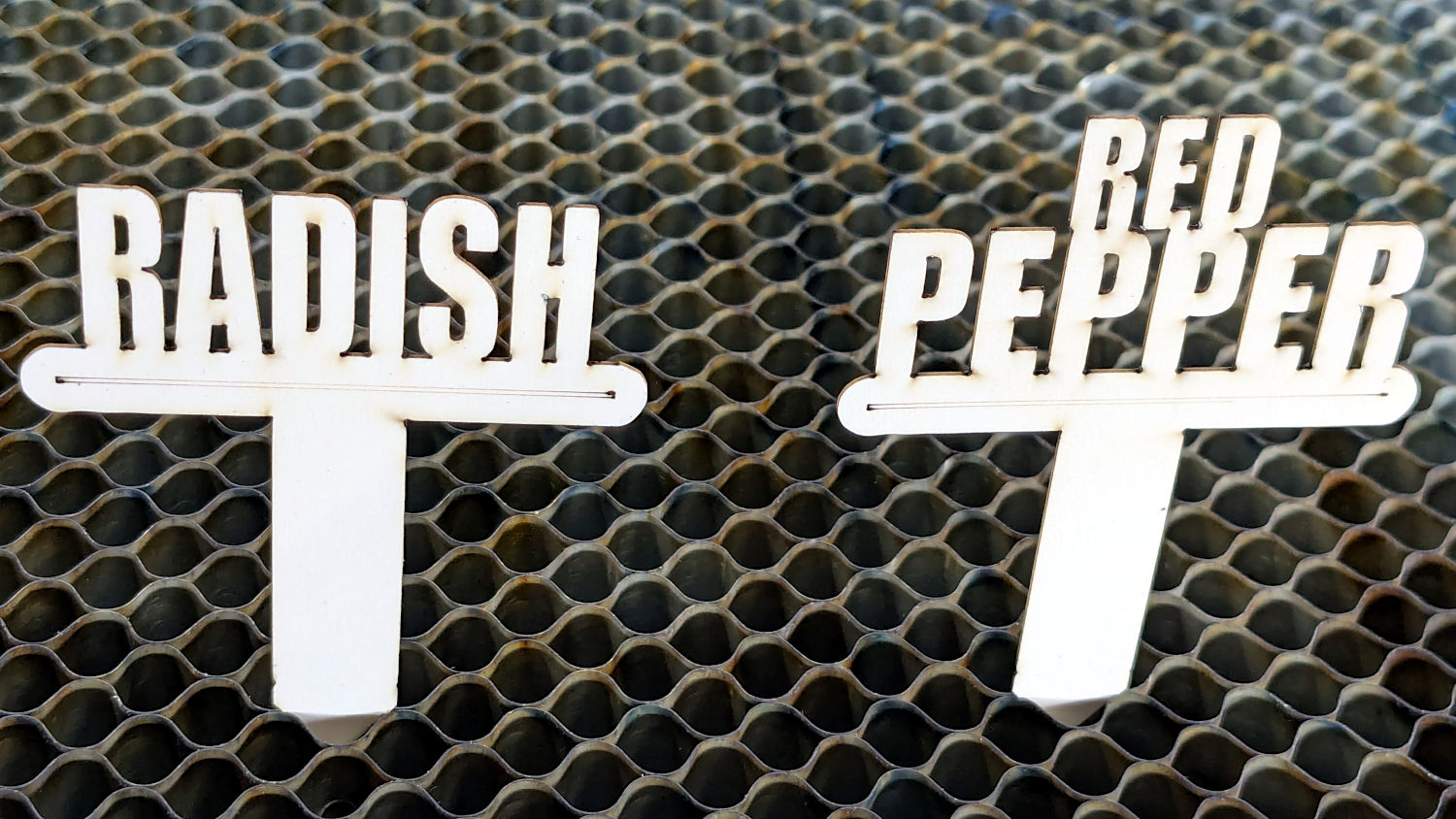

Slap something on the platform and Fire The Laser:
They fall right out, stand up tall, and look pretty good:
The settings need fine tuning to improve the horizontal mark, but that’s the general idea.

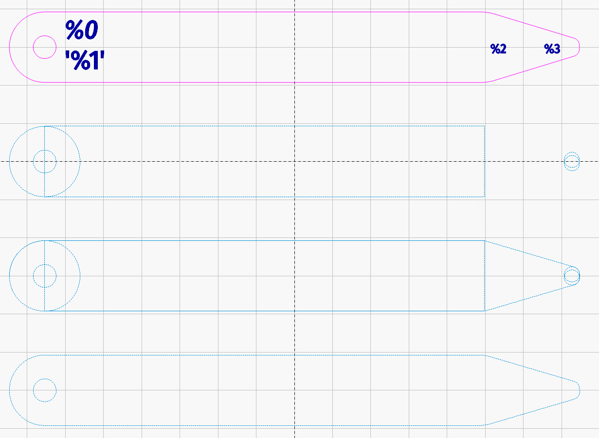

The overall layout:
Trolase large markers - CSV template.lbrn2 (1.7 MB)
The CSV file to fill in the names:
Perennials.csv (1.6 KB)
The shapes creating the tag looked like this:

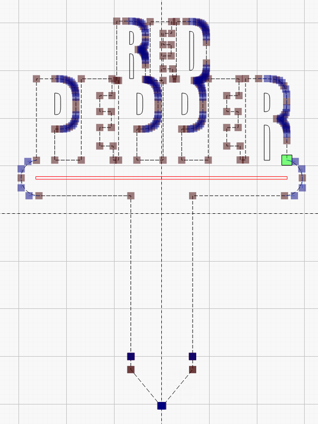

Start with one of their tags, which you must Ungroup from the rest because the SVG imports as one huge group:

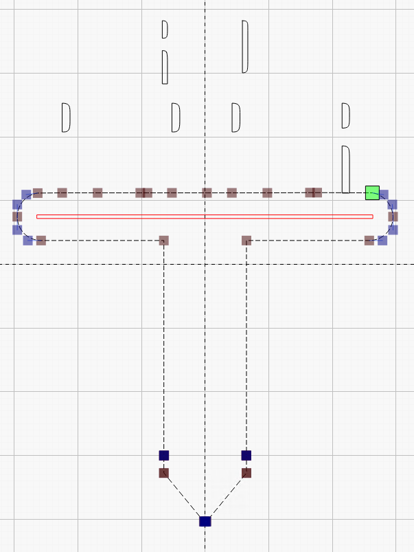

Use the Edit Nodes tool to show all the nodes around the perimeter:
Drag-select a rectangle around the letters, but not the top of the T-shaped base, then hit D to delete them:
The interiors of some letters remain behind, so get out of the Node Editor, drag-select around the junk, and hit Delete.

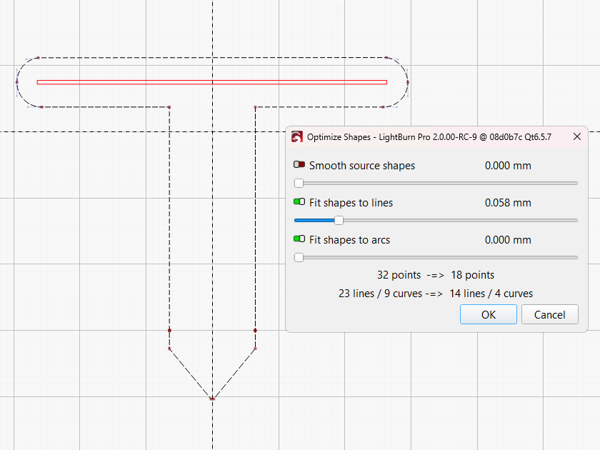

Click to select the T shape, then use the Optimize Shapes tool to tidy up the top line of the T:
You’ll want to Duplicate that shape and move the dupe off to the side so you can use it for the next tag.
Now, the magic happens … :grin:

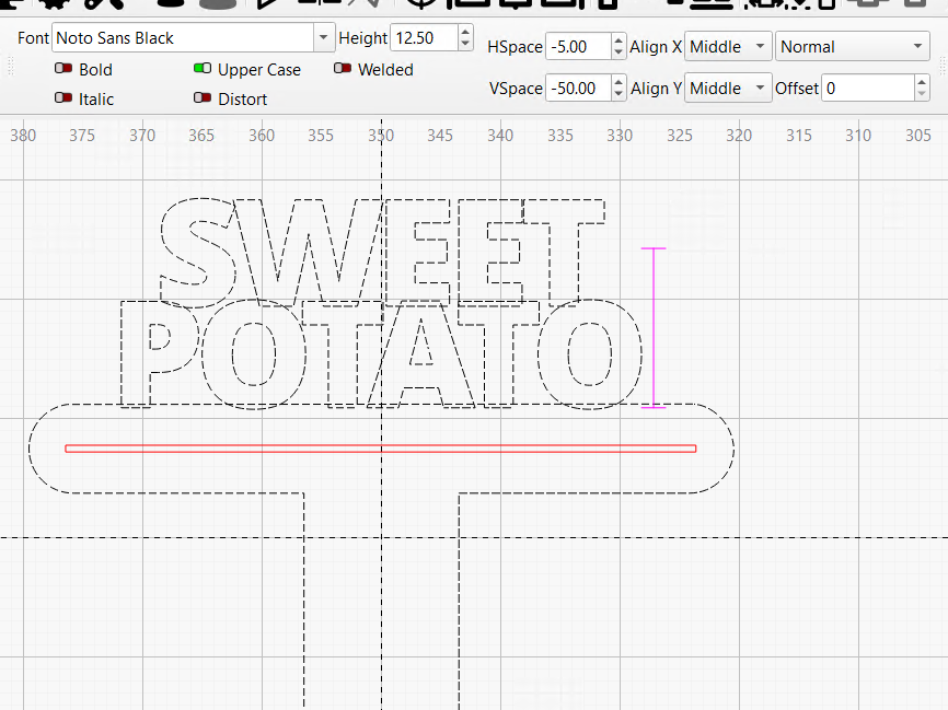

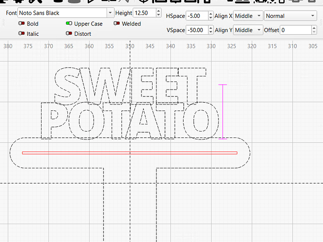

Use the Text tool to start typing letters. Choose a chonky font, turn on the Upper Case switch (this is no place for ascenders & descenders), and Name That Plant:
Adjust the Height value to make the lower word wide enough to fill the T.
Reduce the HSpace and VSpace values to mash the letters together with plenty of overlap, because otherwise they’ll fall apart.
When you’re happy, get out of Text, Align the text block over the T, and move it down enough to overlap the T.

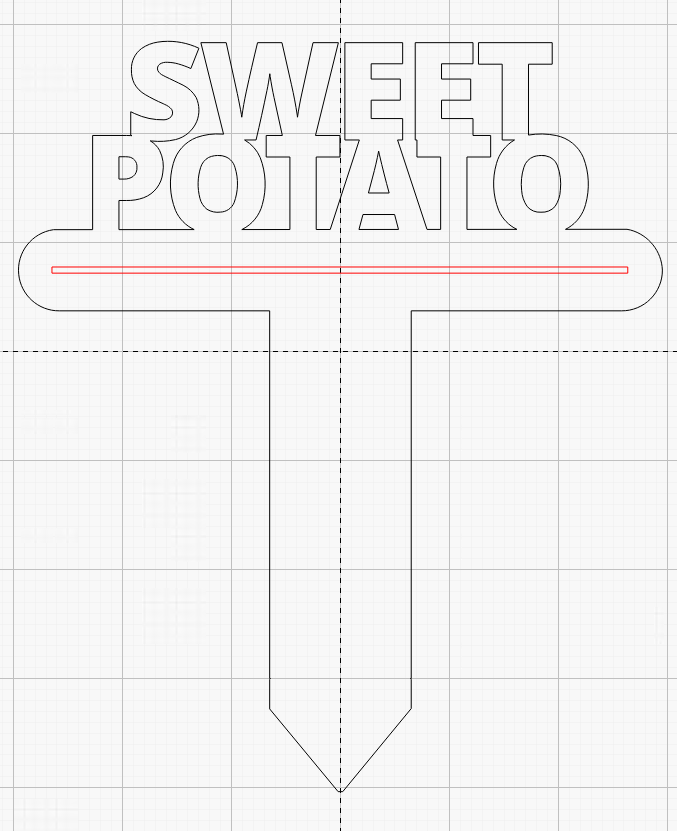

Select both the text and the T shape, then Weld them together:

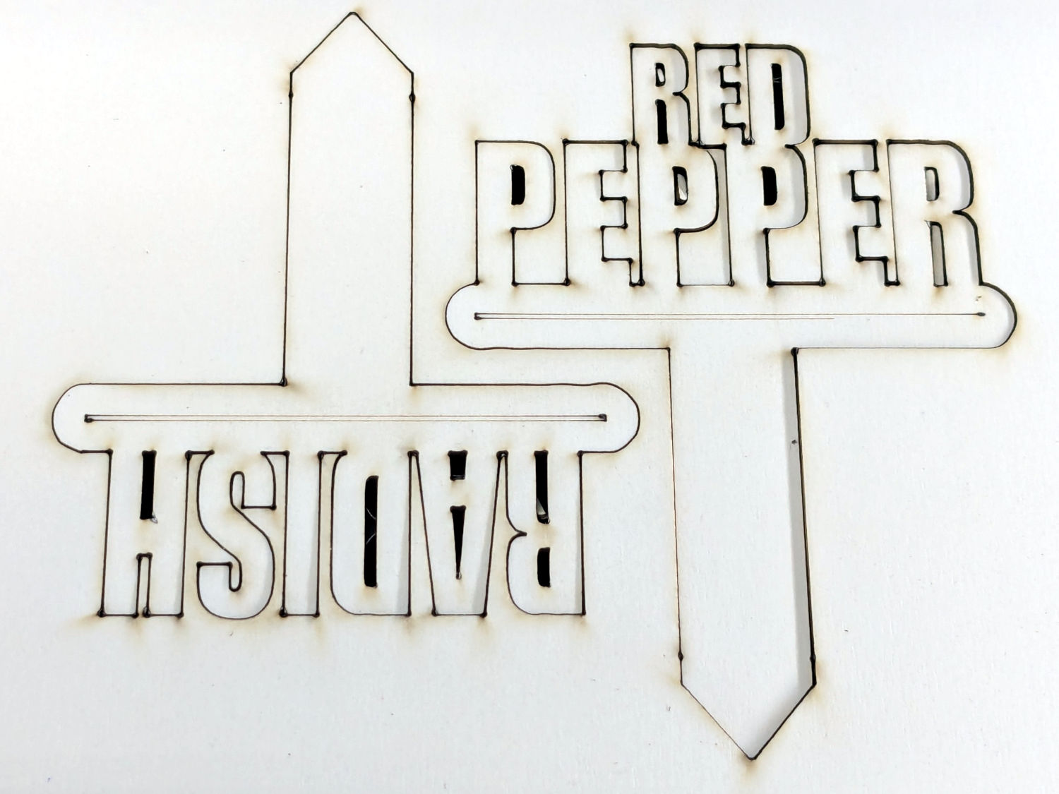

Set the Red layer to mark and the Black layer to cut whatever material you’re using, then Fire The Laser:
