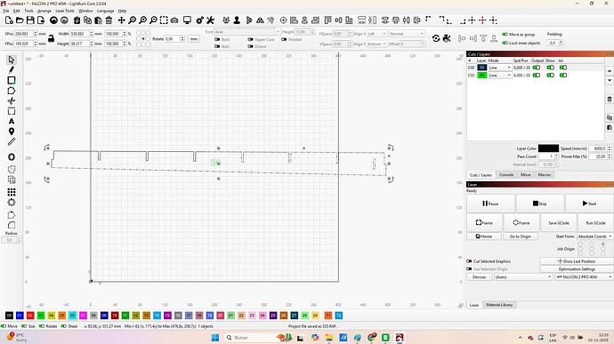

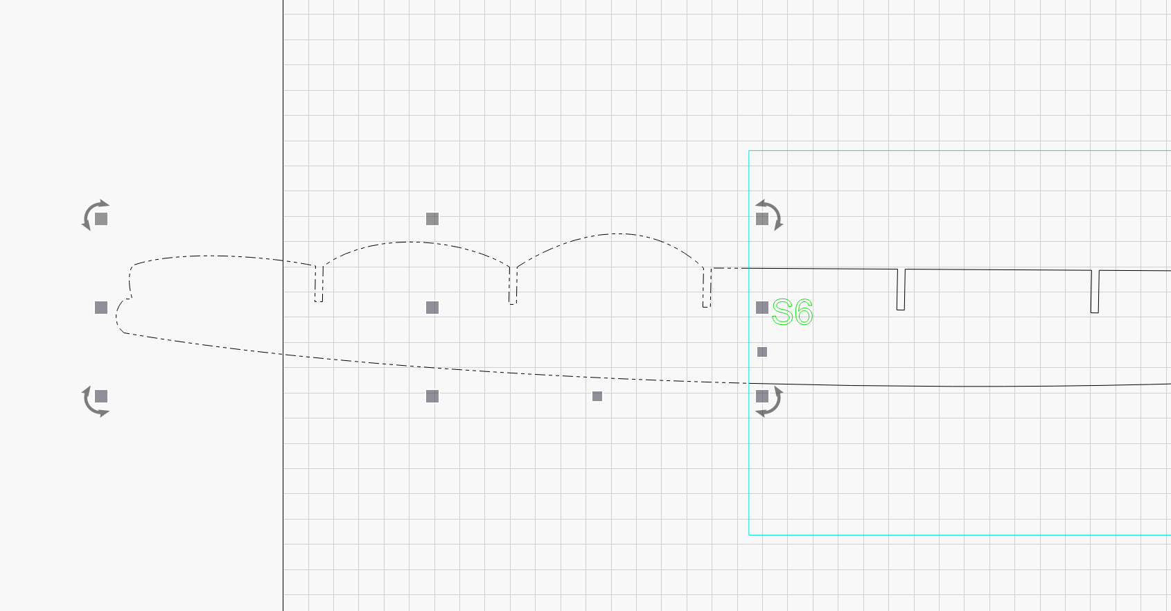

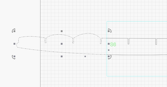

Hello all, i need some expert advise, im trying to do some print and cut and when doing the cut shapes portion some of the lines dont get cut, i cant even cut them using the vertical line, they just behave like a solid part (not grouped), i have attached a portion of the file but almost all the file behaves the same. i also have attached pictures of the before and after the cut so you can see it doesnt cut at all the line. thanks!!!

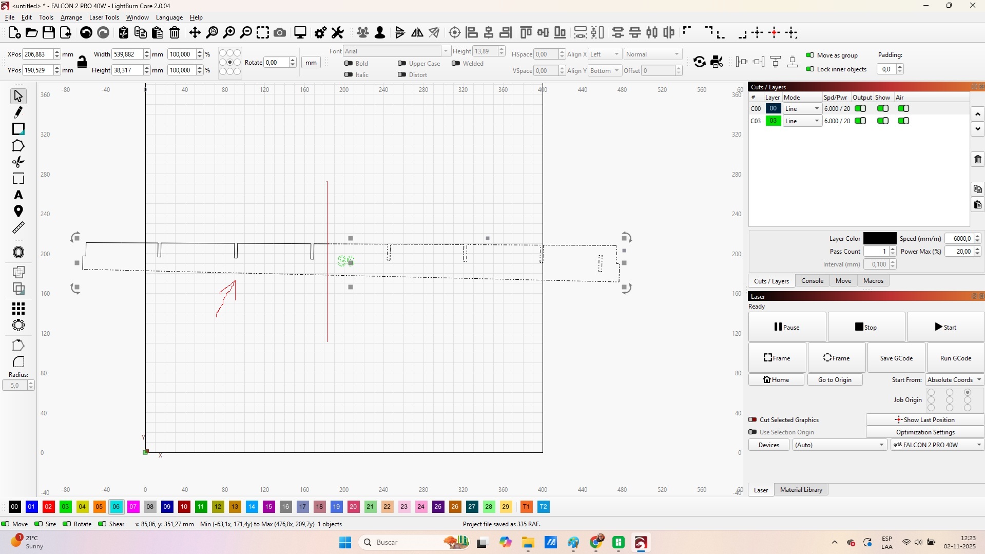

still doesnt solve my issue, i was doing it already that way. Tried with several parts of the project and works ok, but some parts like this one has this issue you can see the cut shapes doesnt cut the big line. tried to attach a video but it doesnt allow mp4 files.
red line is where the cut was made, the part that has an arrow shouldnt be a part of the right portion of the cut, it should be a part of the left portion.

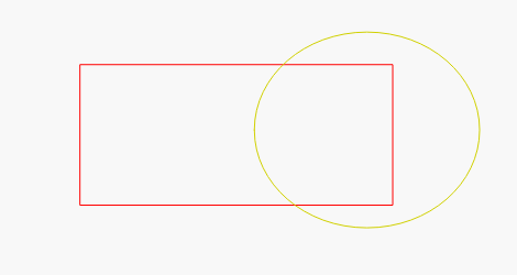

The only thing I can recommend then is that you test the “cut shape” process is working as you expect by drawing a simple rectangle (red) to use as the shape you wish to cut. Then draw a circle as the cut shape (yellow) and use “cut shape”
and be sure you get the following, after the cut shape. If not, then you may not be using the “cut shape” correctly.
yes that works correctly but in the file im working it doesnt cut the lines i showed earlier. in the beginning of this post i uploaded the file its called forum where you can try for yourself what i mean.

Unfortunately, I think there is a small bug in the program. The shape you are trying to “split” is giving LB some problems, “Cut Shapes” also doesn’t work - on this shape.

OK, I used the file you downloaded and noticed that you had curves instead of lines in your shape. So I converted the curves to lines and removed all the extra nodes. The shape is still the same since you did not need any curves. The attached file is the line version. The “cut shape” tool now works on it as expected. So it appears there is a problem with cutting curves in this case.
