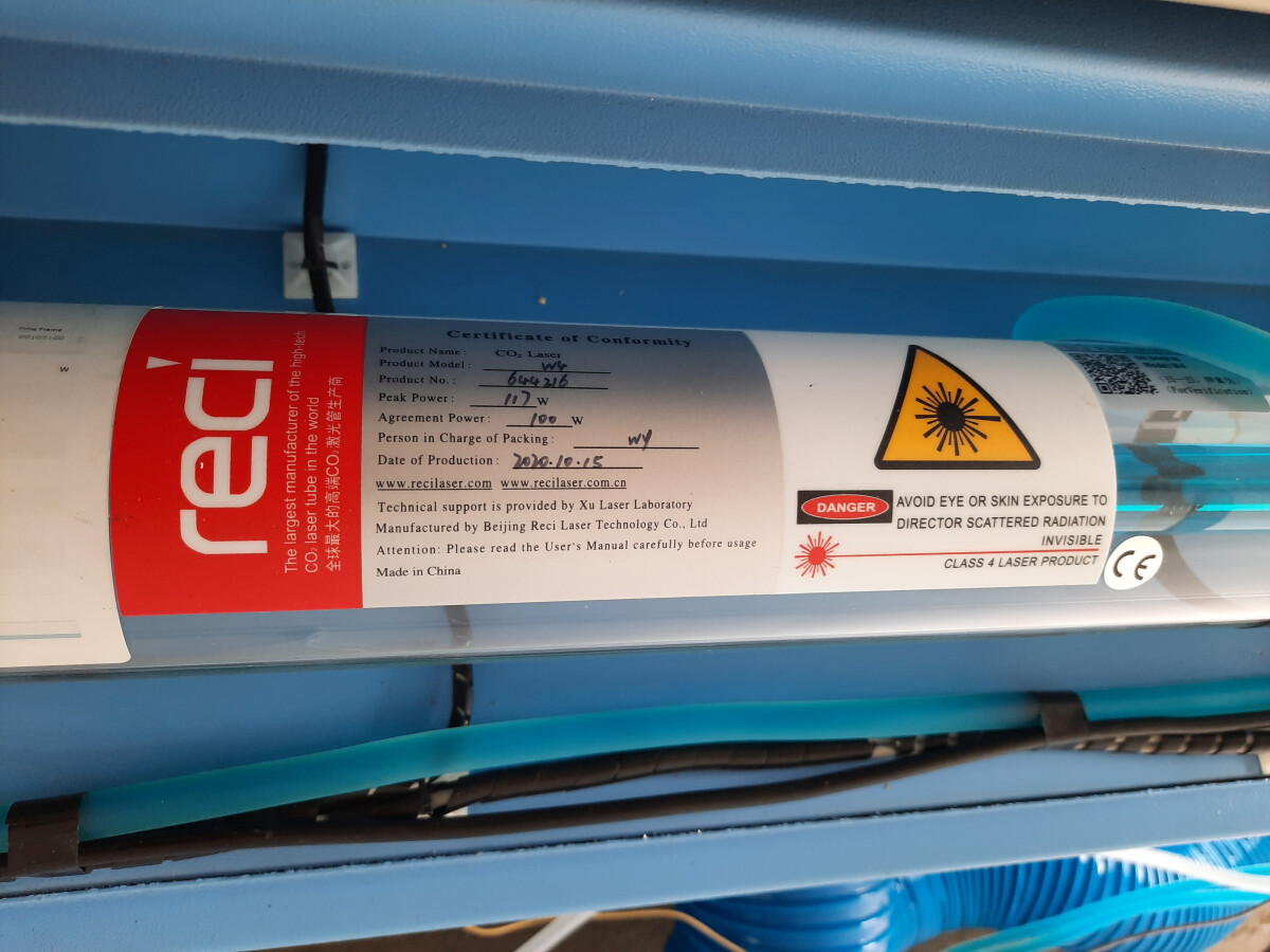

Is it possible your 100w is not 100w?
Do you have an ammeter?
There is something missing here…
Here’s my 100W Laser, Reci W4:
