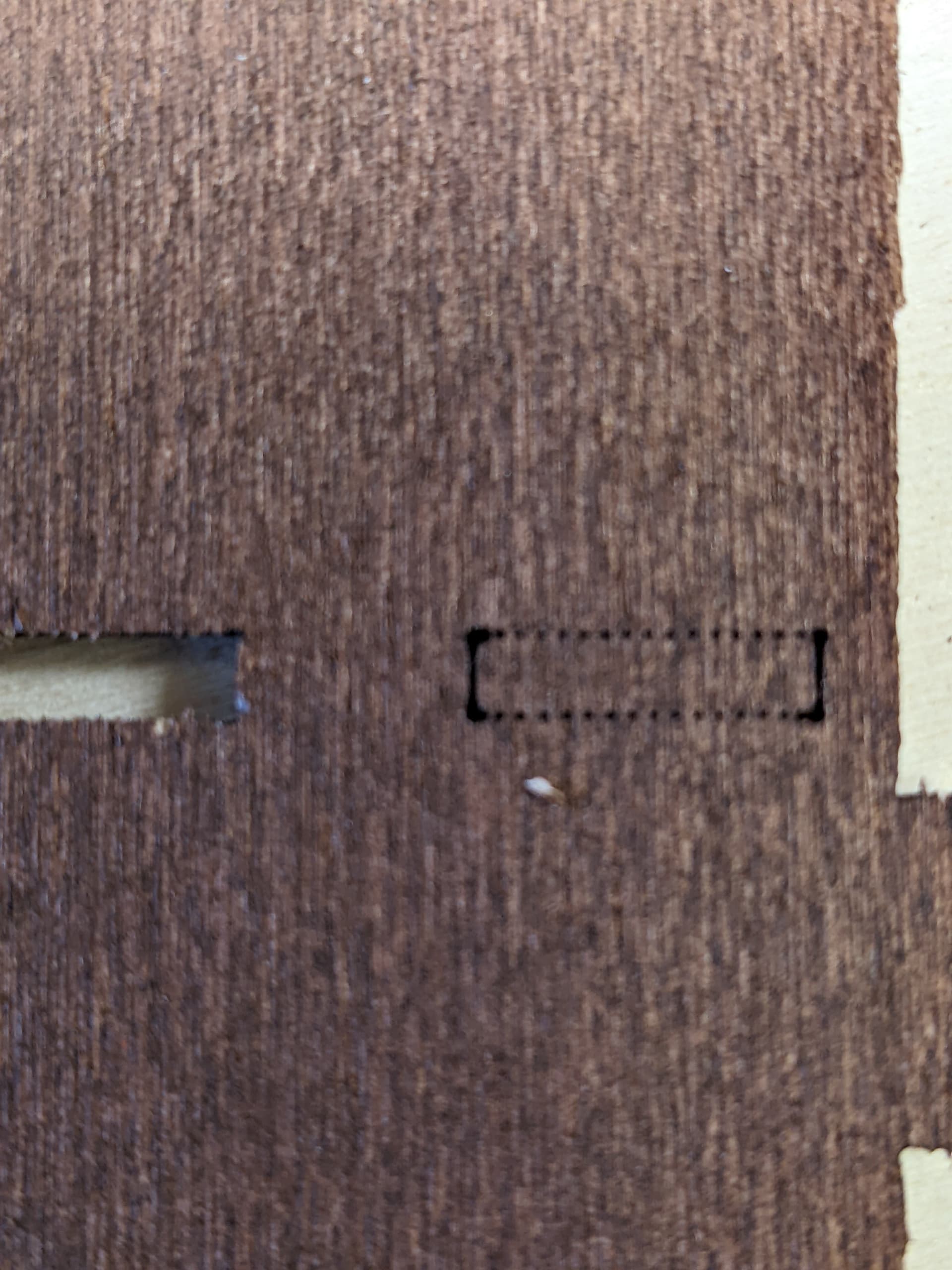

Cuts are perforated?
Hey everyone!
Can I assume this is a belt or motor problem? Perforations and tabs are off.
Looking a your cut it just may be the variations in the grain of the material you are trying to cut. The vertical line seem to be cut through. Try slowing the speed down a little or adding more power and see if that cleans up the vertical cuts. I am sure other will chime in with maybe better ideas. Good luck
It was a loose belt.
