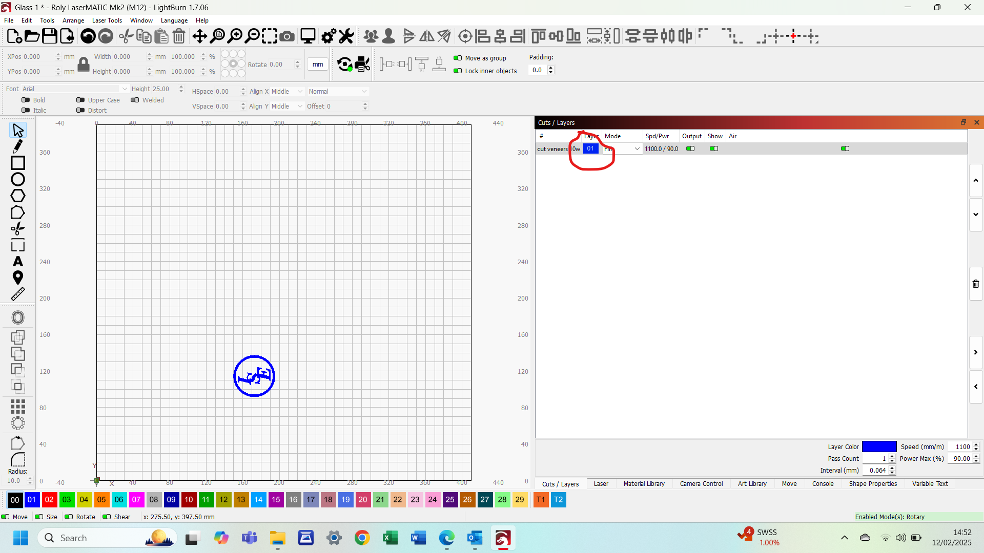

Thanks Jess. No I have not got the layer set to milti the exampel I have attached is a very simple file with just 1 layer. But the problem is on all my files, regardless of now many layers, or how long ago I made the file.
Which Windows system are you using? 7, 8.1, 10, or 11? We need to replicate your issue in order to address it. I’m not seeing a file or screenshot attached for my reference.
I am using Windows 11. I have attached 2 screen shots, I have to click over a 100 times to get the drop down layers screen to allow me to make changes etc.Thanks for your assistance Ian

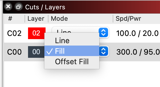

I’m not seeing the drop down layers screen in your screenshot example. For clarification, you are referring to mode drop down box:
and NOT your cut settings editor, which looks like this:
Do I have that correct? I understand that you have been using LightBurn for 3 years. So far, I’m unable to replicate your issue and before we get your support data, I need to confirm which ‘drop down box’ you are referring to.

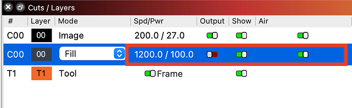

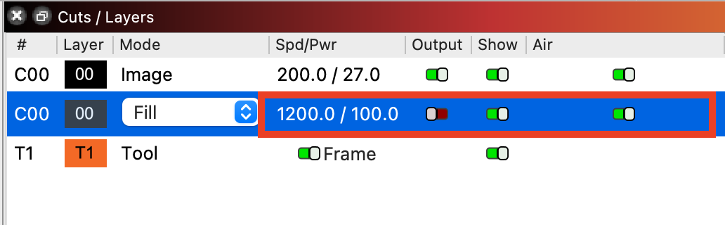

Are you double clicking on the red area I’ve highlighted below?
Jess I have ringed in RED the point that I am double clicking on, as I have said I can be right clicking for over 100 times before the Cut Setting Editor drops down and once I close it, it again takes 100’s of clicks to re-open. Everything else is working as it should ie. left clicking gives me the layer flashing on the workbed, the Mode drop down box to alter line/fill/offset fill all work.
