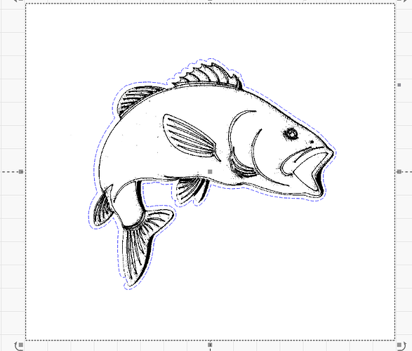

I want to cut this out but I want to laser the detail for painting then cut it out using the laser, is this possible. Going to be cutting it out of thin wood
  1. Trace the outline of the image. There’s a post from today that covers how this can be achieved.
    Easier way to create outline for Cut
  2. Burn the image
  3. Use the trace to cut out the traced outline
fist use Image Trace
Then offset tool
keep only the offset and place that over the original image… you may need to send the image to the back to see the new offset vector on top of your image
Thank you for the step by step, I have kinda figured out how to do this, one problem I noticed is that with the latest version when you use the Offset tool it has a problem working. It causes the software to become unresponsive, so each step I have to wait for it to fix it’s self.
The offset tool tries to apply that to every object in the artwork… it takes time…
You can limit the area that offset examines, such as outer shapes only…
You can use this outline to mask off the areas that may be an issue…

Wow thank you for the help, I think this is way over my head, I just cannot grasp the steps on this, I want to laser the full detail of the fish on output 1 then cut the fish out on output 2. No easy way to do this. I think I will try something else
Yes there is, you are not following us…
Most users engrave then cut the object out as a standard operation.
Put your image on one layer and the cutout on the another… Notice at the bottom of the image is the run time… almost an hour… this was set to 125mm/s or 7500mm/m…

That image is problematic to trace and I did have to clean it up a little and play with the offset settings to get a good boundary. I first used the image trace to make it into a vector… that allowed me to clean it up around the edges. then offset. Just muck about with settings and see what happens. Don’t be afraid to experiment and play. undo is your friend
