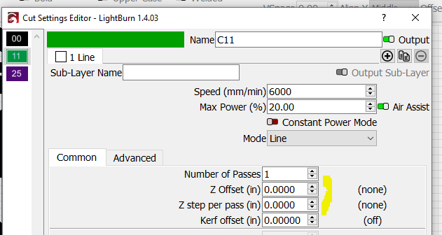

It’s probably asked many times before but I can’t find the answer right away. What is better, cutting with one pass and 100% power or 2 passes with less power?
Sometimes I use more speed with less power to get cleaner cuts but is cutting with less power better for the laser-life?

Thanks, and the option of lowering the Z axis after each pass?
I don’t have a Z control, so I can’t advise you on how to lower it a bit for each pass. I would think it would be in the layer somewhere.
If it takes 100% power to cut through, I’ll reduce to 70% and take multiple passes. Air Assist is key. You need enough air to blow the debris out of the cut.
When I had programmable Z control on a laser, I didn’t find it all that useful for cutting. Probably best to set your focus at halfway through your material.
Don’t own a diode laser but in CO2 if you can’t get thru it in one pass, cutting slower gives me poor results. It tends to char and burn the wood. Not sure about other materials. So multiple passes with a higher power allows it to cut without burning. I would be surprised if a diode laser works different.
Z offset for defocus engraves etc. Z step per pass for cutting.
Yes, I have tested that today, works great btw for thicker materials. Thanks!
Yep, the diode works kind of the same I guess. Going too slow, even with air, gives burnmarks. Regarding the focus, U usually use the auto focus option and so far it works good.

Change z with sub-layers also.
