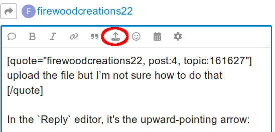

I can try to upload the file but I’m not sure how to do that. I will work on that tonight.
In the Reply editor, it’s the upward-pointing arrow:
Hidden in plain sight! ![]()
Drag-n-drop from the Windows file explorer should work equally well.
