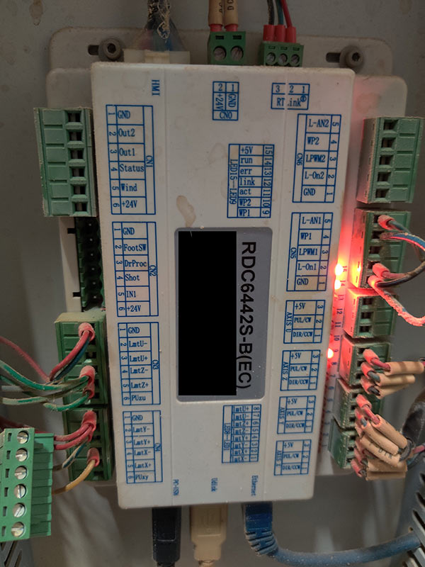

I have a 3 year old Chinese laser that has a rudia RDC6442S-B(EC). The machine stopped in the middle of a job , the screen was off (no display, no backlight) , and the light under the gantry was off. No LED lights were lit on the controller.
I thought the 24v power supply died. I measured the voltage going into the controller and did not get a stable reading (controller was connected at the time) I replaced the power supply, checked it’s output before connecting the controller since it was an adjustable power supply. tuned it to 24.0v.
When I connect the power supply the voltage reading at the ps terminal drops and is not stable. the light under the gantry turns off. (If the controller is disconnected the light works). So I assume there is a short in the controller. (again no LED lights on the controller when it’s connected)
is swapping out the controller with one off ebay straight forward? anything I need to know about programing machine parameters? can I switch to a RDC6445 from the RDC6442S?
Try disconnecting the other other connectors on the controller and see if it powers up? There was another thread that looks to be the stepper drivers being the problem. If not hopefully you have a backup of the original settings.

I did unplug everything and the control panel lit up. I added back connections one by one and the machine did boot up each time. (I did not leave it on for very long before shutting down and adding the next terminal group) eventually had everything plugged back in and it started up but but died / or reset itself after a minute or two.
Currently the machine is running with the CN2 terminal unplugged, and the lightbar off. On my machine this had a single wire connected to CN2-pin6 witch is labeled 24v. I am finishing off the job that was in the machine when it died, just to see if it actually completes.

CN2 does not power the lights. (they worked when controller was unplugged, and also when CN2 is disconnected) Looking at the controller manual CN2 would be for a foot switch or other protection circuit but more pins would need to be populated rather than just the 24V.

I think it may be a short in the drag chain and be possibly unrelated to CN2. unplugging everything form the controller and resetting the machine caused the head to re-home and moved the drag chain and possibly the short.
my X drag chain would contain wires for the autofocus pen (which i don’t use) and the red dot pointer (also don’t use) and air assist tube. the Y portion would add in power for the light under the gantry.
Y chain has stepper motor and X limit switches also. I really doubt it’s in the chain…

Just the process of unplugging everything and adding them back one by one allowed the head to move again. Most likely the short was somewhere where that was movement which brings us to the chain
starting to think we have our short candidate
moving the head over and poking it a bit more
I will have to look up where the focus pen connects to the controller. I believe the red dot just connects directly to the 24v/5v power supply. I am concerned about the quality of the wire insulation in the whole machine. I am fine with loosing the focus pen and red dot. the Y chain does have critical wires, but also much less motion than the x chain. Did not see any fraying from an initial inspection but need to break down the chain to get a clear view.
