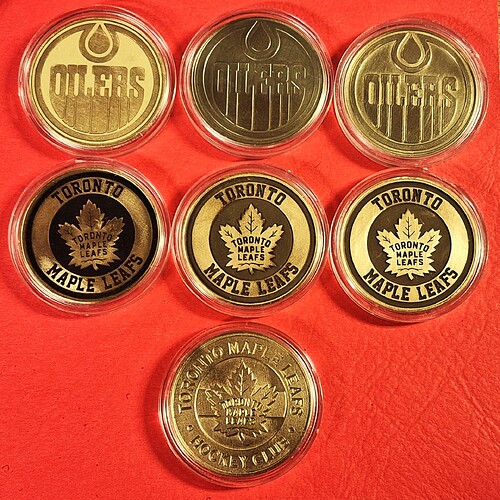

Good Day all. I hope everyone survived Turkey Day. I have a customers logo and would like to engrave coins. I think it would be a decent thing for them to sell in their shop in Florida. Tourist Shop…
I asked CHATGPT to create the depth map which it did. Not even sure if it will work to be honest. Thought it was worth a shot.
Can anyone help an old man figure out what my next step would be?

Run the bitmap generated using 3dslice… Mine take an hour and a half to two hours a side to produce one of these… If you’re looking at making money, I doubt this is the right track.
Yep, your right on the money with that statement Jack. Thought it would be something nice to sell in their shop, but at 1 hour per coin, there is no money in it. I may buy a couple coins off of Amazon, just to get the feel for it though.

It’s fun to mess with and have some coins but these take so long to do a single side I doubt you can do it commercially unless you charge big bucks for each coin.

@jkwilborn …I do personalized images (vectors and raster’s for friends and Family)
Maybee 20 minutes per coin
Those are great, thanks for sharing. What are you using for lenses and settings, if you don’t mind?
Thank you
60 watt MOPA
150 mm lens
38 mm Brass Coins
Image _300/36%/225kHz/20 ns
520 Dpi LB Stucki 3-5 passes
Vectors _1500/80%/60kHz/200ns 10-15 passes
Then 1 BLACK pass_1000/50%/120kHz/100ns at 0.002 mm(12,700 Dpi)
