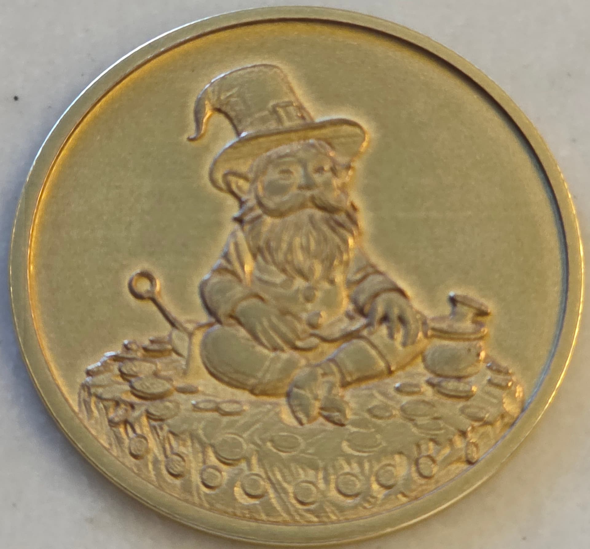

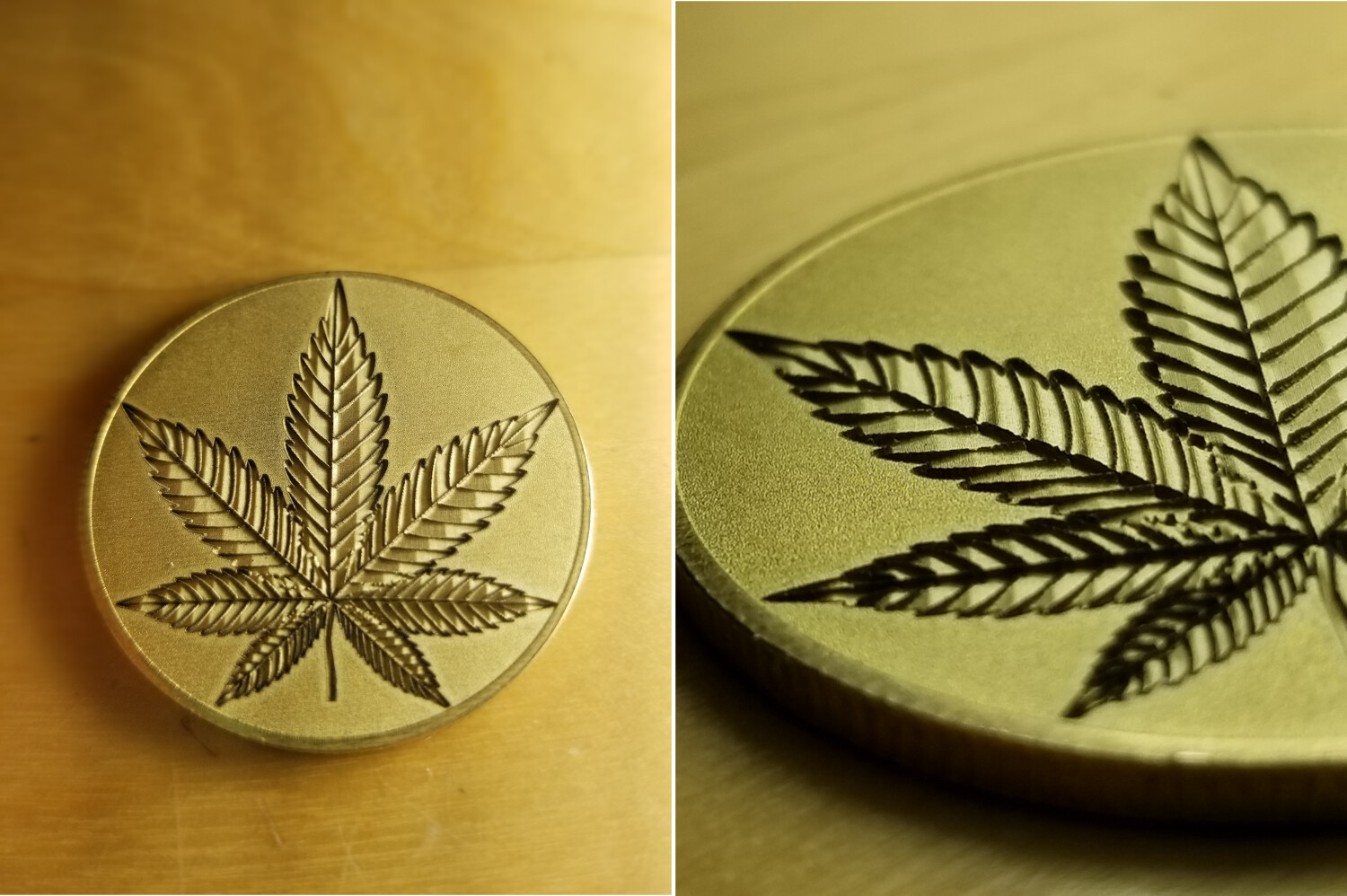

Making Depth Maps and using 3D slice on Brass Coins

Good day, can you share what power machine you have and the settings used to create these awesome coins…
Do you have a MOPA fiber

G2 galvo 20w
My settings are for a 60 watt MOPA 150 mm lens

@redregal Sorry I usually Post
1800/90%/120 Khz/ 100 ns
256 passes
1000 DPI 3D sliced
LightBurn

just curious to know roughly the time it takes to scan a coin with the level of detail shown here.
Is this the math?..
1800mm/s, 0.0254mm scan interval (1000DPI), 78.5% x d^2 (ratio of cir:sq area, d=dia), x 256 scans, answer in seconds
d=38mm (1.5")
38mm / 0.0254mm = SL (# of scan lines one pass)
SL x 38mm x 78.5% = SD (scan lines total distance in circle one pass)
SDmm / 1800mm/s = SS (total scan seconds one pass)
SS x 256 / 60s = minutes to scan all slices
106 minutes to etch the coin ?
Kind of depends on your galvo, some are faster than others.
Most of mine, like this one using 3dslice is around 2 hours on the machine.
40mm brass coin, using a F254mm lens. This one came off the machine like this, but some take a bit of elbow grease to make them presentable.
