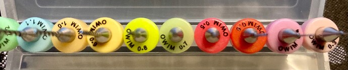

Thanks Peter for your input, but in the end I have found a very simple way to determine the precise spot size of a (my) CO2 laser. As @ednisley writes, I should have bought a microscope or a special magnifying glass, preferably with a scale, but I don’t have one yet.
By shooting for 5 seconds and with a fairly high power, at the top of an acrylic block, I get a “shot hole” that I consider to be precise in diameter.
Those who have tried playing with acrylic and lasers, know that there is a “neck” that starts at about 5-6mm below the surface (after the shot crater) and ends again after 5-7mm, before the balloon effect occurs, I think it can be clearly seen. The small section in between is considered to give a reasonably stable image of the laser beam’s diameter. The material that is evaporated and needs to come out of the hole, due to the temperature, expands the Ø itself a little, …0.5-0.1???
The conclusion: 0.5mm can be carefully pressed into all holes, 0.6mm cannot, with reasonable certainty I can state that my laser beam leaves a hole that is between 0.4 and 0.5 millimeters.
Spot size, measuring in this way, however, says nothing about how fine lines can be achieved. It is primarily dependent on power and speed (and spot size
