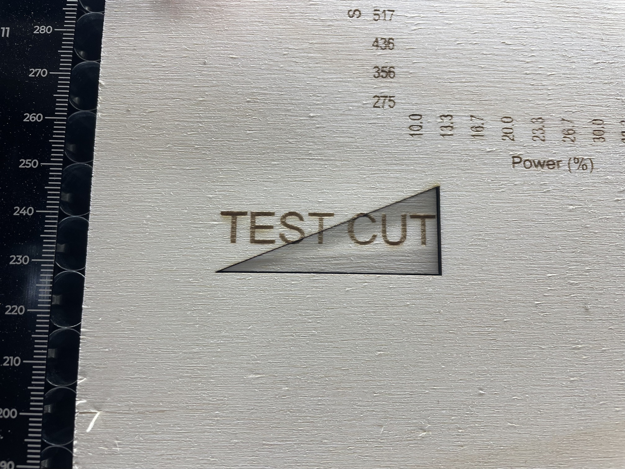

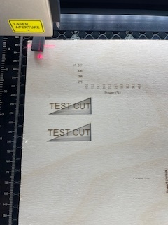

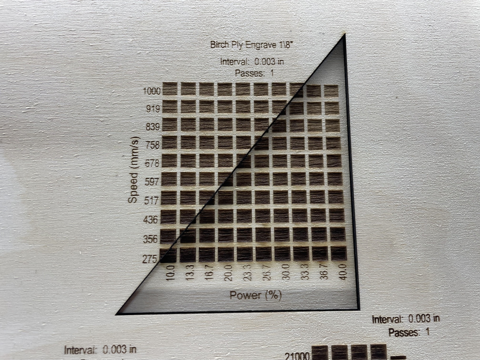

Diagonal cut when should have been rectangle
I am a newbie,
I have been making jigs and when ever there is a rectangle cut after the engraving it will cut a diagonal.
Have tried this with material test grid and others, same outcome.
If I perform a rectangle cut by its self it works fine.
Any suggestions?

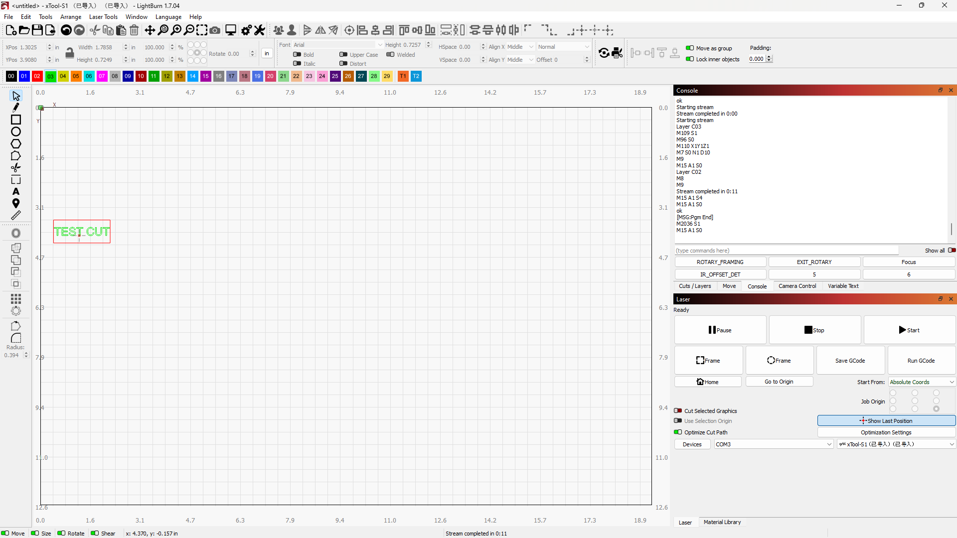

There was a bug with xtool a few versions back. What version of Lightburn are you using?
1.7.04
The previous bug made each of the grid squares a rectangle. Need someone more versed than me to help.

@Plumblaser
Follow the installation guide here:Setting up xTool S1 with new xTool device type in LB 1.7 Beta
I tried all the changes and still get these results
I replaced my 1.704 with the 1.7 which fixed the diagonal cut, but know I am having issues with my power a speed settings. They seem to be very inconsistent.

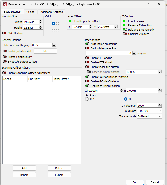

Check your S-value max settings. $30 should match the S-value in your device settings. GRBL: Low or No Power Output - LightBurn Documentation
mm/m is best for diode. if you need to go back and forth try a units converter.
