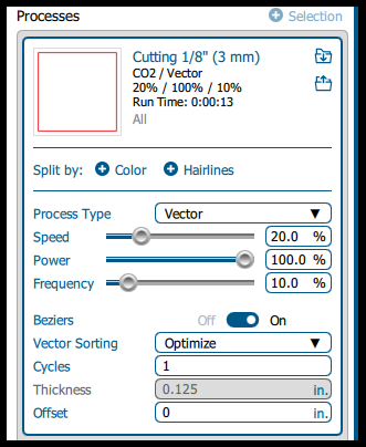

You set those values in the Epilog Dashboard software. But, Epilog has default choices for certain materials and thicknesses. A good place to start for 1/8" wood is below:
Having said all of this, if you want an easy way to determine the kerf or the beam thickness on this specific laser for your 1/8" basswood plywood, create a 1" x 1" square, and use the default settings above.
Assuming you get a clean cut without charring, take a caliper and measure the square. Assuming it measures 0.990" x 0.990", the beam width or kerf is 0.010". If you want the finished size of the square to be 1", you would offset each edge by 1/2 the beam width, or 0.005" per edge. The square would now be designed at 1.010" x 1.010"

Thanks so much RalphU for that picture and settings. So I should first set it on 20% speed, 100% power and 10% frequency and see what happens. I’m curious how frequency would effect the cut. I understand about speed and power already, but not frequency, if anyone could please explain?
Also, how would you begin adjusting those values depending on what happens as it’s cutting?
The frequency is related to the number of pulses per inch. You can vary it, but Epilog has some basic defaults for material thickness. You can increase the percentage frequency, but I would tend to use a number similar to what Epilog defaults to.
Regarding speed and power, you want to be able to get a clean cut with no scorching. It is ok to run an Epilog at 100% power, and you then just vary the speed to get it to cut thru. If you aren’t in a hurry, you can cut 2 passes with more speed and less power. You have to decide what works best for your material.
