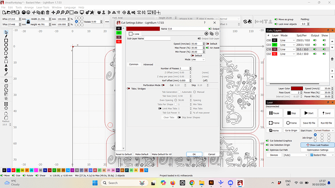

Can you please post a screenshot of layer settings?
This is the layer that was most offensive lol. Although the engraving layer also messed up quite a lot. Let me know if you need anything else screenshotting :slight_smile:
So,… you are using mm/min as unit speed. This is not convencional for common diode lasers like mine, so I think you are using other kind of laser machine. Can you tell us what laser machine are you using?

It’s an OMTech 60W CO2 laser…
