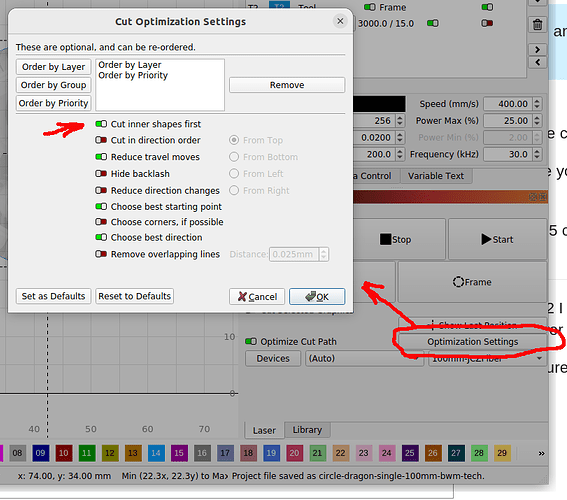

Layers 4 + 5 could probably be merged, use optimizing to set Lightburn to cut inner shapes first.
Always check out what it’s going to do in the preview… before you run the job.

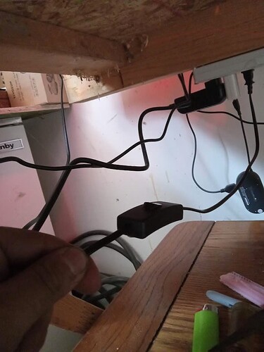

i own this unit (xtool D1 pro) and it sure does have an in-line on off switch (rocker style)
currently the only way to control air assist on these models.
That kind of switch is easy … you’ll have to have something toggle on the controllers hardware to make it work from software…
No different than in the video, you have plug it in…
could you clarify what you mean. maybe explain or direct me on how i could do this?
