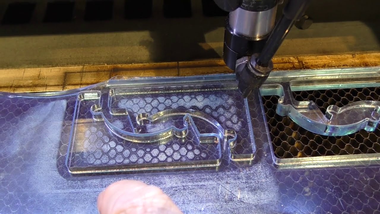

It really doesn’t work like you think it works…
It seems like the ventilation would be good but it’s not… not to mention all fires I’ve heard of go back to the honeycomb bed.
I know you’re is a dpssl laser, but the same idea applies, as to the material also.
Here is a 3 minute video acrylic cutting with a honeycomb bed…
Here is a more detailed video… if you’re interested. You can see it from the top in this video if you to about 2:30 into the video, it’s pretty clear how bad honeycomb really is… The whole thing is actually a good video…

I removed the honeycomb within a day and the steel place cut me a replacement rolled steel plate that is now the bottom of my machine… It has holes in it for alignment jigs…
When I cut, it condenses on the metal plate and the airflow goes out the back… I can use a little solvent and wipe it clean… not so with the honeycomb. It was also aluminum, so magnets were no help.
