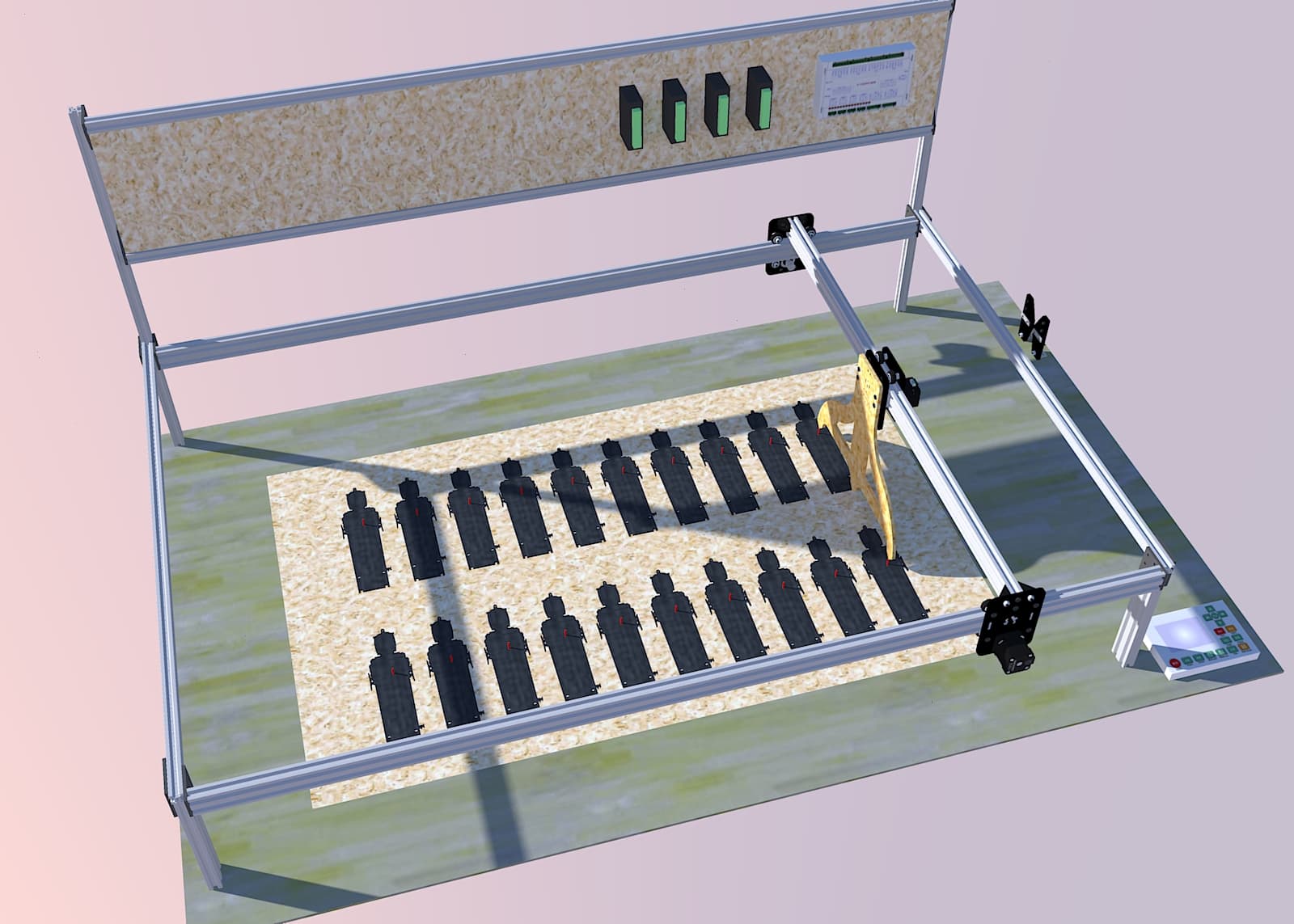

I am looking for advice/discussion for retrofitting a cheap CNC style machine into one that will deposit precise amounts of CA glue (superglue) onto wood parts via a peristaltic stepper pump. for anyone unfamiliar with these, the fluid is pumped through a cheap and easily replaceable silicone tube with paddles that squeezes the tube to move the fluid. if you drive the pump with a stepper motor, you can achieve decent control of the amount of liquid you dispense. I know this to be true because they are used in pharmaceutical applications and what’s good enough for them will be overkill for me. i am not sure how the viscosity of the glues will change things, but I am confident this can be done and decent consistency can be achieved.
i have to imagine others on this forum would be interested in such a device if they glue wood parts together repeatedly for products they sell, so using lightburn and ruida to control this should be a nice seamless workflow experience for anyone using lightburn.
all of the wood parts that i (we) need to drop glue onto are already in lightburn, so creating tracks to drop glue and being able to adjust the amount of glue that is dropped around the piece (and adjust to perfection) within lightburn itself seems to make sense. we will likely also create jigs for this gluing machine within lightburn too.

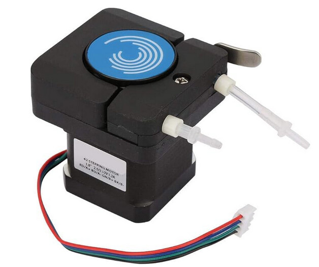

the basic idea is to take a cheap 5 watt engraver (or CNC) and retrofit a peristaltic stepper pump onto the gantry as the head. I would add a ruida controller for the purposes of using lightburn to send the jobs over ethernet, since I do this with 3 laser cutters now. the PWM laser output would simply control the speed of the pump. z axis is optional but it may be good to have.
i could also use a CNC, but the cost of the milling motor and larger steppers might be a waste, or maybe the cost difference is negligible the bigger steppers are worth it for speed and reliability.
I am quite certain it will work, and I see cheap engravers for $250 on amazon. if the ruida will run somewhere near $300, i think it’s safe to say this can be done under $1000.
my first thoughts on choosing a donor device or kit, is that a homing ability is a must, and limit switches would be very welcome. i think we want the steppers included with the starting point, but we also need to know the specs of the movement to enter into the ruida controller, right?

This may be a good paper for you to review: https://www.instructables.com/Control-peristaltic-pump-with-TA7291P-and-an-Ardui/
If you want to keep the costs low, use a grbl controller board, not a ruida. A grbl board ($30) will do the same, there is no difference in control / possibilities in the end.
I could imagine using the z-axis control to dispense the glue, not using the PWM signal. The PWM signal will vary in duration depending on the shape, whereas the z-step is a single command at a defined step amount that is only sent once while the operation is ongoing. So you get a more defined output. Using the PWM signal, you would need a very exact calculation of the length of the shape combined with the “power” to be used.

I pulled the trigger on an openbuilds acro 60x40", or 1500x1000mm.
I also got the ruida, steppers with driver boards on the back for movement, and 4 of the stepper pumps.
The silicone tube was cheap, i got 5 meters each of 3 different inner diameter. 1mm, 1.5mm and 2mm as a starting point for exploration.

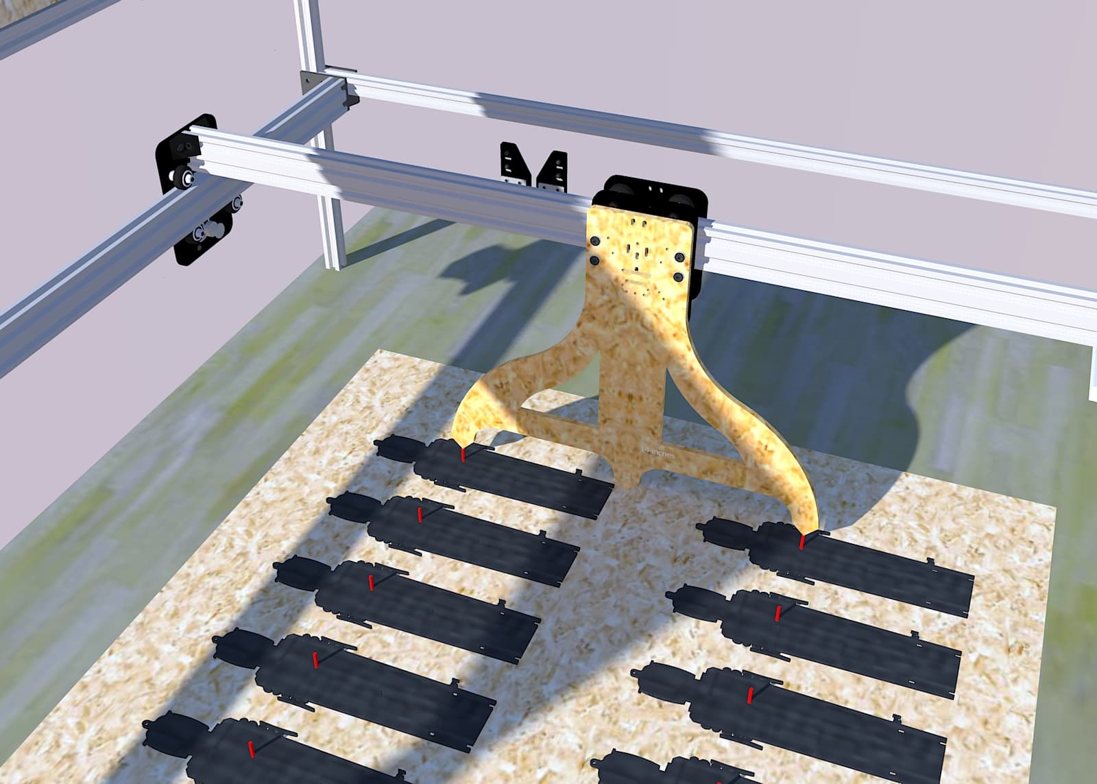

There will be some trial and error with the proper height to dispense above the material, and possibly some challenges with surface tension once the glue leaves the tube, which could effect the timing. (The glue will not shoot out at laser speed)
I realized speed may be slower than i want out of the gate, so if this works, i will immediately create a double head with 2 pumps to dispense on 2 pieces at the same time, which was part of my decision for the 60x40 with the gantry spanning the shorter axis. I realize it could be a triple head if the gantry was along the other axis, but i like the idea of removing some completed units mid job. Jig trays that slide out of the front of the machine would really be awesome if they could be hot swapped.
i ordered some extra extrusions and brackets. the plan is to enable the 5v analog laser output on the ruida and read this with an arduino, which will translate that into step pulses to control the drivers for the stepper pumps.
the current theory is that I will be able to generate glue paths and pump speeds directly in lightburn by changing the laser output percentage, with no other programming. the same lightburn file will be used to laser cut a jig prior to the glue job on this machine.

Since I really liked the idea, I did some further research. I found this pump at Amazon:
That I might buy just to check how it works out. As I mentioned in the beginning, I would directly connect this one to the z-axis and just need to calibrate how many steps lead to one drop of fluid. I can imagine that this pump doesn’t work well with glue, but just for fun, I’d like to try it :slight_smile:
In my opinion, the advantage is that I don’t need to change anything hardware-wise.
