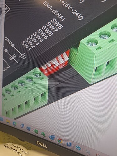

Thank you because I donât have a stepper motor separate to my laser, it is built into the PC type box that came connected. I was just messing around with the steps per rotation until i found on that was able to go around the cup. I donât know if my understanding of it is clear though because it ended us stretvhing out the logo which made me compensate for the stretvh with more width, which i assume you donât do. So how exactly does steps per rotation work? Do i need to increase the frequency when i increase the steps per rotation? Do my steps per rotation need to correlate to the circumference of the cup i am engraving? if so, is there a formula that i can use to determine what the SPR should be in correlation to my cup circumference?

Inside the case there is a microstep driver like the one pictured.
Might be a different color.
Look on the table and read the DIP switches, example on off off on is 12800 steps per 360.
Itâs the same on both a fiber and a co2.
On one of the very first photos, looks like a direct drive chuck, so ratio is easy.
Im guessing microstep driver is set for 12800 or 20000 based on his results he posted.
